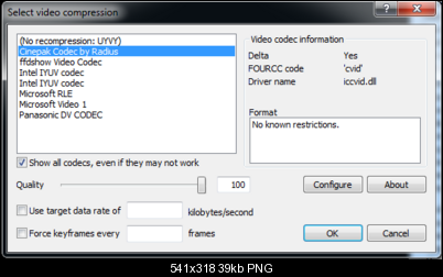

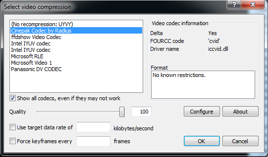

  4. 1. Have you being playing around with the capture settings ? You can set a custom AR
    In set custom format, it is set to 720x480 UYVY, but it's still stretched out.
    2. Vdub defaults to uncompressed. So you must set the compression from the video menu (in capture mode). Lagarith or Huffyuv (depends what you have installed) are good choices. Still quite big files but not as big as uncompressed.
    I don't see those on there. This is what I see: Click image for larger version

  5. Okay, I just installed Lagarith.

  6. Member DB83's Avatar
    Jul 2007
    You have to install the codec for it to appear in the list. Install Lagarith since there are several versions of huffyuv.
