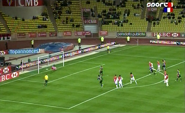

    I'd like to know what the best way is to deinterlace THIS source video?
    For a long time, I used Virtualdubmod's built-in "deinterlace/blend fields together" option, but recently realized that Yadif can provide a much sharper outcome (see examples
    VirtualDubMod/deinterlace:
    with Yadif:
    However, you might also see the bad side of Yadif: it leaves some noise (this might not be right word for it), which can be annoying in videos (mainly in the background in close-ups).
    So, is there a way to remove that "noise" from Yadif-deinterlaced clips? E.g. some filters / settings in Virtualdub ?
    Or should I stick with the original VdubMod deinterlacing?

    If that sample video above wasn't enough to convince you:
    Note the "dots" in the field line markings. They alternate and "buzz" like marching ants on susbeqent frames. The advertisements in the billboards have artifacts. TGMC also blurs a bit to get rid of intertwine twitter, so it has the "side effect" of denoising which may be beneficial on noisy footage
    Yadif
    Yadifmod+NNEDI2
    TempGaussMC_Beta1
