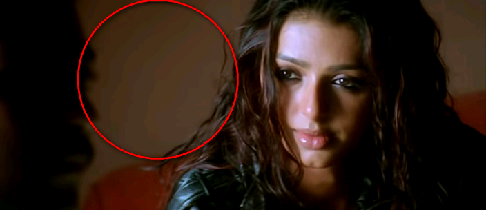

    The area within the circle is my problem. That area seems odd.

  5. The artifacts in the circle are posterization artifacts. Usually from over denoising. Denoising ruins the natural noise and dither
    And how did you take the screenshot ? What software/method ? Sometimes this type of artifact can be due to improper viewing method

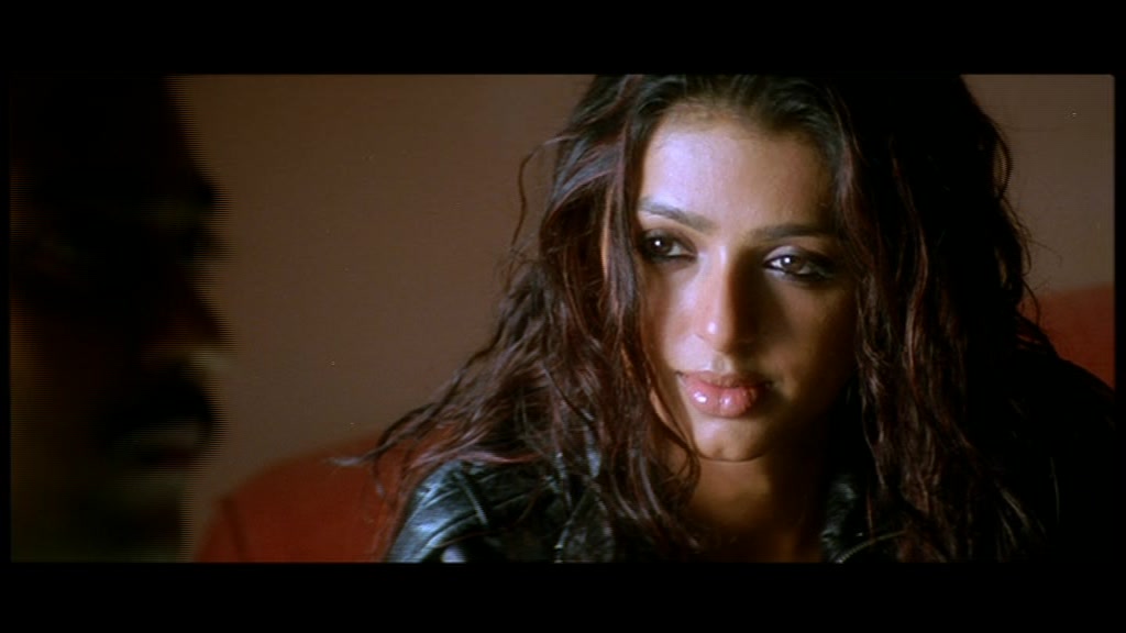

    Why did you post a different frame of the source ? Logically, you should post one of the same frame ,or a video sample would be even better (from the same source, not from other video ). And what does the script preview post filters , yet pre encoding look like ?

    Why did you post a different frame of the source ? Logically, you should post one of the same frame.
    Source
    Approximately same frame

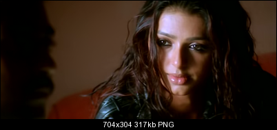

    @Evad3R, strange.... But your sample is fine with me.
Name:	Sillunu Oru Kadhal [2006-DVDRip-x265-AC3-ESub-Team ExDR](02h16m00s-02h20m00s)-002.mkv_snapshot_0.png
    It is possible that the player is not properly input/outputs HEVC files. Try through MadVR.
