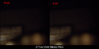

    The banding in the shots you posted were caused by the increase in contrast between the original and the copies. Ten bit could have decreased that I suppose but it wouldn't have been needed if the original contrast had been maintained.
    I had to look carefully to see any banding. The main area I saw it in was the flare which had a big increase in range between dark and light. The thing about 10 bit on PCs is that no one has a ten monitor or a ten bit OS. On a PC the 10 bits are going to be constrained to 8 bits in the final result no matter what you do. Increasing the contrast is going to cause banding.

  2. 10bit means HIGHER INTERNAL PRECISION WHICH ELIMINATES BANDING even if output is 8bit !!!

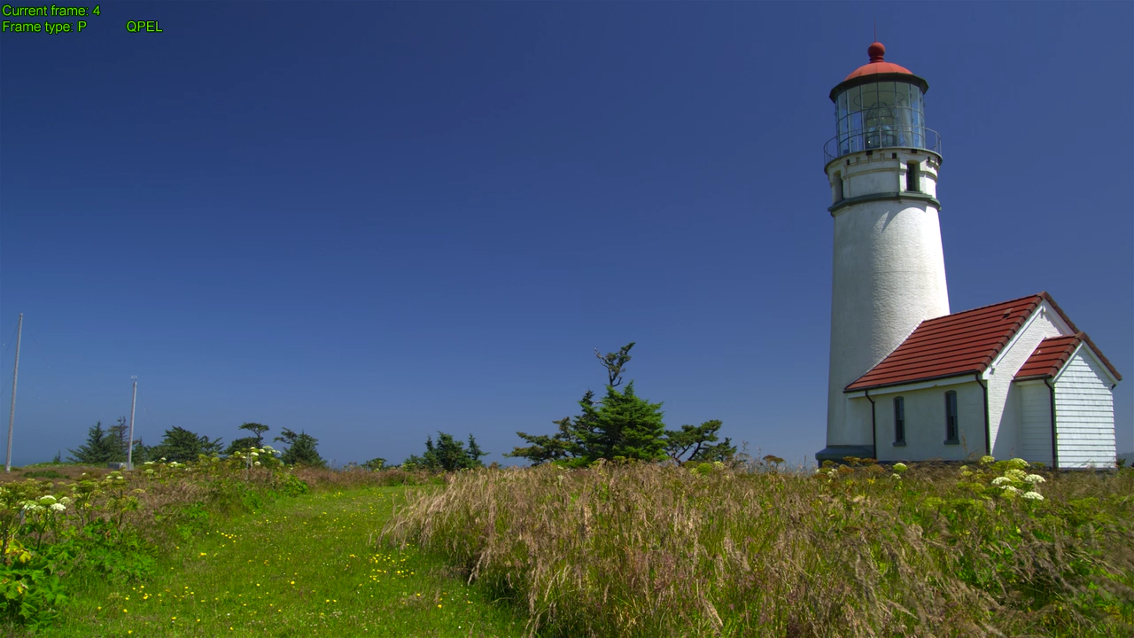

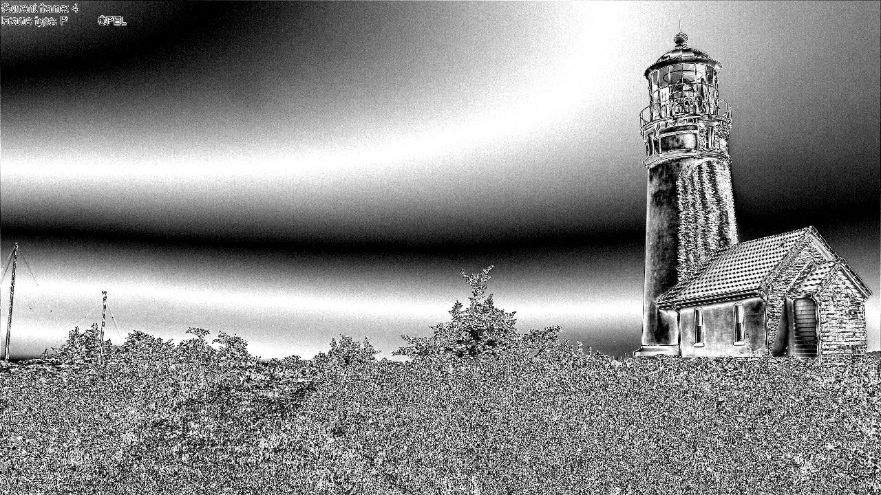

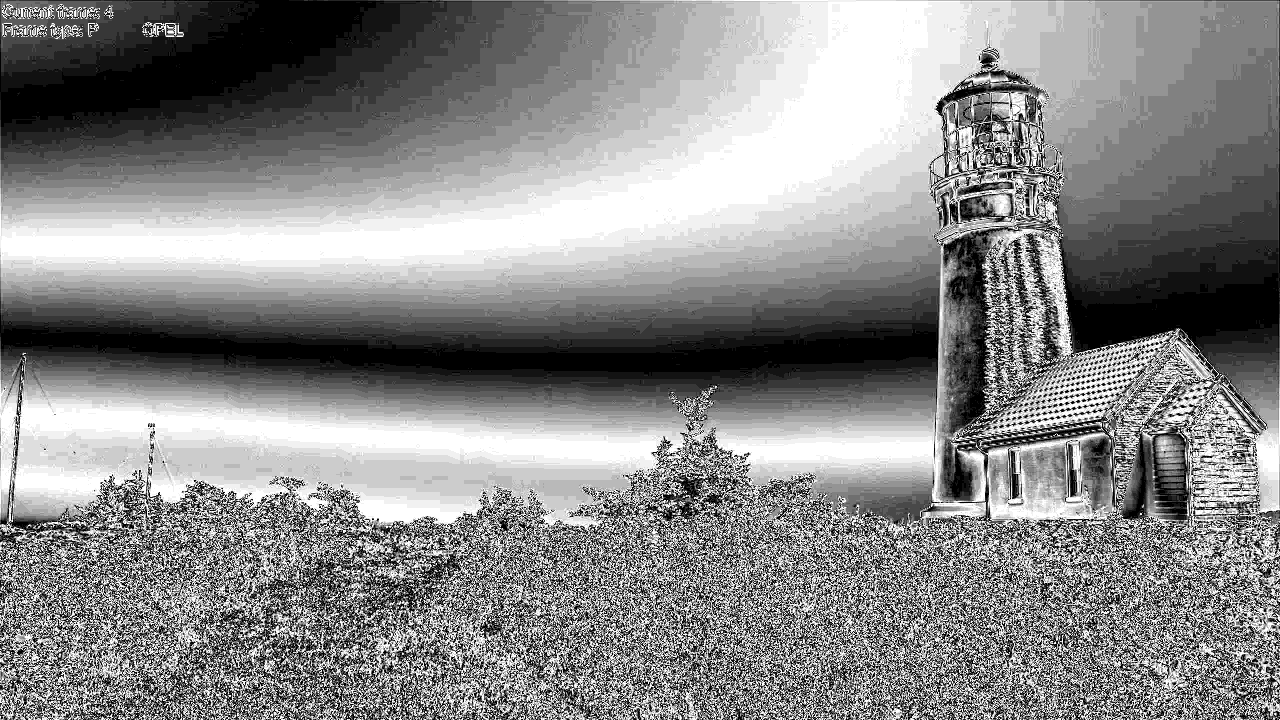

  5. As mentioned earlier, 10bit x264 and decoders are widely available now , and there are hundreds of posted tests demonstrating the benefits, and benefits are not limited to gradient banding. It's hard to quantify, because it varies on content, but I've been seeing anywhere from 5-20% difference on typical content (in terms of SSIM or PSNR values)
    The negatives - it's still slower than 8bit, even with the new optimizations in recent patches, and poor hardware support (strictly limited to PC playback currently). Also , I find 10bit x264 2pass rate control b0rked currently. It's way off
    For banding - AQ helps (I've posted several comparisons on varying AQ before, and the effect compared to other h264 encoders ), as does lowering deadzones, increasing psy , or post processing filters like dithering or adding grain. But most of these will end up requiring more bitrate to achieve the desired effect.
    It's important to compare at equivalent bitrates. So either 2pass tests, or do multiple encodes are varying CRF until you get equivalent bitrates.
    If Atak's example was difficult to compare the differences - these were 1280x720p25 5Mbps encodes from uncompressed 8-bit 4:2:0 source. It illustrates typical gradient banding more clearly, included is an exagerrated luma view done with histogram("luma") . Dithering can get you similar results as the 10bit encode - but it would require much higher bitrates (dithering is essentially noise, and hard to compress, even ordered dithering)

  6. Member Ethlred's Avatar
    Feb 2008
    I can just barely manage to see a difference between the two in IrfanViewer. I have to look at the area where the blue sky is turning gray near the trees on the left side and NOT look directly at it. Might be easier to see on an LCD. I still have a CRT.
    Seems to be a very good example in that there the same contrast in both.
    I might try playing with it a bit but since AQ mode was added I have not had a visible banding problem. Prior to that it often irked me and mostly I was still using XVid to avoid the problem. I started with the beta versions of AQ and switched to X264 for everything at that point. I don't see a real need for it even with DVD conversions, where the source is 10bit. If I can get the same results as I do now without the dithering and get a lower bitrate it might be worth it.
    Catch is it can only play on a PC which is an 8bit system and the only LED screens, for a remotely reasonable price, that aren't 8bit are 6bit. I have my doubts that it is worth the loss of compatibility.
