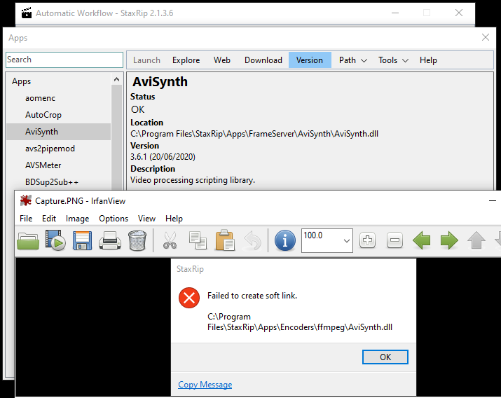

    Hey @stax, seems not to work for me.
    [Attachment 53954 - Click to enlarge]
    But the vaporsynth thingy still works good, so no need to do anything.

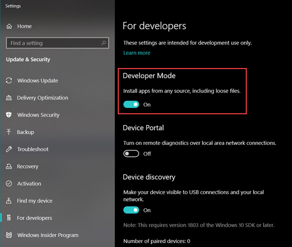

    You need to enable Developer Mode in Windows Settings in order to avoid the soft link creation failure issue when you don't have an installed AviSynth+ on your system.
    If it's not enabled, you need admin privileges in creating soft links.
    In that case, you will see errors when you launch StaxRip in the user mode.

    Thank you, didn't know that.
