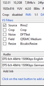

    Hi Guys. I have a problem with QTGMC. For SD recordings, it is working fine. But with HD recordings (pal) the targetfile is jerky. This is now for years like that, I don't know why. Any help is appreciated.
    Aug 2013
    Central Germany
    Don't blame StaxRip. Deserves a separate thread. And a lot more details.

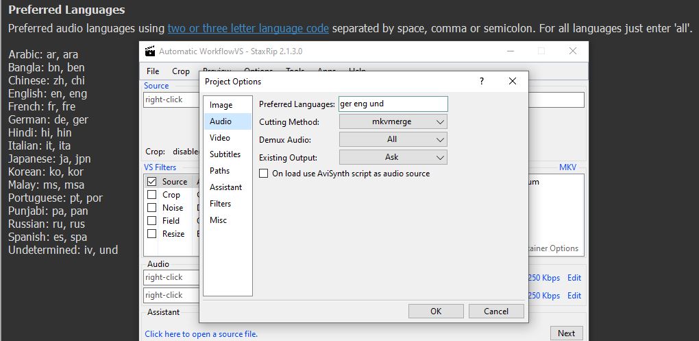

    Lately (2.1.3.0) I had a problem with one DTS track. Encoding it with the Opus-preset made a horrible sounding track, tried it three times. Encoding it with the AAC-preset worked fine.
  25. Member
    Apr 2020
    espaņa
    hello good thanks for the new stable version as I change the preferences of the audios in previous versions I always left the Spanish first but in this new one it comes out by default first English and I don't see where I can change that
    thanks greetings
  26. Member Bob.Dig's Avatar
    May 2020
    Berlin
    Have you tried this and saved as a template (autostart)?
    [Attachment 53845 - Click to enlarge]
  27. Member
    Apr 2020
    espaņa
    yes spa eng und
    but it does not change so I had it in the previous version but in this new one it remains English as the main thanks for answering greetings
  28. Member Bob.Dig's Avatar
    May 2020
    Berlin
    You are right, it is the same here, always English the first track, even after I had removed "eng" completely.
    [Attachment 53863 - Click to enlarge]
  29. Member stax76's Avatar
    Nov 2009
    On thin ice
    Preferred Languages in the options dialog is what automatically gets demuxed.
    What language will be detected and used is defined in the Language field of the audio dialog.
  30. Member Bob.Dig's Avatar
    May 2020
    Berlin
    I am blind. Where to find this dialog?
