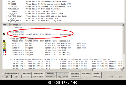

  5. Don't change anything in VIDEO_TS.IFO
    In VTS_01_0.IFO don't change the menu entry (in red)

    The only thing is, the DVD-Rs my recorder produces have these two folders in them-
    VIDEO_RM
    VIDEO_TS
    No VIDEO_RM folder appears on the linked page. That may contain the .ifo file that wouldn't let me change it with IFOedit anyway, so maybe it makes no difference?
    As for the VIDEO_TS folder, the files I should NOT change (the menu files) are these?
    VIDEO_TS.IFO
    VIDEO_TS.VOB
    Is that correct? But the VTS files are the ones that should be changed, both .IFO and .VOB?
    Thanks for your help.
  7. Forget the VIDEO_RM folder, think of that one as only for internal use by the recorder. Typically, recorders use VIDEO_TS.??? for the menu. The IFO contains the navigation info and the VOB has the actual menu (video and audio). In theory you could leave it at that, but it's possible that a recorder could save a track menu in VTS_01_0.VOB, so it's best to leave the menu info alone in VTS_01_0.IFO.
    I've never had to mod the VOB, but as Scott pointed out, you might have to hack it too.
