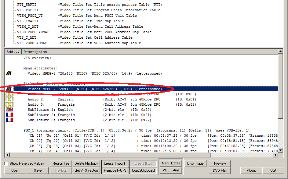

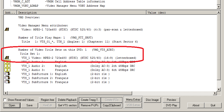

    You can also use PgcEdit to patch the IFOs – it changes the flag in both places (VIDEO_TS.IFO and VTS_xx_0.IFO) so it's less tedious than using IfoEdit.

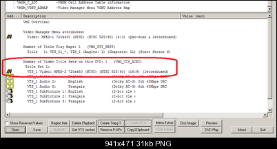

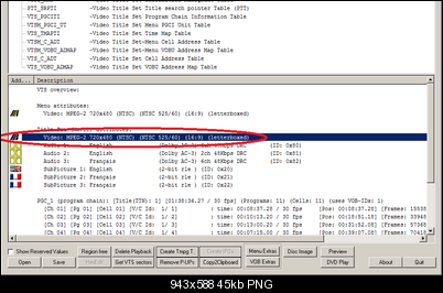

  10. PGCedit is pretty powerful and can be daunting at first. For a simple task like yours IFOedit is much easier. Just click the open button find the VTS IFO file that matches the VOB, you'll see this screen
    Double click the Video line in the lower pane, change the AR to 4:3 and check the automatic pan&scan radio button, click Ok, then hit the save button and say yes to update the BUP file. Repeat for other VTS', when you're all done open the VIDEO_TS IFO and do the same for all the VTS listings that you changed, save and that's it.

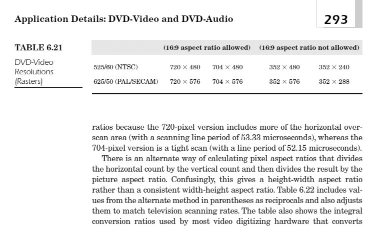

  14. Member Cornucopia's Avatar
    @usually_quiet, you should amend that to read 720x480(576) AND 704x480(576), as the 704width is just as valid for both 4:3 and 16:9 material (this is twice I've mentioned this today for some reason!).
    Your other part is correct: the 1/2D1 and CIF sizes are ONLY 4:3DAR, and I don't know of ANY app or device that allows otherwise.
    I didn't just pull the requirements for 16:9 out of my hat. The "What Is DVD" page here at VideoHelp says "16:9 Anamorphic (only supported by 720x480) " under NTSC and "16:9 Anamorphic (only supported by 720x576)" under PAL. So if you are right, my post is not the only thing around here that needs to be corrected.
    That being said, my players support 704x480 at 16:9, but I'm pretty sure I patched the aspect ratio manually. It has been a while since I tried authoring anamorphic 704x480 video to DVD, but I seem to recall 704x480 video at 16:9 aspect ratio being rejected by what I was using at the time for authoring DVDs. I'll have to check my authoring software again later to see what it does.
    I'm getting my info from the DVD Demystified textbook (Jim Taylor, Andy Parsons) and from...ahem!...DVDspec document. Plus, SpruceDVD Maestro & Sonic Scenarist encoding & manuals. Don't know how much better you can get than that unless you were to have the $50k+ package of NDA documents.
    Yes, this site, and Wikipedia, and a few other sites have a few things wrong with them. Don't get me started on what needs to be fixed WRT stereo3D on Wikipedia!
    After a few bothersome rounds with pandy, I now make sure I get my references straight from the horse's (aka mftr's/specs') mouth (though that still won't satisfy some people).
    ...Here it is:
