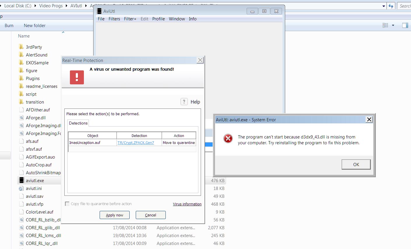

    So far, I'm having no luck even trying to run it! Downloading 'Extra pack 1.9' version and trying opening it brings up a virus warning (TR/Crypt.ZPACK.Gen.7). I've quarantined that (I hope) and then, because I'm running Win 7 32 bit, I overwrote the exe with the 'minimal' version , as suggested. That brings up a 'd3dx9_43.dll file is missing' !!.......
    I can't say that this freebie is inspiring a lot of confidence at the moment...
    SOME antivirus marks the FFT-Audio spectrum viewer as malware, it is a FALSE POSITIVE. Quarantine will only disable this function, not affecting the rest of the program.
    Recent AV-updates SHOULD remove such warning unless the heuristic mark it so. See the virustotal report for it:
    https://www.virustotal.com/en/file/92da137bcad9eeb5859e8724debc8aaa2889b740bb6cad6b746...5929/analysis/
    If you do not have d3dx9 (DirectX9), that means you're either using a very old machine or for some reason, no DirectX9 installed/broken.

    @Maverick Tse -- It was Avira that reported the 'virus' as a false positive. (Screen capture attached). Dxdiag shows my directx installation as DirectX 11.
    I have had no other problems (AFAIK) with that installation so far.....
    Using the minimal version of Aviutl seems to work fine, so I'll stick with that version for the present.....

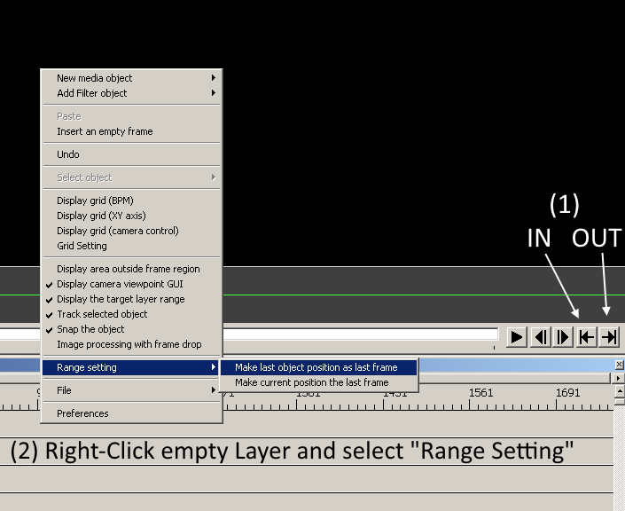

    And for some reason I had to export 578 frames, even though I only need 350? Not sure how to change the 'exportable' length of the timeline......
    There are two ways I know how to select export range and they are detailed in the attached image.

    I'll try to provide some better instructions......
    Right click an empty track => new media object => Graphic. You can drag the layer out to the desired length on the timeline. In the settings, it's set to "circle". You can set it to "square", then adjust the size and aspect parmeters to make it a rectangle. You can enter numbers for parameters by clicking on the value with the underline. Size is horizontal size, so for a 1280 width project entering 1280 will cover the entire width. You can fiddle with the aspect to change the height (you will need a negative number)
    The "coverup" rectangles are "black" like the background, but for animation purposes, you change the opacity (it's called "clearness" in aviutl) so it's semi transparent, so you can "see" what you're doing. You change it back to clearness of "zero" when you do final render
    When the playhead is on the desired frame, right click on the layer of interest, and "add midpoint" to set a keyframe (aviutl calls keyframes "midpoints"). The default keyboard shortcut for this is "P" and probably faster . You can enter values to move the rectangle, but for something like this it's probably easier to drag the rectangle with the mouse in the window. You can hold the shift key to constrain movement (you want to drag only in x-axis), and drag the rectangle to the right. Repeat for each movement. Important that you set the keyframe interpolation to "teleportation" , to prevent keyframe interpolation like "tweening" between keyframes. You do this by pushing the "x" button in the parameter window (standard drawing interface). "Teleportation" is like a "hold keyframe" that stays at that value until the next keyframe.
