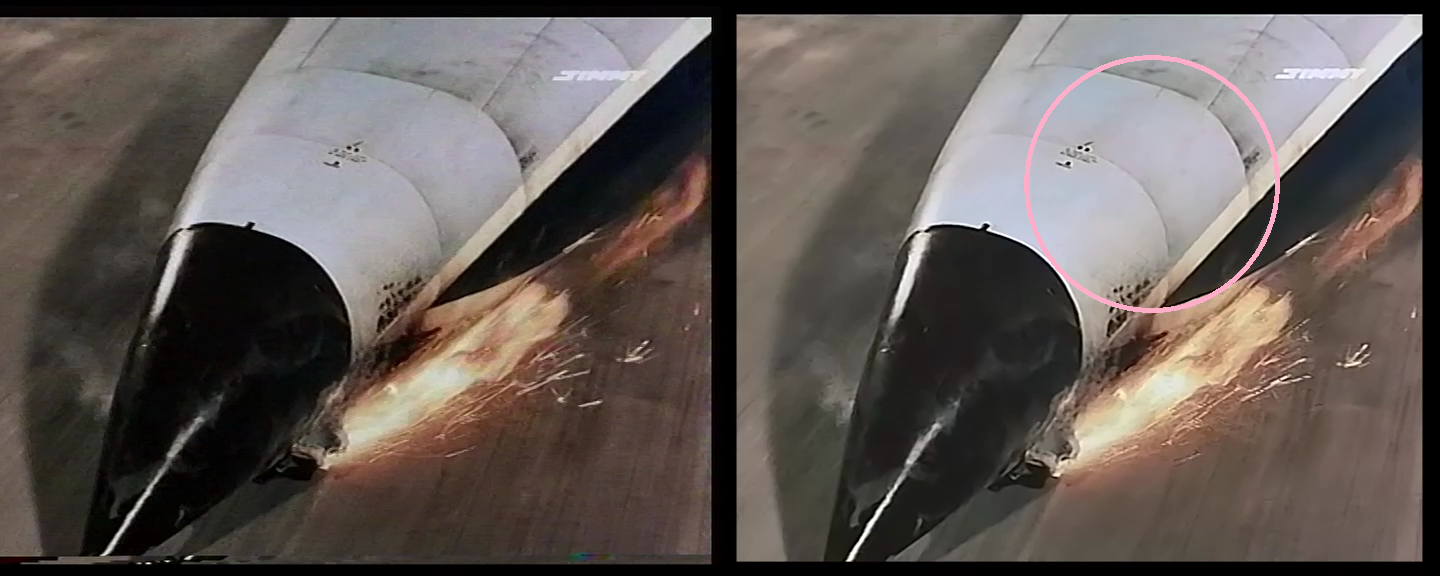

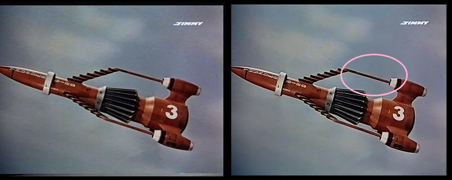

    My first impression is that you removed some details, typical of NeatVideo aggressive denoise if not well parameterized:
    [Attachment 65048 - Click to enlarge]
    This is my attempt at the same frame:
    [Attachment 65049 - Click to enlarge]
    and I also see aggressive sharpening, highlighting halos:
    [Attachment 65050 - Click to enlarge]

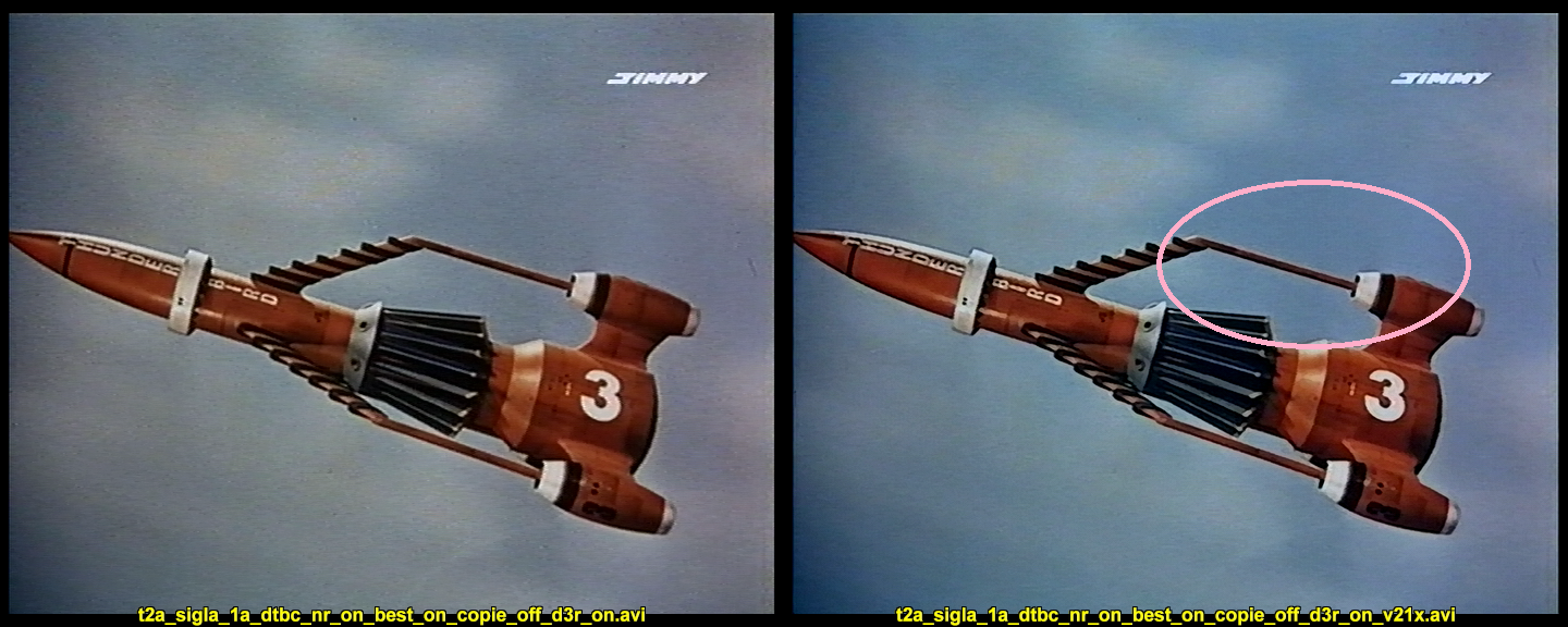

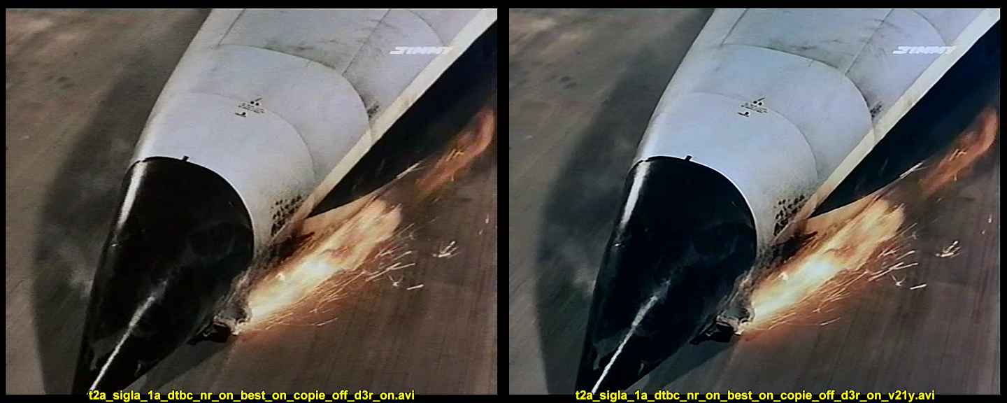

    [Attachment 65051 - Click to enlarge]
    On the other hand I see a good stabilization, because original recording is a bit shaky.
    In any case, the best way to judge, is to put side-by-side your restoration versus mine, without mp4 compression.
    Here is the result of my AviSynth restoration, add yours on left side and upload: https://drive.google.com/file/d/1s485xeKY1z4SVq4Z1ZafRVQGVOLmGfXp/view?usp=sharing
