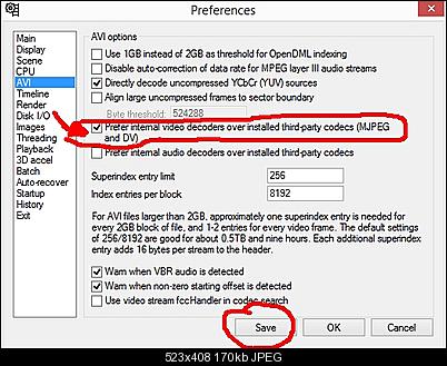

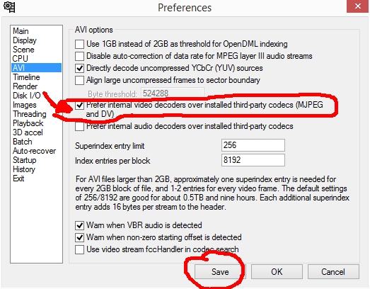

    In virutaldub I have set this so it use Internal MJPEG decoder to load .avi mjpeg
    and all is ok

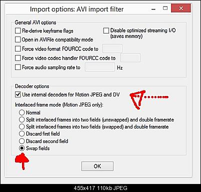

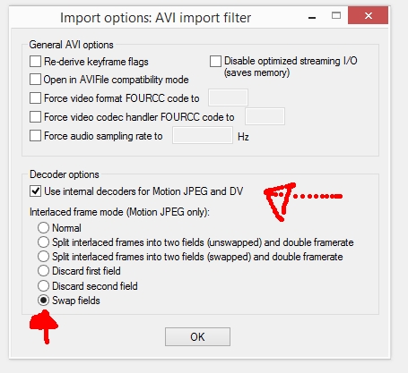

    But now I would like that virtualdub, by default, have to swap field when treat mjpeg files.
    In the "open video files" ---> "ask for extended option after this dialog"
    I can manually set - each time - the swap field option.... but I have to batch process so I have to set virtualdub for "swap field" by default, at least when it opens mjpeg .avi files but I cannot find the way to set it by default
    Is there a way to resolve? thanks

  3. yes, possibly I would like that the internal mjpeg decoder open an mjpeg avi file, jet with the swap field option, without recours to the "field swap" filter.
    However I cannot find any option in virtualdub that do this, this seems not possible
    Avisynth is a beautiful program but is absolute uncomfortable when it load a big .mxf or .avi file (of 30-40GB) because due to the ffmpeg plugin indexing: I'm forced to wait 12-15 minutes only for the indexing process uselessy.
    Virtualdub, with the ffmpeg plugin, have to waith few seconds to open a large .mxf file

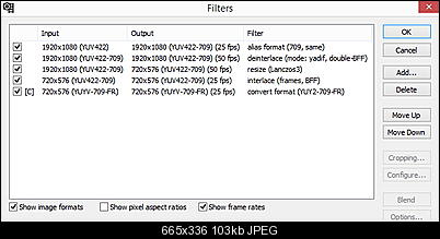

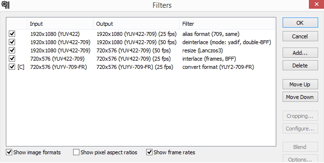

             echo VirtualDub.video.filters.Clear^(^);>>%1
             echo VirtualDub.video.filters.Add^("alias format"^);>>%1
             echo VirtualDub.video.filters.instance[0].Config^(2, 0^);>>%1
             echo VirtualDub.video.filters.Add^("deinterlace"^);>>%1
             echo VirtualDub.video.filters.instance[1].Config^(0,0,1^);>>%1
             echo VirtualDub.video.filters.Add^("resize"^);>>%1
             echo VirtualDub.video.filters.instance[2].Config^(720,576,0,4,3,0,320,240,4,3,0,135,1,0x000000^);>>%1
             echo VirtualDub.video.filters.Add^("interlace"^);>>%1
             echo VirtualDub.video.filters.instance[3].Config^(0, 1^);>>%1
             echo VirtualDub.video.filters.Add^("convert format"^);>>%1
             echo VirtualDub.video.filters.instance[4].Config^(39^);>>%1
