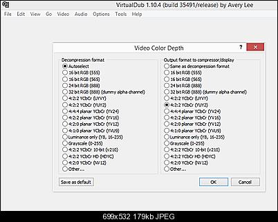

    Simply I have to do this:
    1) change REC.709 <---and viceversa---> REC.601

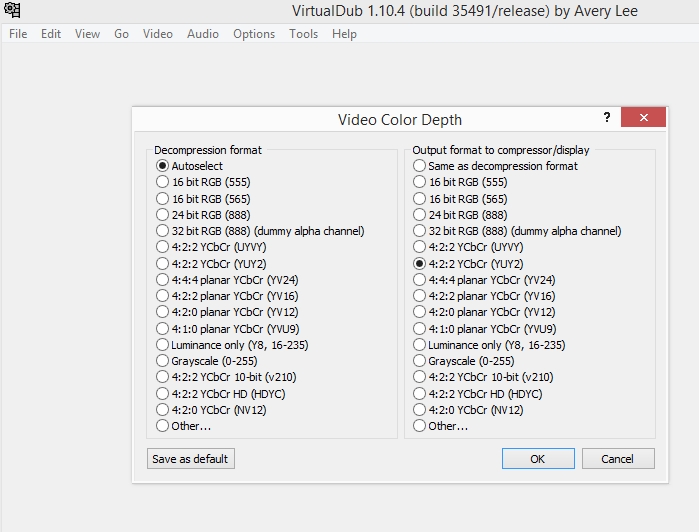

    2) change so that output is YUY2 4:2:2 [in avisynth is done by the ConvertToYUY2(interlace=true)] to avoid chroma ghost when input is 4:2:0
    hoewver in virtualdub I keep as color depth output this
    3) change video levels PC <--> TV
    Why I cannot find plugin or solution that do that? thanks

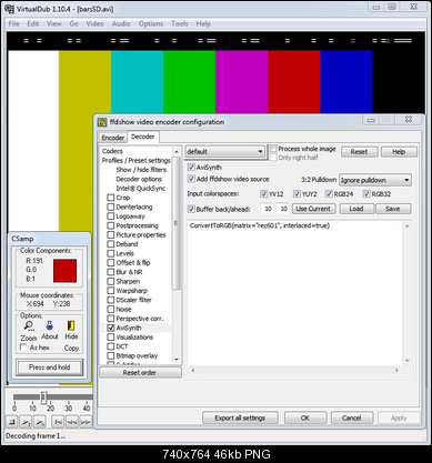

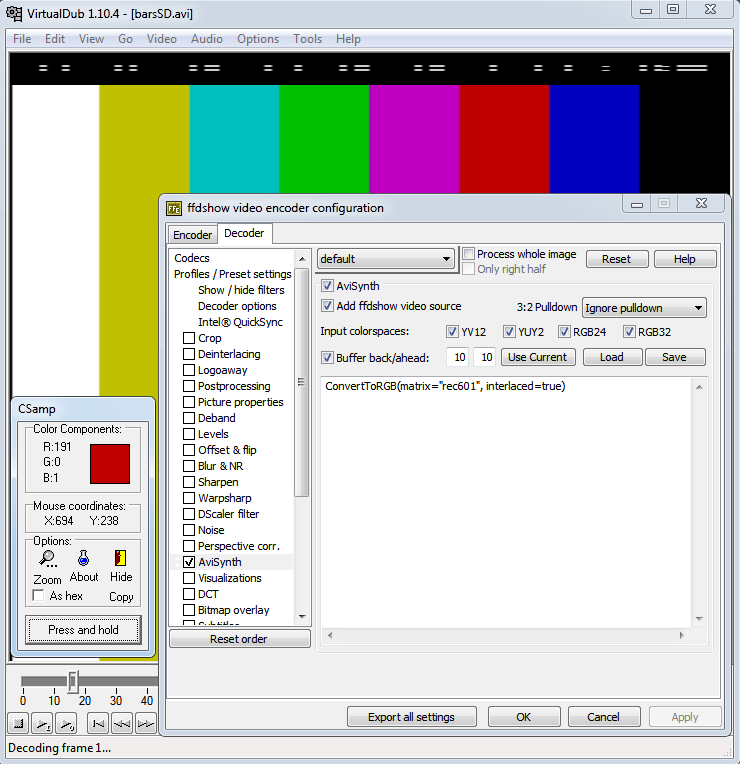

  7. I do know of one convoluted way you can use AviSynth filters in VirtualDub. You mentioned it earlier -- use ffdshow as the video decoder, then use ffdshow's AviSynth filtering. All the AviSynth filters will be applied before VirtualDub gets the video. For example, I took you colorbars video and remuxed it into an AVI file because I have ffshow set up ad the decoder for MPEG 2 in AVI:
    You can use ColorMatrix(rec.601->rec.709) instead when upscaling.

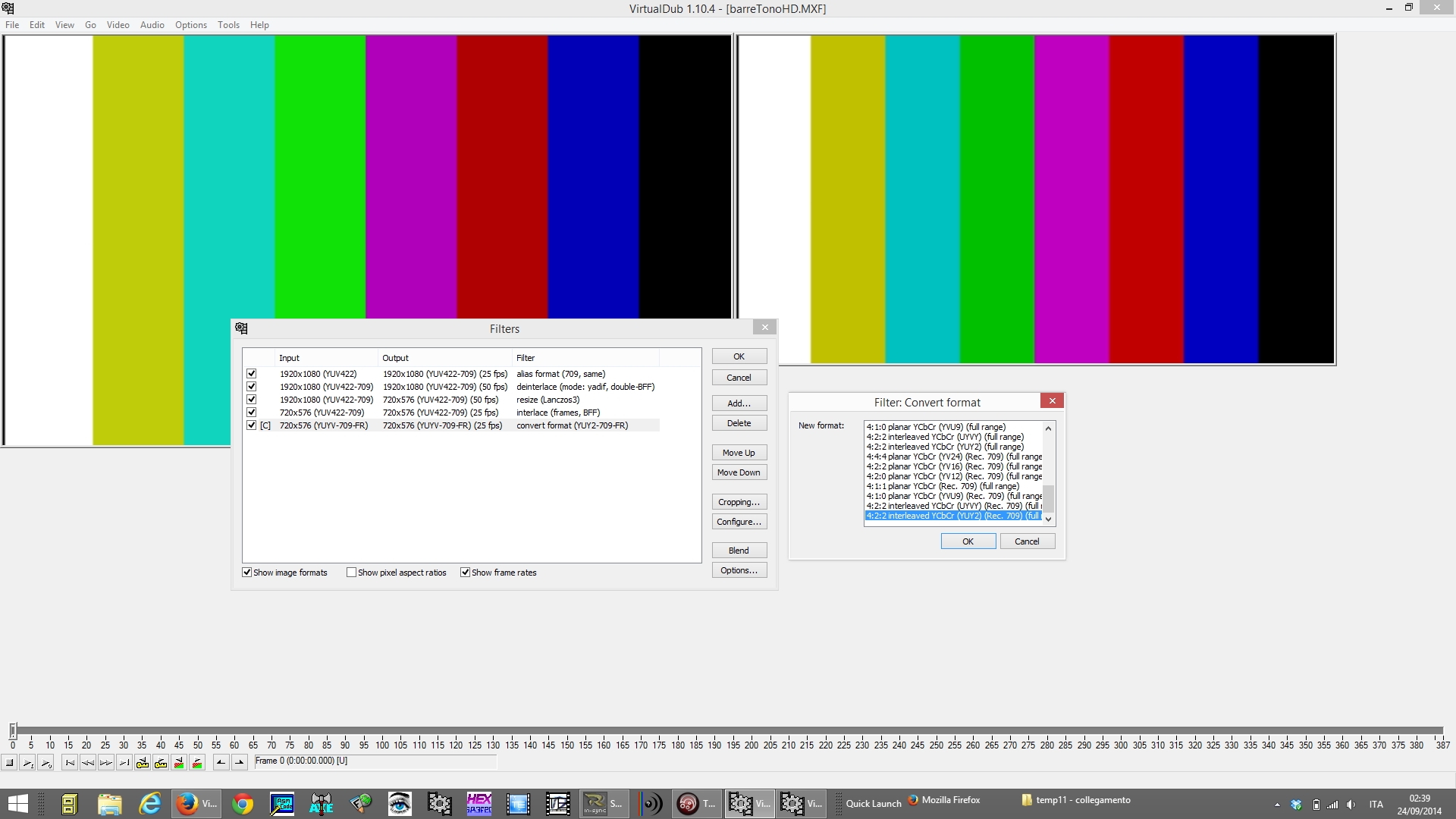

  13. mmmmm
    but I'a cat, too complicated ffdshow for cats.. too many mess, too many problem each time with ffdshow

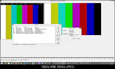

    I don't know if it can work well but I've try load the source directly in virtualdub and set this filters:
    and seems work, but I have to well try this method

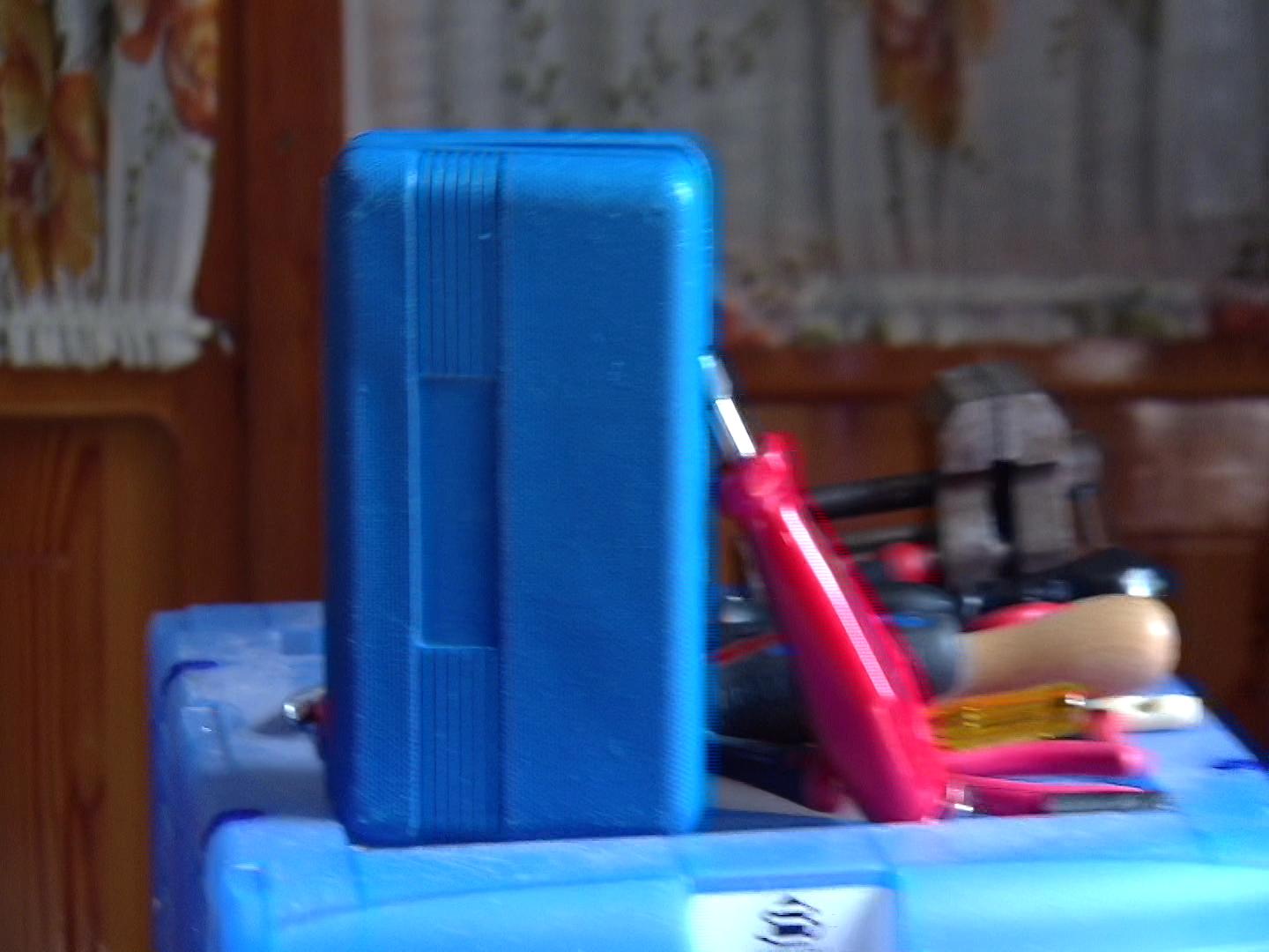

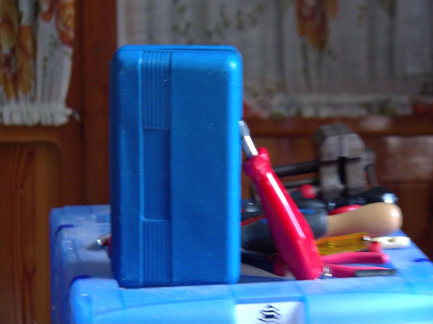

  16. Originally Posted by marcorocchini View Post
    this is a HD file REC.709 1920x1080 but in 4:2:0 (I would like to do virtualdub downscale that can transcode it into SD but avoiding chroma ghost: this artifacts can be well watched on red and blue zone in fast movement of the image when transcoding is bad)
    You can use the MPEG 2 source plugin then Video -> Color Depth... Decompression Format YUY2. That will force the MPEG 2 plugin to do the conversion to YUY2 -- it handles interlaced YV12 to YUY2 properly.
    Not forced, deinterlace Yadif:
    Forced to YUY2, deinterlace Yadif:

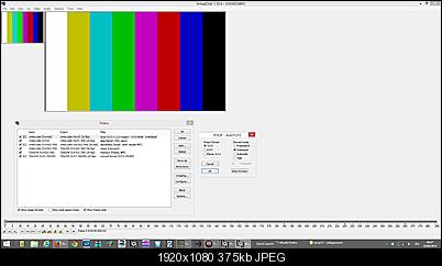

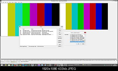

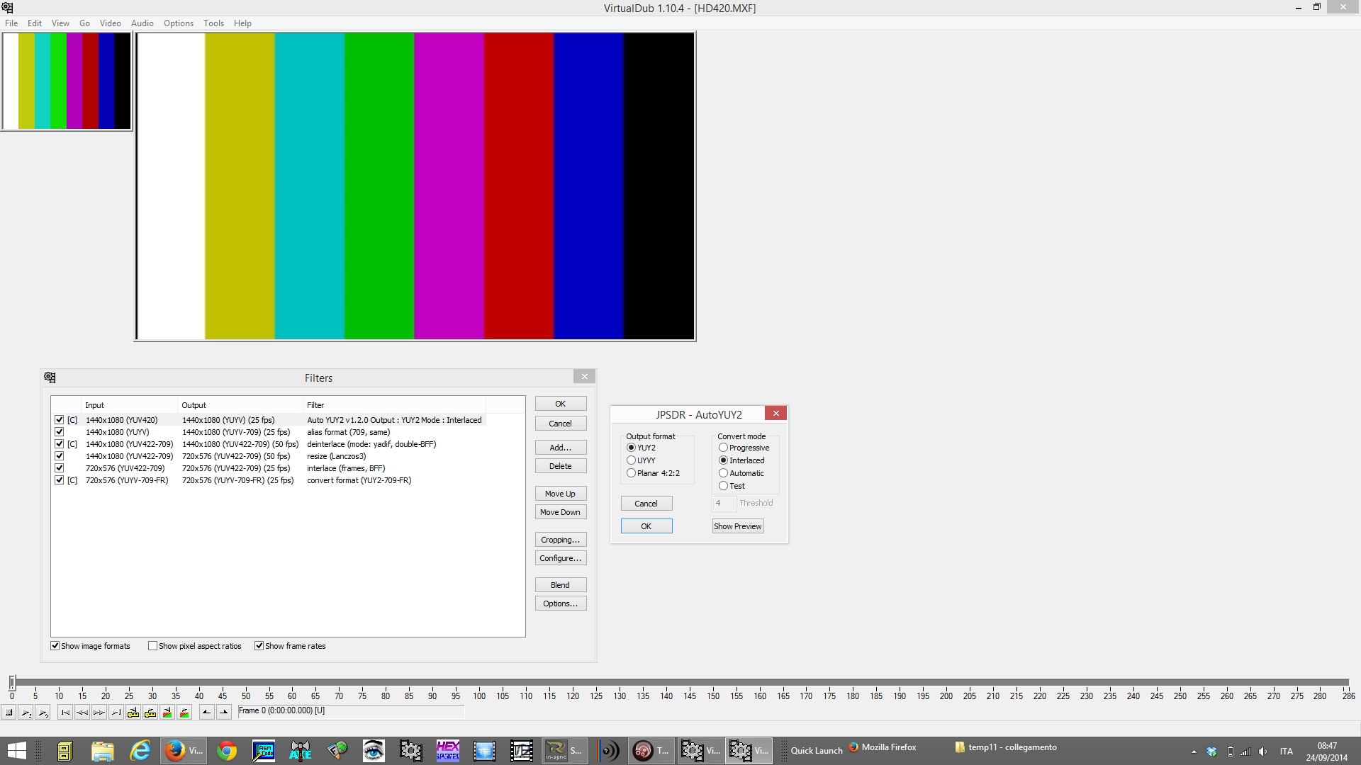

  18. not tried enough but maybe this for HD 4:2:0 rec.709 files versus SD 720x576 rec.601

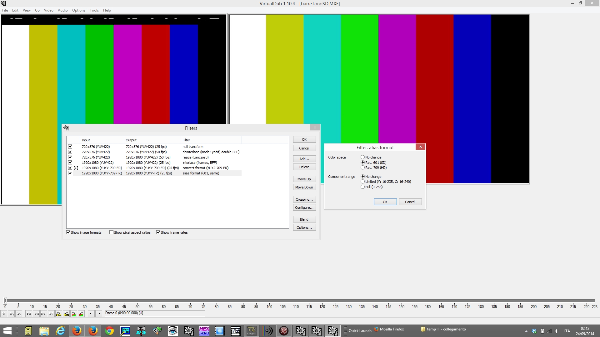

  19. I downloaded and tested the AutoYUY2 and it properly converts interlaced YV12 to interlaced YUY2. I hadn't noticed the Alias Format filter before (it was added to VirtualDub version 1.10.0). But it does convert between rec.709 and rec.601.

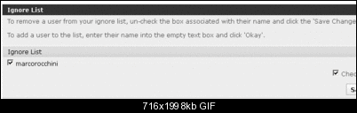

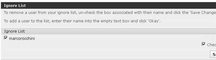

  27. There's three cats in this house but it doesn't mean I want to sound like a nutter cat-lady. I don't seem to be able to find a way to block annoying gifs from a particular user and I don't want to block images completely. This seems to fix the problem
