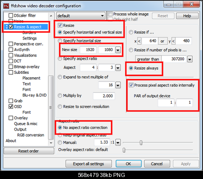

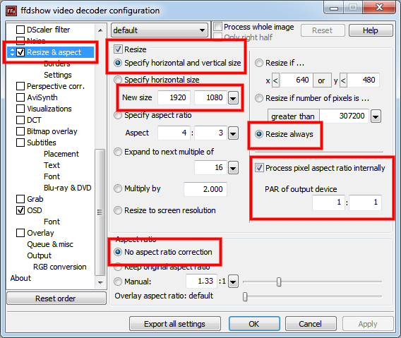

  16. Like this:
    New Size should be set to your monitor frame size.
    Once again, this won't effect only the screen saver. It will screw up every video you play using ffdshow as the decoder.
  17. Originally Posted by jagabo View Post
    Like this:
    [Attachment 27623 - Click to enlarge]
    That's brilliant, thank you! I'll let you know how I get on. I'm gonna uninstall K-Lite and ffdshow and do a fresh install of just ffdshow. Could you have a look at the other problem I've been having?
