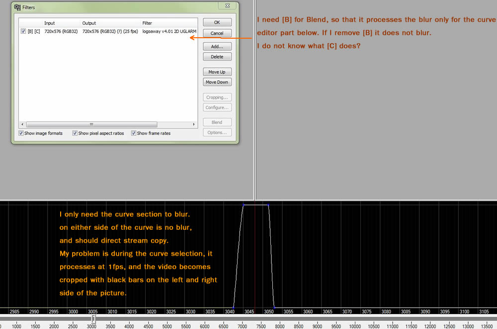

  6. still slow bigMach™'s Avatar
    Nov 2005
    village of PAL
    I will check it tonight.
    Have a look at screenshot of what I mean.

    Nov 2002
    Leave XviD settings alone > use Curve editor with filter in blend mode as shown above and under Video > choose Compression > XviD > under Video choose Smart Render and save new avi. Virtualdub will only re-encode the blurred sections and direct stream copy the rest.
    Make sure when using the curve editor that you get the bottom points all the way down or you'll end up re-encoding the whole file (or however long that section is) and if you fail to set compression to XviD (or whatever the original encoder was), you will be saving a file with no compression which will take forever and create a huge file.
