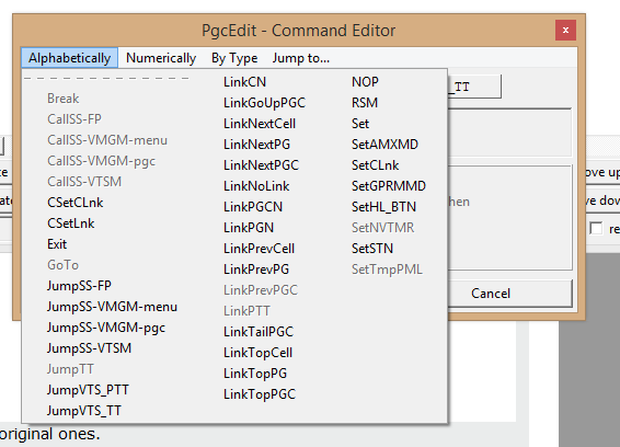

    I've tried replacing the VTST 1 in PgcEdit (Though I know you didn't recommend this), but it responds with this:
    ERROR:
    There are 4 TTNs in the original VTST
    and 1 TTNs in the imported VTST.
    The imported domain must have 4 TTNs, or more.
    Sorry.
    Creating a new DVD with the original menus and the episodes made by MuxMan - Should I use PgcEdit to make a "New DVD" then?
    I've tried choosing "New DVD" in PgcEdit, and importing PGC Commands and Menu Butttons and POVS that I exported from the Original DVD. Nothing really seems to happen when I import them, though. Nothing new in the program shows up.
    When trying the option of importing the authored dvds into the original structure with PgcEdit - I've imported the 3 PGCs made in MuxMan into the original DVD with PgcEdit:
    I then try to make the menu jump to the newly imported titles instead of the original ones.
    Unfortunately it seems to only be able to jump to the "TTN"'s of the original dvd - Not the imported ones VTST 2, 3, and 4.
    I can't seem to find another option, where I can make it jump to the newly imported ones? (I would also like to option to point to a specific chapter in one of the newly imported titles in another menu) - And what is the "Domain" referenced in the bottom part of the image?

    Yes, that's why I wrote "Import VTST Titles" and not "Replace VTST Titles". In order to use the later one you need to have at least the same number of titles.
    The "domain" means the current VTST, where the command it's called. In your case you have 4 VTST and "LinkPGCN PGC 1" means you are jumping to PGC 1 en VTST 1 (in your case, the Root Menu), but you need to jump to titles 5, 6 and 7. You should use command "(JumpTT) Jump to Title X", and you should replace X accordingly, ie, you should replace jumps to title 1 (TTN 1) with 5, title 2 (TTN 2) with 6 and title 3 (TTN 3) with 7. That should make it work.
    Finally, make sure to copy pre and post command from the original titles to the new ones, and then blank the original titles with VobBlanker, to regain space.
    Just an FYI, this is a method I used a couple of months ago to replicate the original structure, along with a "Play All titles" feature. It' not necesary in your case and it's a lot more work, but just wanted to point it out. In your case, only steps 1 to 6 are required: http://forum.doom9.org/showthread.php?t=170754

    Unfortunately, I'm unable to use the "JumpTT" option. As you can see in my screenshot in my last post, in the first of the "PgcEdit - Command Editor"-windows I've copied out of the screenshot, the "JumpTT" option has been grayed out. I don't know why.
    Also here:

    I should've used the method you mentioned in your first post from the start, XIAM10, I just didn't understand it then :b
    I open each reauthored PGC, that I made with MuxMan (with 3 episodes each) in VobBlanker and open TTN 1 in VTS_01, so the list of cells come up. I use the ExtAll Multi command, so I get each cell in a seperate file, in 3 new folders, corresponding the 3 PGCS.
    Then I open the original DVD in VobBlanker and go into the cell-screen TTN 1, 2 and 3 and replace all the cells that ISN'T reused, with the cells I extracted in VobBlanker. In TTN 1, in my case, it's cells 5, 8, 9 and 12 that I don't replace.
    Everything seems to work now. Thanks XIAM10! (And the others :b).

    Sorry, my bad. There are commands that can't be used in certain places, so they will be grayed out in PgcEdit. In order to use JumpTT you have to make a jump to a PGC in the VMGM and from there you can use JumpTT to go to a title.
    One thing I forgot to mention is that you should open the final DVD in PgcEdit and restore the "Type flags" (especially the seamless joint flag) in each modified episode. Apparently, VobBlanker clears those flags when you replace by cell. Just double click the episode and you will see them. Use the original DVD as a reference and leave them the same. Otherwise, the episodes won't be played smoothly and you will notice some stuttering.
