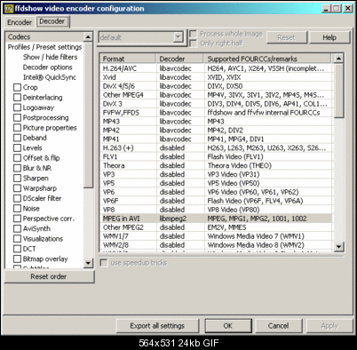

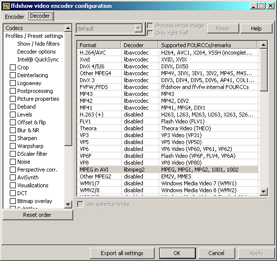

  2. Install ffdshow and register ffdshow as native decoder for your video codec (in both ffdshow modes i.e. for vfw and for dshow) - vdub use vfw then after this it should work fine
    as this is virtualdubmod then in exchange avisynth can be used (with ffms plugin - http://code.google.com/p/ffmpegsource/ )
    alternatively to this you can use avidemux - it should work similar to virtualdub (gui only mode)
    also you may give a chance to ffmpeg
    as you see there is plenty possibilities.
  3. ffdshow (with the VFW codecs included in the install) should fix it. Just make sure the appropriate ones are enabled.
    Mind you it shouldn't matter. You should still be able to extract/replace the existing audio and save the output as a new AVI. You just won't be able to preview the video.
