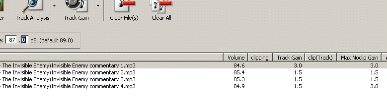

  3. I happened to have 4 tracks from an old TV show sitting on my hard drive (mp3s) so I thought I'd give them a quick scan. They're the commentary tracks, not the standard ones. Once I ran ReplayGain I reduced the target volume until the adjustment would no longer cause clipping. The target volume required in this case turned out to be 87dB.
    [Attachment 25610 - Click to enlarge]
