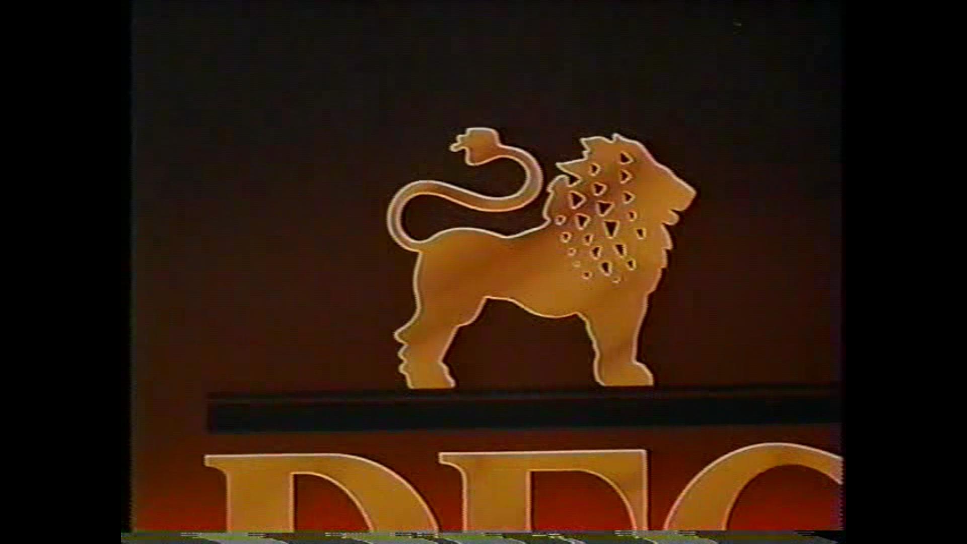

    This is a good representation of the problem:

    The tape (from 200n?) was made with a capture from a wire (vs. FiOS) cable connection, all very much pre-HD. The conversion was done on the VX-560 onto a DVD-R. The image was captured from viewing the video with VLC. The scene is a zoom out of the logo shown. That's all probably a little OCD but there it is.

    Yes it is technically lost picture information, but there is nothing you can do to restore it without adding additional hardware or possibly messing with the internals of your unit. Cleaning the heads is unrelated. Your machine distorts more lines than the average VCR, there are some that distort only a couple, and a few that were specifically designed to recover as much image as possible. (Some further reading from my quests through this topic.)
    I would be more concerned by the ridiculous amount of artifacting in the rest of the picture, but if it doesn't bother you, consider yourself lucky.

    But artifacting? It may help to point out this tape is about 15 years old, was captured off a Comcast wire connection (vs. fiber) before HD was an option. This is the bad old 512 scan line stuff. Aside from the miserable resolution (IMHO the VX-560 does a passable, if not great, job of trying to heal the miserable image) and the 4:3 aspect ratio, the results are surprisingly good. I think much of what you're reacting to is a classic case of GIGO. The signal Comcast shoved down the wire wasn't that good to begin with, and it all went downhill from there, so there's no surprise the DVD winds up with a less than stellar set of images.
