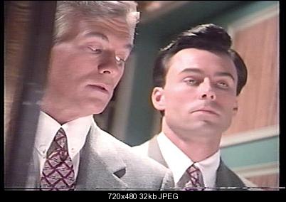

    I've seen some recordings from VHS where the "head switching noise" (as I've seen it called) is perfectly corrected except for a few lines maybe 8-10 lines up from the bottom.
    I believe these were done using DVD recorders, but which ones? Any TBC that corrects these lines as well?
    Meanwhile, this image is from an official DVD release and it has errors at both bottom and top. Pretty sad.

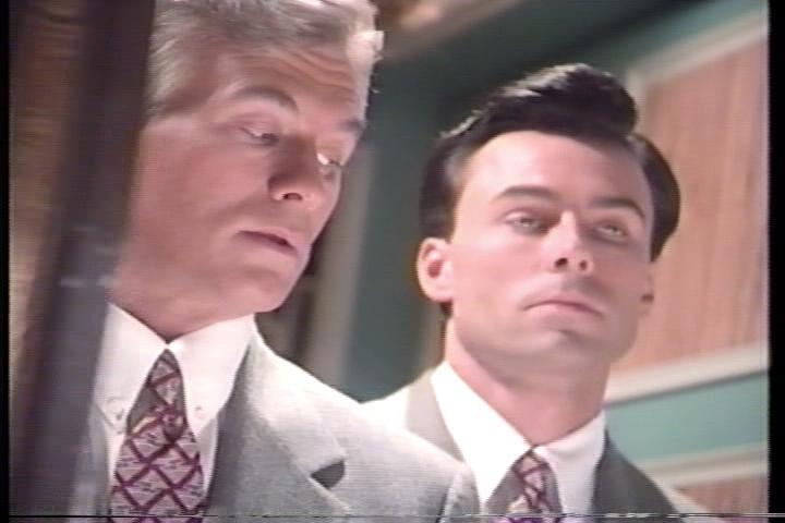

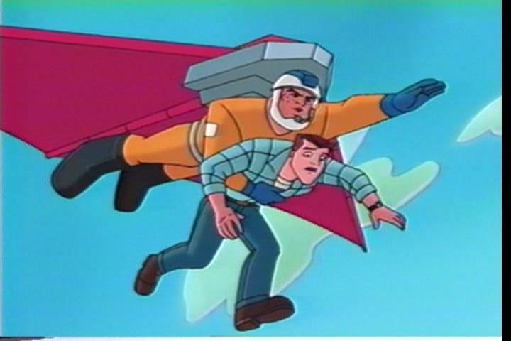

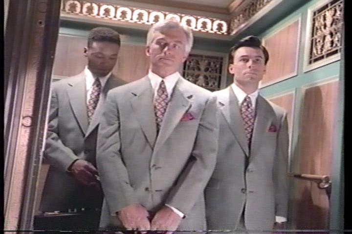

    I said nothing about varying amounts. I talked about videos I have seen where the head switching noise looks almost like normal video -- except for some lines midway through. I'd like to know how to accomplish that with my own transfers.
ID:	15782Click image for larger version
    I would post a video clip but my upload speed is soooo sloooow.
    Maybe it has nothing to do with the capture end and everything to do with the player, I don't know. But I think the guy who was writing a software TBC also found that he was able to un-stretch (or whichever term) this area of the video almost back to normal.

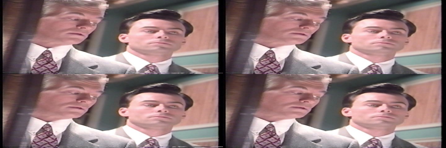

  23. If the bad lines don't move up and down it's pretty easy to fill them with data interpolated from the lines above and below. Individual fields of the original on the left, bad lines interpolated (via AviSynth) on the right:

  25. Originally Posted by jagabo View Post
    I can use something like that. How'd you do it?
    Off topic, but did you see the post at Doom9 where the guy updated/modded a lot of the frame interpolators using MFlowInter and MVFlowFPS:
    http://forum.doom9.org/showthread.php?p=1620974#post1620974
  26. Originally Posted by manono View Post
    I stacked the line above the bad lines and the line below the bad lines into a two line image, stretched it to four lines, cropped away the top and bottom lines, then overlaid the new two lines onto the original image (twice, once for each field).
    ImageSource("VTS_01_1004.jpg")
    AssumeTFF()
    SeparateFields()
    top=SelectEven()
    bot=SelectOdd()
    # fix top field
    p1=Crop(top,0,235,-0,1)
    p2=Crop(top,0,238,-0,1)
    StackVertical(p1,p2)
    PointResize(720, 4).Blur(1.0).Blur(0,1.0) # cheap interpolation, or use another resizer
    Crop(0,1,-0,-1)
    newtop=Overlay(top,last,0,236)
    # fix bottom field
    p1=Crop(bot,0,234,-0,1)
    p2=Crop(bot,0,237,-0,1)
    Crop(0,1,-0,-1)
    newbot=Overlay(bot,last,0,235)
    Interleave(newtop, newbot)
    AssumeTFF()
    Weave()
    For YV12 video you'll have to modify this because you can't have single pixel thin lines. And, as I recall, BilinearResize() etc. don't work with two line tall videos. So you would need to modify the script to use them.
