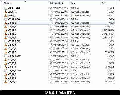

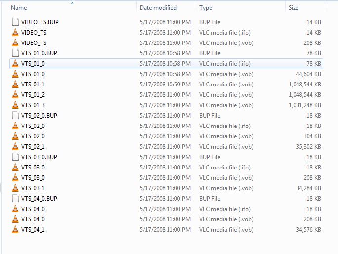

  10. It's .VOB files 11 of them when I open the Folder. Like I said everything digital is on my hard drive, including every CD and DVD I own. When I go to the main menu I get 54 segments. Now this is in YES DVD. Here is an imageClick image for larger version

    For LostSoul65's info, the files that contain the actual videos are .VOB files. The owner disabled file endings in Windows, so he can't see the ".vob" part of the file names. The structure of DVD folders and files on a disc looks like this: https://www.videohelp.com/dvd#struct .
    The files shown in the posted pic have video and audio content in these files:
    VTS_01_1.vob
    VTS_01_2.vob
    VTS_01_3.vob
    VTS_02_1.vob
    VTS_03_1.vob
    VTS_04_1.vob
    The DVD has 4 titles and 4 menus. The menu for each title uses an ".ifo" file together with a matching file that looks like "vts_0x_0.vob". The backup files have ".bup" extensions.
    I have some dandy software that can pull out those videos and separate 'em lickety-split. But there's a lot of free stuff and some budget software that can do it for you. I don't have that other stuff, but someone who uses it can chime in and help.

  14. 'I would like to know how I can separate each segment to send to all the old family that is still living'.
    Please make a copy of your folder before you do anything. Work with the copy.
    Now, when you say segments do you mean 'chapters'? There are 54 individual chapters on the disc?
    https://www.videohelp.com/tools/DVD-Decrypter can split by chapter. There is a guide here:
    https://forum.videohelp.com/threads/277756-How-To-Rip-and-Manage-Music-DVDs-just-like-M...r-Media-Center
    All you need to know is in the first half of the tutorial...to the part where the VOBs are split and renamed.
    Play each VOB in VLC (after the split) and rename them to your liking.
    If that doesn't work I would join all the VOBs below with VOBMerge (save to mpeg) and split by hand with
    VideotoVideo (Tools>Split Video (use 'Direct Stream Copy' preset when prompted so there is no quality loss)):
    VTS_01_1.vob
    VTS_01_2.vob
    VTS_01_3.vob
    VTS_02_1.vob
    VTS_03_1.vob
    VTS_04_1.vob
    Edit: tutorial on Videotovideo is here: https://forum.videohelp.com/threads/354976-How-to-cut-any-video-with-the-free-Video-to-...ideo-Converter
