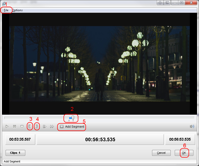

    Guide:
    Start Video to Video Converter

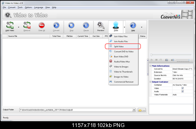

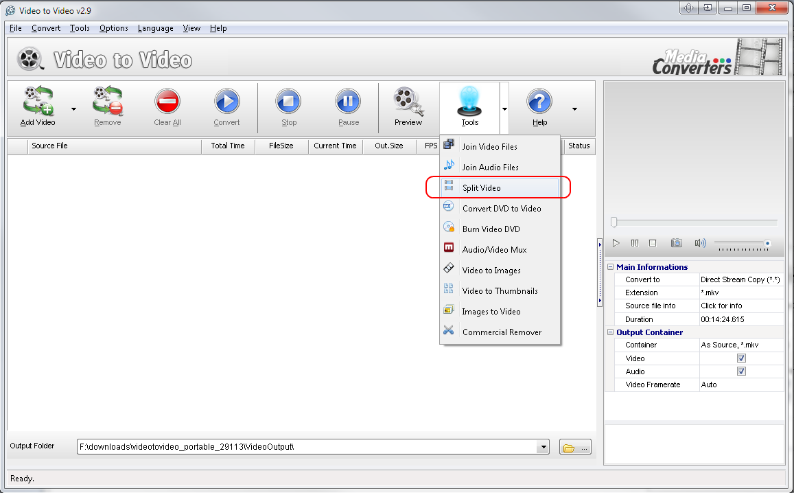

    Under Tools select Split Video

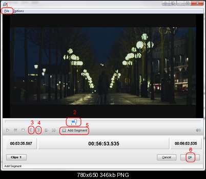

    1. Load your video file.
    2. Drag the bar to the start of your clip.
    3. Click on set start mark.
    2. Drag the bar to the end of your clip.
    4. Set the stop mark.
    5. Add Segment
    Repeat to add more clips.
    6. Click OK

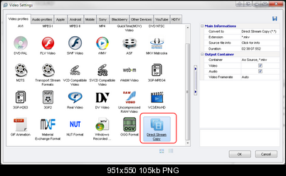

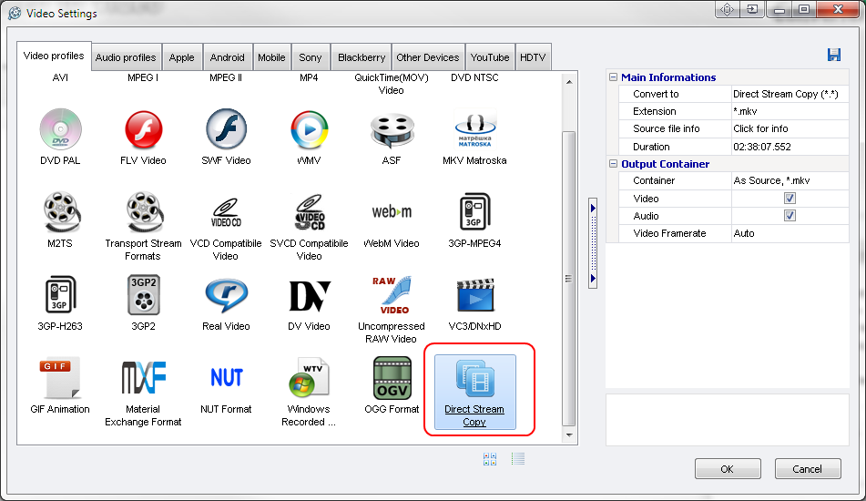

    Choose Direct Stream Copy to avoid any video reconversion. You can of course also choose a preset if you want to it any other video format.

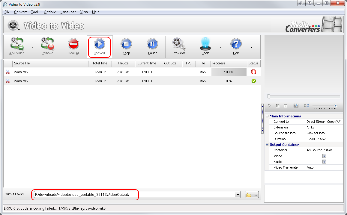

    Set the output folder.
    Convert. It should only take some seconds for a shorter clips.
    Done.
    Problems:
    It might not be possible to cut exactly in all kinds of video.
