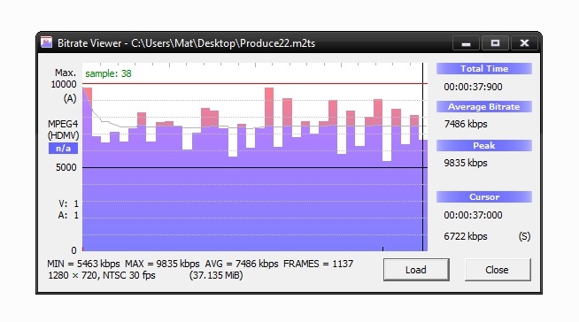

    Ok Jagabo here are my settings in the profile for PowerDirector:
    <Class>AVCHD
    <Name>Custom Profile -1
    <Description>
    Custom Profile -1
    <Output FileName>
    <DescID>16697
    <NameID>16696

    Please note the min and max are at zero, but this setting seems to produce good quality, again the M and N is showing but if I go higher with more frames in the GOP then power director crashes.
    This settings eeems to work well, what do you guys think?
    Ohh and a screenie of the bitrate viewer of the same file.

  12. I thought your plan was to "spare no expense with the final bitrate". A ~10 percent larger file hardly seems like a problem. Use whatever bitrate is necessary to get the quality you want. And, as was pointed out earlier, Youtube is going to compress it down to ~3000 kbps. Whether your upload is 7000 kbps or 50000 kbps you probably won't see much difference after Youtube is done with it.
  13. Originally Posted by jagabo View Post
    Exactly. All this fine tuning is just spitting into the wind.
    Nov 2013
    Australia
    OK, ok.........hmmmm thanks then guys if I am "Spitting into the Wind" thanks jagabo for the lessons in GOP and bitrates etc it has been invaluable, maybe when YT does open up the 60fps then things may change a little. How is it then that 4k is available, surely the bitrates on those vids are through the roof and surely there would be less spitting into the wind?
  15. I haven't downloaded any 4K videos -- but Youtube over compresses everything else to the point of making it marginally watchable. I doubt they'll change that for 4K.
