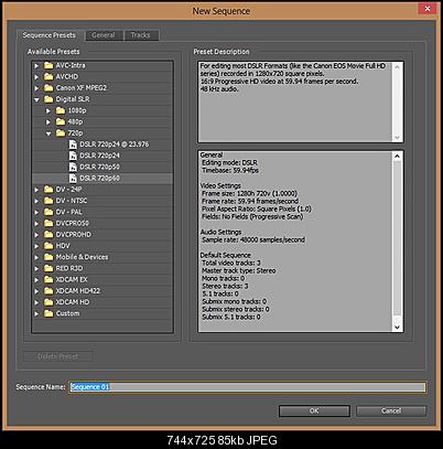

    Video Editing/Encoding:
    Adobe Premiere Pro CS5 w/Zeranoe (http://ffmpeg.zeranoe.com/builds/) ffmpeg windows 64 bit binary - that has lbx264 already compiled in.
    Available Preset: Digital SLR/720p/DSLR 720p60
    Preset Description: For editing most DSLR Formats (like the Canon EOS Movie Full HD series)
    recorded in 1280x720 square pixels. 16:9
    Progressive HD video at 59.94 frames per second.
    48 kHz audio.
    General:
    Editing mode: DSLR
    Timebase: 59.94fps
    Video Settings
    Frame size: 1280h 720v (1.0000)
    Frame rate: 59.94 frames/second
    Pixel Aspect Ratio: Square Pixels (1.0)
    Fields: No Fields (Progressive Scan)
    Audio Settings
    Sample rate: 48000 samples/second
    Default Sequence
    Total video tracks: 3
    Master track type: Stereo
    Mono tracks: 0
    Stereo tracks: 3
    5.1 tracks: 0
    Submix mono tracks: 0
    Submix stereo tracks: 0
    Submix 5.1 tracks: 0

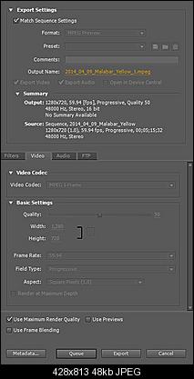

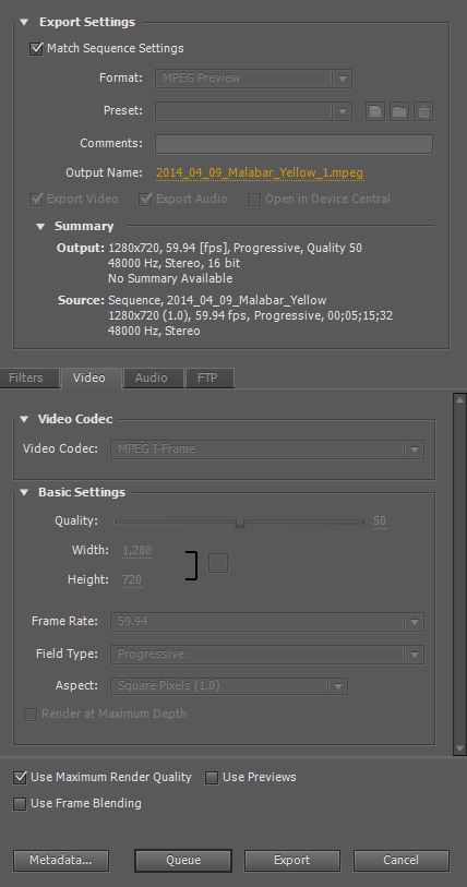

    My encoding progression:
    - I have done this for a while with very good local viewing results and acceptable youtube viewing but this footage is MUCH SLOWER ACTION. Only problem is large output file size.
    Export Settings: Match Sequence Settings,

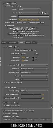

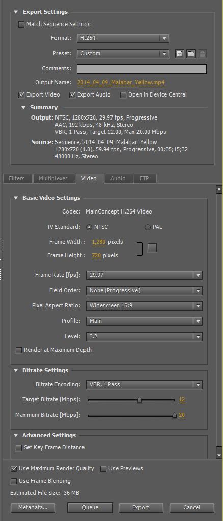

    - I then tried researching H.264 settings and came up with this:
    The output file sizes were much smaller and the local output was still quite nice. Youtube upload was terrible.

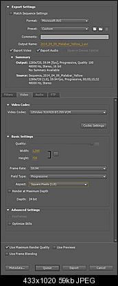

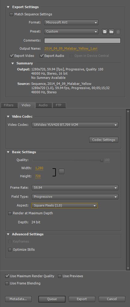

    - At this point I started looking for tools outside of PP,
    - I installed the utvideo, lossless codec for premiere. (https://trac.ffmpeg.org/wiki/Encode/PremierePro).
    - FFMPEG program with the libx264 plugin already installed from Zerenoe (http://ffmpeg.zeranoe.com/builds/)
    This new workflow meant:
    - sending the PP export through utvideo to produce a lossless output file.
    Select Microsoft AVI
    video codec utvideo yuv420 BT.709
    unlinked the frame size to set my 720p video to 1280x720
    matched 59.94, changed to progressive, Aspect square pixels
