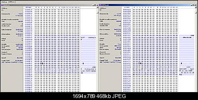

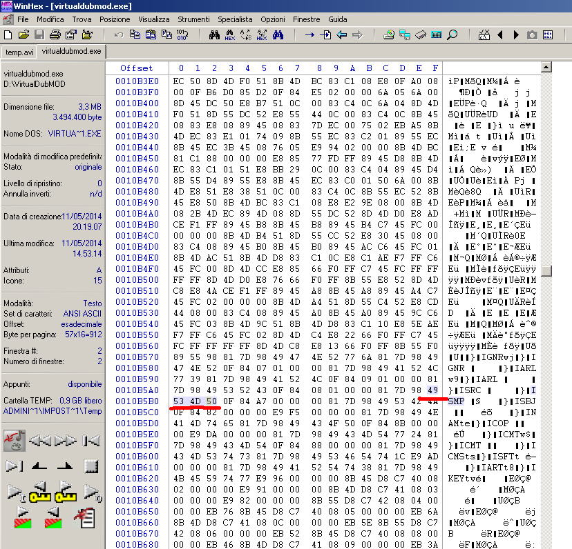

  5. I try to insert timecode into files generated with Virtuadub: it don't write timecode data in avi output file.
    But it's very difficult... I try to change the header of avi as this:
    so my nle can read timecode, and VLC play correctly the avi file but virtualdub won't open the avi file (say "invalid avi file. The main "movi" block is missing)... so this procedure is not full regular.
    Please do you know some programs the at certain point replace a block of data as shown in the attached? thanks

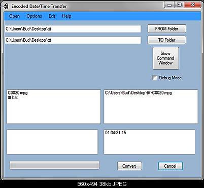

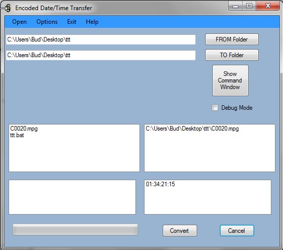

  11. Member Budman1's Avatar
    Jul 2012
    NORTHWEST ILLINOIS, USA
    It's possible to write a small GUI to do what you ask calling MediiaInfo CLI but where on earth did you get 01:34:21:15 from c0020.mxf? It's an MPG file and I could not find any reference to that timecode by searching with a Hex editor. With your example you could just search for ISMP and then parse the date but you cannot just add it in to a file since it changes the whole structure of the file container.

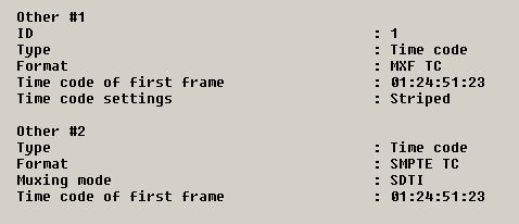

  12. Originally Posted by Budman1 View Post
    Generale

    Altri #1
    Type : Time code
    Formato : MXF TC
    TimeCode_FirstFrame : 01:34:21:15
    TimeCode_Settings : Striped
    Altri #2
    Type : Time code
    Formato : SMPTE TC
    Modo muxing : SDTI

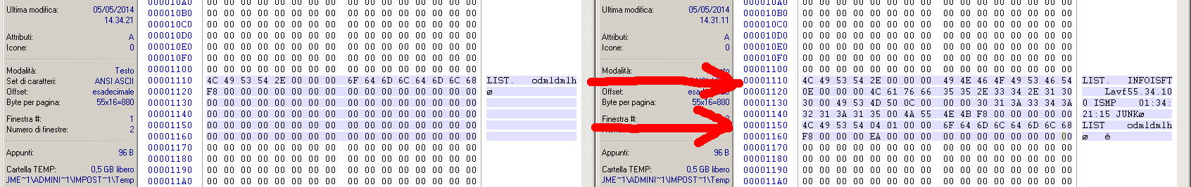

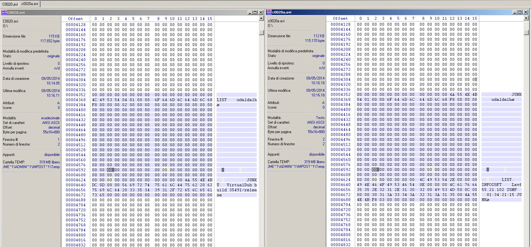

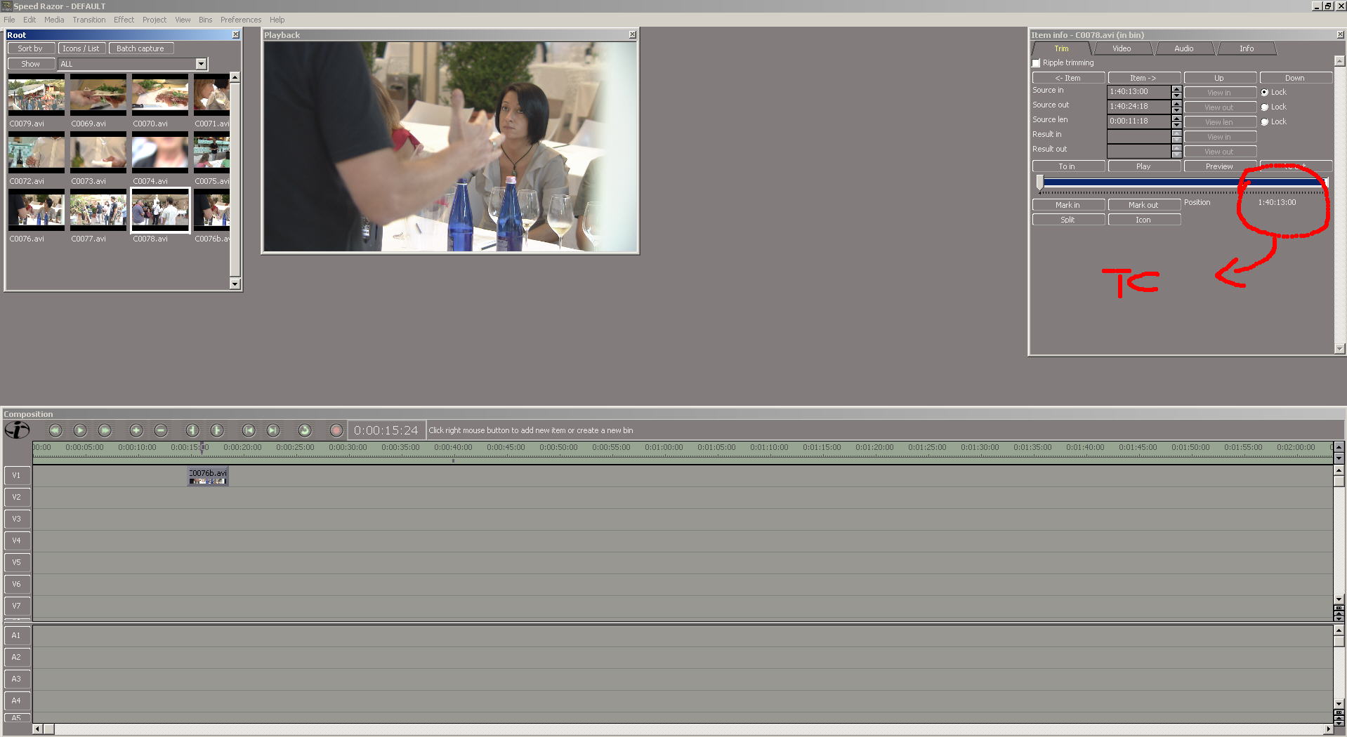

    my target is this:
    I have c0020.mxf as source and with virtualdub I have to re-rencode it in morgan m-jpeg codec, but the avi file output of virtualdub don't have timecode. So I try to add it.
    Poison suggested me to do this:
    ffmpeg -i c0020.mxf -f ffmetadata metadata.txt
    ffmpeg -i c0020.avi -i metadata.txt -map_metadata 1 -vcodec copy -an c0020a.avi
    where C0020.mxf are the virtualdub output file, and C0020a.avi are the goal file that have timecode. But this procedure have a problem:
    my nle, strangely, don't read well the c0020a.avi generated from ffmpeg (maybe is the new header or I don't) meanwhile it read perfetly files generated from virtualdub (c0020.avi)
    Now I try to manually add timecode into the header of c0020.avi... the best solution would be another: which Virtualdub was rewritten to include at least the "printing" of the initial timecode.
    all attempts to replace a block of code within the file generated by virtualdub are a stopgap to the limit of the impossible: the risk is to demage the header of the .avi file making it unusable.

  16. Member Budman1's Avatar
    Jul 2012
    marcorocchini,
    You said you wished to read an MXF file and print a text file with the timecode of the first frame. This will do it:
Name:	ScreenHunter_66 May. 09 14.06.jpg
    Do you want just one file or all in folder and do you just want the timecode or the name of the file in addition?
    01:34:21:15
    01:34:21:15
    or
    c0020.mxf = 01:34:21:15
    c0020.mpg = 01:34:21:15
    UPDATE: I haven't created the actual write to text file but that would end up in the TO folder location if that works.

  26. Member Budman1's Avatar
    Jul 2012
    If you are interested in a text file, you should see in my earlier post, I wrote a gui that pulls the date, lists the time code and saves it to a text file. I asked if you wanted something such name of file along with it. It is drag and drop as well.
    The other scripts here, privided by those that put in a lot of effort, work well also. You have several ways now to get your text file. Adding it to an avi is going to be a little more problem since I don't believe avi is originally set up for meta data unless its contained in the actual format of certain codecs.

  28. thanks budman, your bui I think if useful (but where is downloadable?) hoewver I have to put the timecode extract procedure internally to a batch process so for that I have to do is more useful the ndjamena's script. But a gui maybe helpful on many other occasions.
    In avifile timecode can be added even if the NLE can recognize it. Timecode data in general is suggested by the ISMP written inside the avi file. Virtualdub is not normally able to officially enter the timecode but with VirtualDubMod is possible to automate the insertion of timecode (changing a little VirtualDubMod.exe so that it can "print" ISMP in place e.g. of ISRC) by the addcomment option on the .vcf
