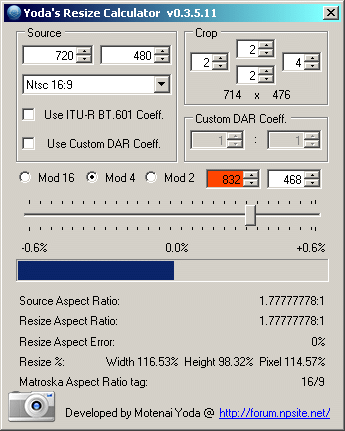

  2. I'm a little OCD about sticking to exact an 16:9 aspect ratio if I can. The closest square pixel 16:9 resolutions to NTSC are 864x486, or 832x468 (assuming straight 16:9 resizing is correct). I'd mostly tend to go with the second option and resize down a little. Especially if I'm cropping some of the original resolution away anyway. You can't crop an odd number of pixels using Handbrake as you can with Avisynth, but if you were to crop like this, you could resize to 832x468, have a perfect 16:9 output aspect ratio, and the resizing distortion would be 0%. Lots of ways to do it, but don't be scared to crop a couple of extra pixels if it helps to resize more accurately. Especially if you're resizing to mod8 dimensions.
    [Attachment 25050 - Click to enlarge]

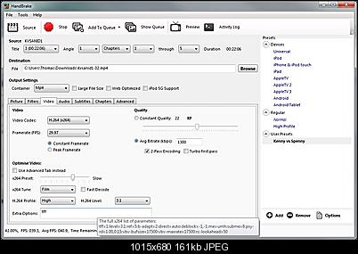

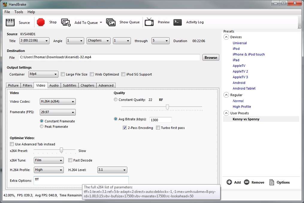

    In handbrake I just added tff into the one field and shows up in the parameters list on mouseover... but I had deinterlace set to slow so, not sure if overrides it, does in addition to it, or what but, the quality is better so finally settled on a preset and ripping the season to my media server.
    I finally settled at 1250kbps 2-pass, and "slower" for the speed. About 228MB which is exactly where I wanted to be size wise.
  7. If you deinterlaced you don't want to encode interlaced (tff, or bff).
  8. Ahh...... I didn't think Handbrake supported interlaced encoding. Or at least I couldn't get it to work when I tried it, but obviously it does.
    As jagabo said though, if you enabled the de-interlacing/decomb filter you shouldn't enable interlaced encoding.
