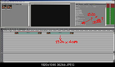

  3. thanks poison, so I use c0020.avi (generated with virtualdub), but I get this problem:
    ffmpeg -i c0020.mxf -f ffmetadata metadata.txt
    ffmpeg -y -i c0020.avi -i metadata.txt -map_metadata 1 -vcodec copy -an -id3v2_version 3 -vtag MJPG c0020a.avi
    even if I have use the -vcodec copy.. it's strange but C0020a.avi is 1920x1088

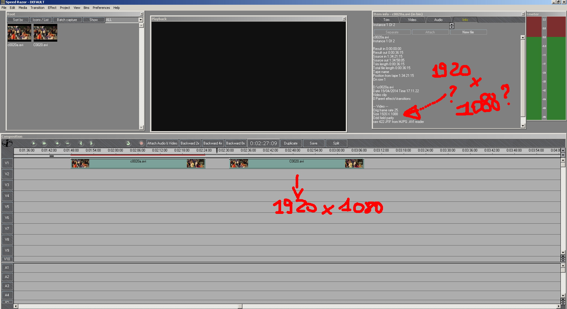

  4. c0020.avi was 1920x1088 to begin with
    Stream #0:0: Video: mjpeg (MJPG / 0x47504A4D), yuvj422p(pc), 1920x1088, 1051
    37 kb/s, 25 tbr, 25 tbn, 25 tbc
    This probably means you made mistake in vdub before ffmpeg step

  24. I wonder why morgan does the 1088 ? Maybe you can do some hexedit magic? jagabo knows all about this AVI header stuff see this thread or PM him . Maybe you can upload a morgan sample and ask him to look at it
    https://forum.videohelp.com/threads/315409-bad-video-dimensions-information
  25. I don't know very well, the only problem with morgan is when I use a file generated with virtualdub with the morgan codec as source for ffmpeg. Virtualdub produce 1080, but ffmpeg interpreter as 1088
    in the mediainfo, with morgan, appean "original height" 1088 but until I don't give it to the ffmpeg I don't have problem with 1080/1088
    maybe I pass directly to the PIC and goodnight to morgan
