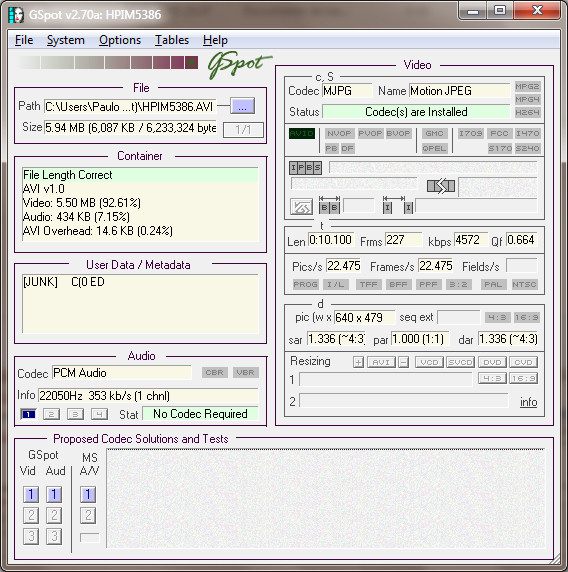

GSpot
I'm now using ffdshow (I didn't knew it also decoded MJPG) but it still doesn't play on Media Player.

There's something bizzare about your file, Mediainfo says your file is 640x480, yet gspot says 640x479.... weird -
I'm betting it might be something wrong with gspot. I've been using it less and less. It already has a number of bugs (some that I've mentioned before) and hasn't been updated in years.
Besides Gspot, how do you even KNOW that your file IS 640x479?

first time I noticed it was when virtualdub warned about that. it's not a gspot bug. I only installed it now because poisondeathray asked what info appeared on it and I already knew the video was 640x479 before.Originally Posted by Cornucopia

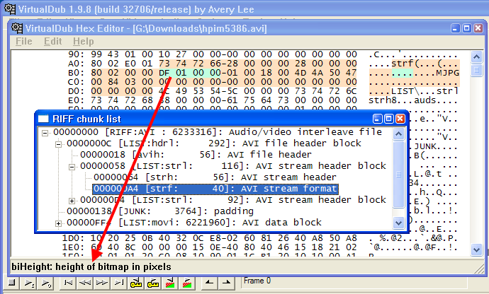

The AVI File Header says the frame is 640x480. The AVI Stream Header (the header for the video stream) says it's 640x480. The Avi Stream Format chunk says it's 640x479. All the tools I tried had no problems dealing with the file as is. I changed the file so that all the headers indicate 480 or 479. See if either works:

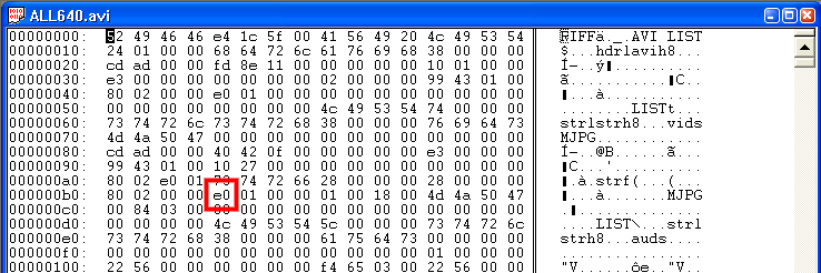

I used a hex editor and changed the byte at offset b4 from df to e0:Originally Posted by bl88drg
Note that's a zero in "e0", not the letter o. All the videos from your camera should have that same field in the same location. -
jagabo - how did you know to change that exactly?
I didn't see the sign saying "hey it's width parameter here"
i.e what steps or clues suggested to change that and to that specific value? -
I'm pretty familiar with AVI structure. I used VirtualDub's hex editor which also has a RIFF chunk tree view:
The chunk is highlighted in orange, the field in green, the name of the field and description are at the bottom of the hex editor window "biHeight...". The field is a 4 byte value in little endian format:
Code:DF 01 00 00 --> 000001DF = 479

ok... I knew VirtualDub had a hex editor. I didn't knew was that it was able do identify the diferent information "areas" of the AVI files.
