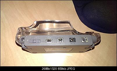

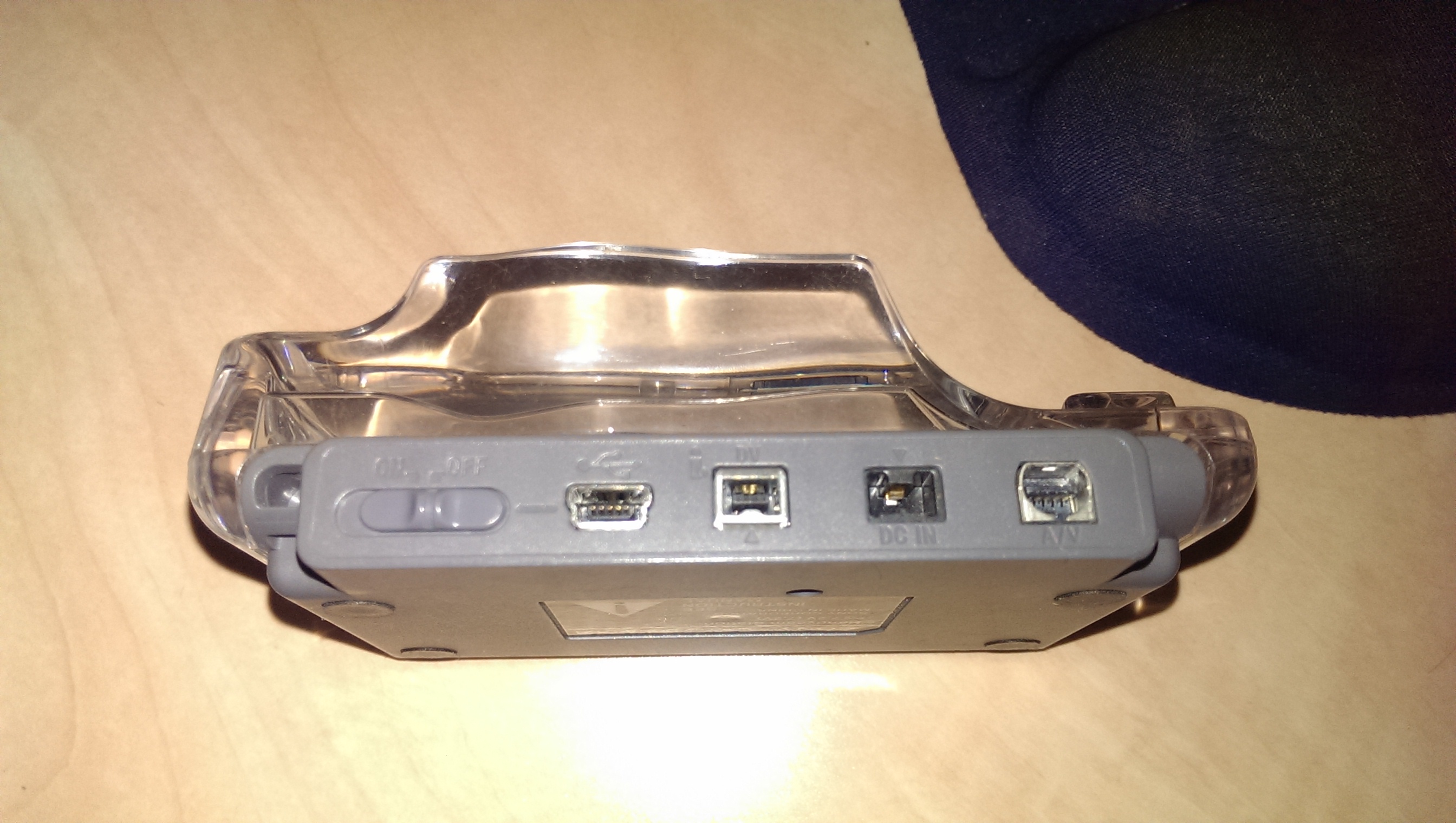

  10. Click image for larger version
Name:	2014-03-14 17.18.29.jpg
    this is my connections
  11. Member PuzZLeR's Avatar
    Oct 2006
    Toronto Canada
    Pretty much covered in this thread, but maybe this will help too.
    Get a firewire (or IEEE1394 or iLink) cable. Your camera has a port for it, which should be a 4 pin connector. Your computer should have one that is 6 pin. If your computer doesn't have an interface for one, then get one as was mentioned. If you have no clue what this is, don't worry, almost anybody in an electronics chain store will find one for you - even the idiots there should know this.
    (I'm only calling some of them idiots because it's their job to know stuff that many there DON'T. But a firewire/IEEE cable, or computer adapter for one, should be easy for them to find).
    Once you set that up, just download the free software called WinDV, and it will be easy. You would record it to the DV format, which is fine in an *.avi file, and will be roughly 13GB per hour. This would be the best bit-for-bit quality that you will get for your tapes. It will be a direct digital->digital transfer.
    Your Easy Cap was not set up for this. You may have been told it can record it, which may be true, but it will NOT be the highest quality. The only way it can do it would be digital->analog->digital and lots of information lost along the way.
    If you have VHS, you didn't buy the Easy Cap for nothing. You can use it for that. However, if you bought an Easy Cap that is not the real one described here at ezcap.tv, then throw it away anyway because it's a fake and likely garbage regardless.

  12. Member PuzZLeR's Avatar
    Oct 2006
    Toronto Canada
    Hi Ofir, just read your post as I posted mine.
    Yes, you have a connection as described. The one marked "DV", which is 4 pin. My last post, and other posts in this thread, should be all the info you need to get started.

  14. Member PuzZLeR's Avatar
    Oct 2006
    Toronto Canada
    Yes, in case it's confusing, just use the port marked "DV", and attach that one with the sufficient cable to your computer using the correct interface. In this case, ignore the USB one (the one with the tree-like graphic) and ignore the one marked "A/V" and only use the "DC IN" for power.
