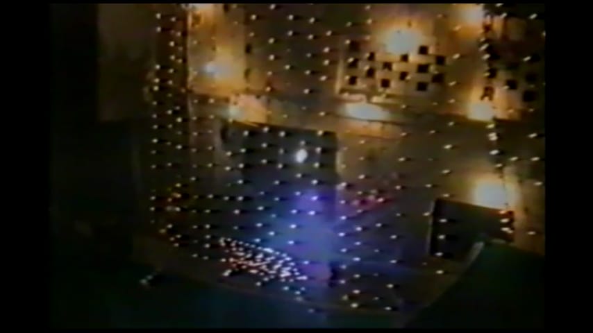

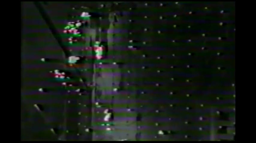

    Apr 2021
    Islamabad
    Hi
    when i capture movies From handycam through EASYCAP to my pc (usb shape common easycap) then quality are perfect but when i capture from VCR so found colorfull strips or sometime black n white recording..
    Am i face ths problem due to old model vcr or fake easycao..?
    ..plssssss help
    1_captured with easy cap
    2_captured with vcr

  22. Originally Posted by Suny View Post
    Hi
    ..plssssss help
    2_captured with vcr
    Please tell me, how you solve this problem with easyCAP USB 2.0? I have this problem too
