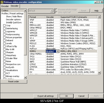

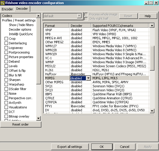

  2. Is MJPG enabled in ffdshow's vfw configuration? It seems to be disabled by default. Enabling it should allow VirtualDub to open the file directly. Or hopefully via AVISource. Is the file type AVI?
    I don't quite understand the reference to h264/avc encoded video if the fourcc is MJPG. ffdshow doesn't have a h264 encoder. At least not these days.

    if you scroll up to the top, you should see h.264/avc as the first. i manually disabled *all* the remaining codecs in that list. since there is no "property" page to make any final adjustments to any of the codecs, i assumed that when in capture mode, all codecs are "I" frame or as lossless as they are set to in ffdshow.
    after i finish a capture, i can open the avi directly in vdub but as i said the info screen reports it as MJPG, which is confusing me. and avisynth won't open it in avisource() either. i assume that h.264/avc is included as an encoder like all the codecs in the list, as they are listed like in your post.

  6. Originally Posted by vhelp View Post
    Your video is MJPG not AVC.
    AVIsource(video) = "couldn't locate a decompressor fourcc MJPG" error.
    not sure if anyone has reported this but it seems that the latest version of ffdshow is borked, since all the codecs are saving to MJPG.
    That list is decoders, not encoders. Go to the Encoder tab and you'll see that all the encoders except a few have been removed. You need to revert to an version from a few years ago to get the other encoders. There's a post around here somewhere that points out the last ffdshow that includes the other decoders.

    i just had another look and it seems i made a mistake misreading the tabs. the defalt codec is mjpeg at quality 85, but all the while i was looking at the decoder tab while chooseing h.264/avc as the enocder.
    sorry for the confusion.

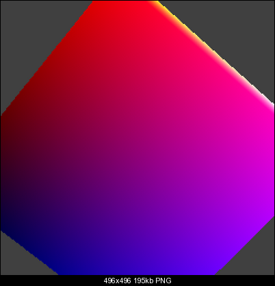

  11. Here's a sample from VirtualDub's built in RGB cube test video:
    Original RGB24:

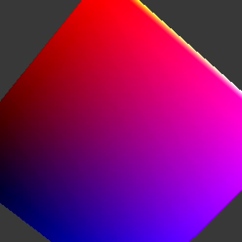

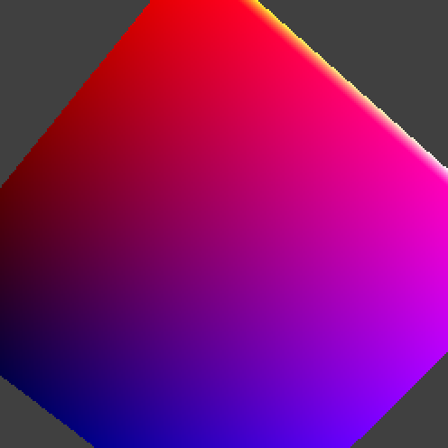

    ffdshow MJPG 85:
    You can see DCT ringing artifacts, posterization/block artifacts, YV12 chroma subsampling blurring. The colors are a little different because MJPG uses a PC.601 matrix to convert RGB to YV12, but I had ffdshow set to output YUY2 and VirtualDub used a rec.601 matrix to convert to RGB for export.
    And yes, since most delivery formats use YV12 and MPEG family compression, they're full of such artifacts already.
