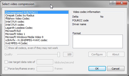

  1. hi. i use virtualdub to re-encode my videos. The method of compression which became the favorite was ffdshow for reasons which value and options consistently outweighed all the other codecs in virtualdub. the wide selection of optional codecs within ffdshow itself for the re-encoded video within virutaldub as well as an option to enter a numerical value for the bitrate was also a huge + in terms of properly gaging the size and quality of the final re-encode as well.
    unfortunately after updating ffdshow i learned most of those options are gone. i became used to using the bitrate option (which had a slider too), there was also a slider option tabbed under mode for "quality" as the latest version of ffdshow still has but, too often it is more difficult than not to gage the actual size of the re-encoded video without the bitrate option so that as well as the loss of codecs within ffdshow is leaving me with incredibly large file sizes.
    i used to put them through mediainfo to gage the quality, it almost seemed a misnomer to have a standard 1-100 quality option without an actual choice of usable codecs.
    anyway, it was my preffered method and really hoping i don't have to change it. i uninstalled the latest version of ffdshow and installed previous versions but nothing seemed to work. anway anyone could possibly offer some help so i can get it back the way it was? i attached some screenshots. not sure what to do but need help. im pretty sure i was using the h264 coded before, but don't even remember how to set it up. any and all help is appreciated.
    i would just use another codec through virtual dub but again ffdshow was the most flexible for me. thank you.

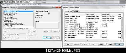

    From all the links I have found they have been removed as you mention. The new VirtualDub version (1.10.3 beta) is moving toward using external
    encoders such as FFMpeg, NeroAAC, MP4Box, etc. It is fairly easy to set up, especially if you download a Script (xxxx.vdprof) file that you just import and put all the encoders in one area. Using this method, you can convert straight to MP4, Mpeg2, FLV, AVI, etc.
    Like you, I use VirtualDub a lot and use it's codecs as well as the external ones. Basically, now you have 3 choices, load a codec pack that contains VFW codecs ( and that's a lot of unnecessary codecs to install), load just the VFW codecs used by VirtualDub that you need (AC3, AAC, MP3, Divx, Mpeg2, Xvid, X264, WMA,etc.) or set up external encoders that do all like FFmpeg. Below is typical, VFW codecs on left, FFMpeg , MP4Box, NeroAAC on the right.
