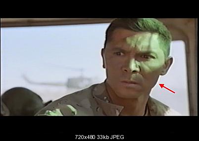

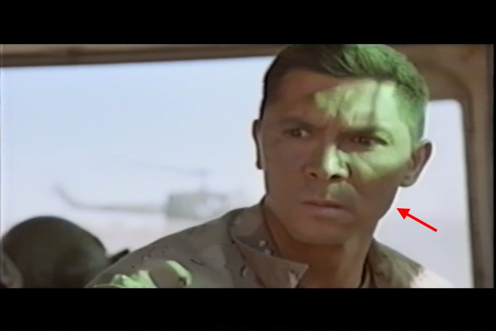

  5. Originally Posted by dianedebuda View Post
    jagabo, can you point me to somewhere for a visual definition of "oversharpening halos"?
    Look at the bright band between the guy's chin/neck and the sky in the background. At the other side of his head you can see light and dark halos as the picture transitions from light background to his darker head. VHS is an inherently low resolution format so many players try to sharpen the picture during playback. The result is usually halos like this. They are hard to get rid of so it's best to use a player that doesn't generate them in the first place. If you want to sharpen the picture you can do much better in software. Also disable the any sharpening filters of your capture device. They are usually ineffective for VHS capture -- just increasing the noise. And turn off any noise filtering (except 2d or 3d comb filters for removing dot crawl artifacts) as you can do much better in software.
    I guess the issue is how much time and effort you want to invest. If you only want to quickly capture and write to a DVD, without doing any processing, you'll want to use software that encodes directly to MPEG and adjust the capture device's and software's settings to get the best picture you can while capturing. But you will only get mediocre quality. If that's all you want you're better off getting a standalone DVD recorder. It's much easier and will give you similar, even better, results.
    If you're willing to invest the time learning how to process your video you can get significantly better quality capturing with a lossless codec like Huffyuv, filtering, then converting to MPEG 2 for DVD. If you're willing to spend money -- get a good S-VHS deck with built in line TBC, or try using a DVD recorder with a line TBC function as a passthrough. Ie, pass the composite or s-video signal through the DVD recorder (without using it to record to DVD) to the capture card.

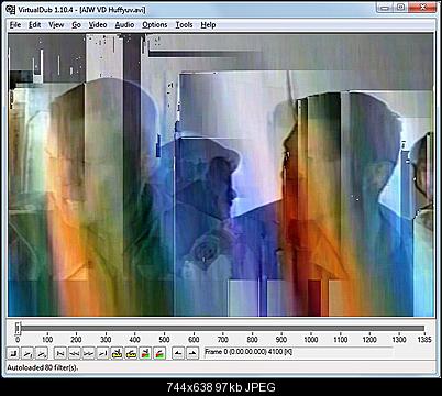

    Using Huffy 2.1.1.

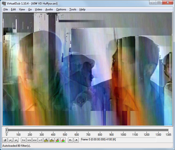

    That's what I have installed but I can't get either of your huffyuv files to display correctly:

    Still not getting the Huffyuv clips to play anywhere but on the box they were recorded on. Really sounds a lot like a problem LordSmurf was having a few days ago. So I'm thinking I'd better reinstall Huffy. Recommended version?

    I use Huffyuv-MT (which coexists with non-multithreaded versions).

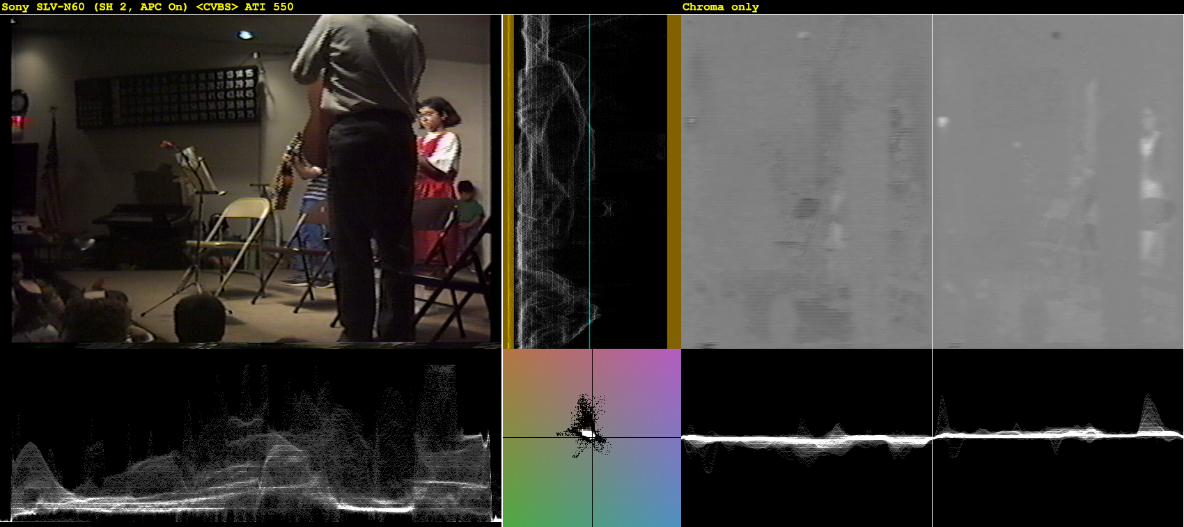

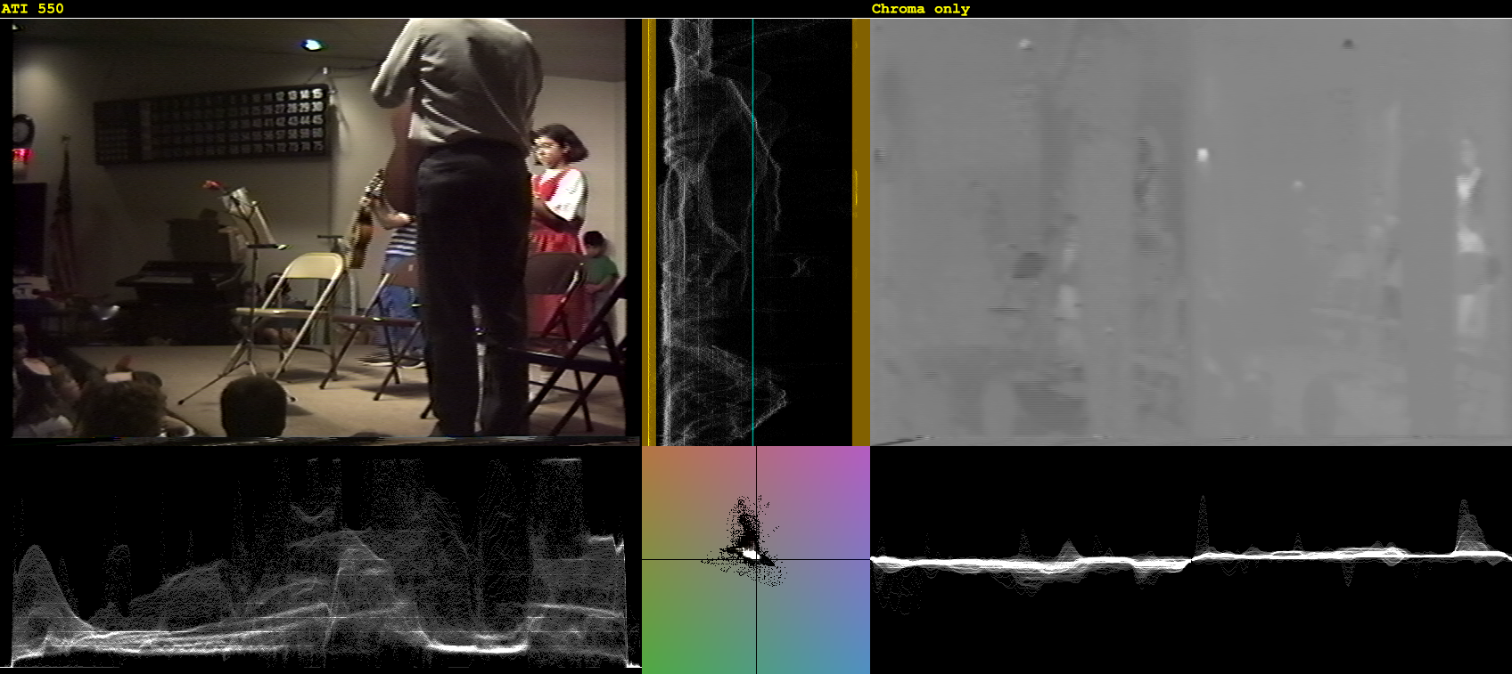

    Ok, what's the proper term for faded image?
    I was going to guess desaturated before I had downloaded the clips, but it's a combination of higher brightness, lower contrast, and slightly lower saturation.
    These aren't the settings I would actually use, but to illustrate the point I attempted to match the DV clip to the 550 with ColorYUV(off_y=-20,gain_y=12,cont_u=32,cont_v=32).
ID:	22934 Click image for larger version
    used default proc amp settings; couldn't get vdub histogram to display
    Did you try the various tricks advised in Oldretiredguy's thread? It seems to heavily depend on your particular graphics system.

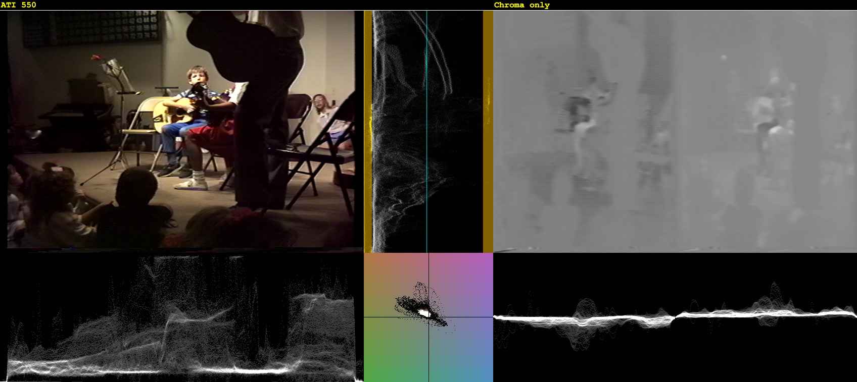

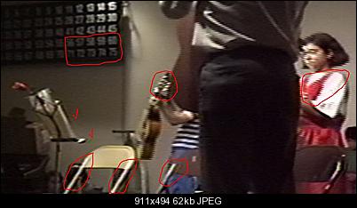

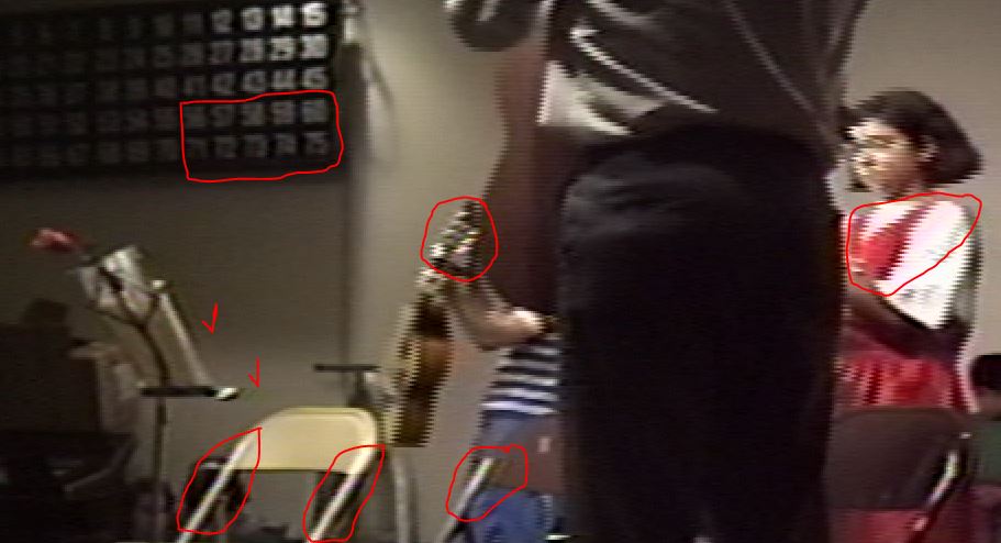

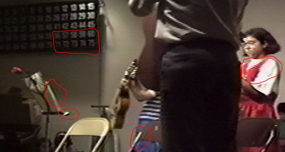

    One VHS issue you're going to want to fix post-capture, which I had never heard of until reading a random post yesterday, is that your hue differs between the odd and even fields (each is recorded and played by its own corresponding video head). Half of the fields are green-tinted and the others are more pinkish.
    Okay, so JVC HR-S7500U.
    V1 = AVISource("vhs guitar jvcs svideo +tbc+r3+svhs, 550 vdub clip1.avi").ColorYUV(off_y=7,gain_y=-15,cont_u=-38,cont_v=-38).AlignExplode("ATI 550",0,0,1,0)
    V2 = AVISource("vhs guitar jvcs svideo +tbc+r3+svhs, aiw vdub clip1.avi").ColorYUV(off_y=4,gain_y=-36,cont_u=-38,cont_v=-38).LanczosResize(714,480).AddBorders(2,0,4,0).AlignExplode("ATI AIW + resize",0,0,1,0)
    V3 = AVISource("vhs guitar jvcs svideo +tbc+r3+svhs, trv480 -tbc DV clip1.avi",pixel_type="YUY2").ConvertToYUY2(interlaced=true).ColorYUV(off_y=-12,gain_y=-10,cont_u=0,cont_v=0).AlignExplode("Sony TRV480",0,0,0,1)
    Interleave(V1,V2,V3)
ID:	22949 Click image for larger version
ID:	22948 Click image for larger version

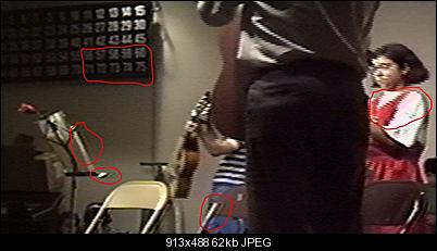

    I screwed up when I was bringing the levels down; there is additional detail to recover in the 550 capture. It has the greatest dynamic range, followed by the TRV480.
    The DV has blocky chroma and rainbowing (cross-color artifacts; the JVC DV file shouldn't have this since it's labelled S-Video). It also features heavy chroma NR (for good or ill).
    The JVC's built-in TBC prevents the TRV480's (apparently) stronger TBC from correcting the bottom of the image. You may want to turn off R3 edge enhancement, as there are certainly halos here.
    I've circled some things you may want to compare in-depth, though you'll have to do it with the originals because I didn't realize how savagely the Snipping Tool abuses JPEG compression. The rainbowing on the chair in particular has been wiped away.
ID:	22952Click image for larger version

    Sony SLV-N60. Different brightness & contrast adjustments to the JVC this time to bring it in line with the widest-range Sony capture.
    V1 = AVISource("vhs guitar jvcs svideo +tbc+r3+svhs, 550 vdub clip1.avi").ColorYUV(off_y=7,gain_y=-55,cont_u=-38,cont_v=-38).AlignExplode("JVC HR-S7500U (R3 On, TBC On) <YC> ATI 550",2,0,1,0)
    V4 = MPEG2Source("vhs guitar sony composite sharp2+apc, 550 cmc clip1.d2v").ConvertToYUY2(interlaced=true).ColorYUV(off_y=7,gain_y=-30,cont_u=-38,cont_v=-38).AlignExplode("Sony SLV-N60 (SH 2, APC On) <CVBS> ATI 550 MPEG-2",0,2,1,0).Trim(1,0)
    V5 = AVISource("vhs guitar sony composite sharp2+apc, 550 vdub clip1.avi").ColorYUV(off_y=7,gain_y=-30,cont_u=-38,cont_v=-38).AlignExplode("Sony SLV-N60 (SH 2, APC On) <CVBS> ATI 550",0,2,1,0)
    V6 = AVISource("vhs guitar sony composite sharp2+apc, DV clip1.avi",pixel_type="YUY2").ConvertToYUY2(interlaced=true).ColorYUV(off_y=-9,gain_y=-45,cont_u=0,cont_v=0).AlignExplode("Sony SLV-N60 (SH 2, APC On) <CVBS> Sony TRV480",2,0,0,1)
    Interleave(V1,V4,V5,V6)
ID:	22958 Click image for larger version
ID:	22959 Click image for larger version
ID:	22960 Click image for larger version
    There are dark halos and the edges don't seem as clearly defined as the JVC; they look "spread out". The JVC's chroma cleanup is also doing a nice job.
    The compression artifacts in the MPEG-2 should be obvious even without any zoom.
    The Sony+550 combination provides the most dynamic range of your combinations. But no TBC (look at the number board & bottom of image).
    The Sony+DV has the same chroma issues as the JVC+DV, though the rainbowing takes on a different appearance.
    Obviously there is no perfect choice...
  27. Member
    Jan 2014
    Austin, TX
    Going to take a bit to digest this, but see an obvious mistake on the naming of vhs guitar jvcs svideo +tbc+r3+svhs, trv480 -tbc DV clip1.avi - there's no svideo input to the trv480, so the name should have been vhs guitar jvcs composite +tbc+r3+svhs, trv480 -tbc DV clip1.avi.
    The trv480's tbc was turned off. trv480 -tbc DV
    Hubby remembers that the JVC composite looked better than the svideo to him with the test tape; I've been though so many interations that I've lost track. I'm finding preliminary equipment decisions made using the test tape not worth a whole lot with the actual tape. Worth making/posting another set of tests? The guitar tape has only a 3-4 min recording on it, so it's pretty quick. I'm worried about tape damage by running the tape too much, but don't feel I've explored options enough yet. Suggested combinations?
    Is the aiw worth considering or inferior to the 550 and trv480 pass-through? Would a better capture card be worth considering? May be impossible to tell, but am wondering about the relative quality of these vcrs compared to what someone like LordSmurf would have. I mean, the whole point of the vhs captures right now is to see what's on the tapes and get the best home capture we can without spending a ton of $. At this point, I'd try another capture card, but not buy another vcr, particurlarly after reading some of orsetto's posts - I just don't have enough tapes to justify the expense. If there's reasonable expectation that LS could do a much better capture because of his expertise & equipment, we'd be foolish not to consider this as an option for our "important" tapes. I have an unfounded paranoia about shipping the tapes though; not particularly frantic about LS losing or damaging tape, but USP/USPS... If we do the home captures before sending, we'll at least have something if my nightmare occurs. Don't want to damage the tapes with our mucking around.
    Even if we do end up sending off the vhs tapes, I don't feel this is wasted effort. We're learning a lot and can appreciate more what a pro can do. It's becoming a project hubby & I are doing together. He was interested in what I was seeing here on the forum and we've gone through oldretiredguy's thread together - weird form of a date?
  28. Formerly 'vaporeon800' Brad's Avatar
    Apr 2001
    Vancouver, Canada
    I'm holding off on examining the Hi8 captures until you have a chance to take in the VHS pros and cons.
    Thought so. Darn I'm good, eh?
    There's no way to connect analog input and analog output to the camcorder at the same time, is there? (I/O uses the same minijack right?)
    Hmm. Well either way, it's correcting the bottom of the image and the JVC's TBC prevents it from doing so (I believe; there is no test file with the JVC TBC off but the Sony test implies this and it would make sense given the way TBC works). I've become obsessed with that area of VHS captures, but you may not care one way or the other about those 9 lines. Most people don't.
    That would be very odd.
    So far it looks like you may as well sideline the AIW because it's clipping too much of the bright highlights. You could try lowering the Proc Amp Contrast control but I suspect it will only bring down the levels without restoring the clipped areas.
    Try it though, and for the 550 too.
    Depends on if there is one that fits a particular definition of "better". In this case I think what you're looking for is one that could possibly exceed the dynamic range provided by the 550. I would try the EZGrabber2 for $13, but I'm me. (Ordinarily I would say VC500 but it seems they raised the price from $20-some to $32). [sanlyn must be gagging right now.]
    I don't think his JVCs would look substantially different from yours (note: my knowledge in that area is extremely weak), but having access to some Panasonic S-VHS machines as well might offer something that yours don't.
    As you can see, the fact that your JVC S-VHS is blowing out your capture cards' levels while the plain-jane Sony is providing more headroom... that's one of those things orsetto was talking about where you end up seriously considering the cheapo VCR to the fancy souped-up deck because of issues with particular tapes/equipment. Pretty annoying, and I don't think I've spent what you have.
    Haha, I love it.
