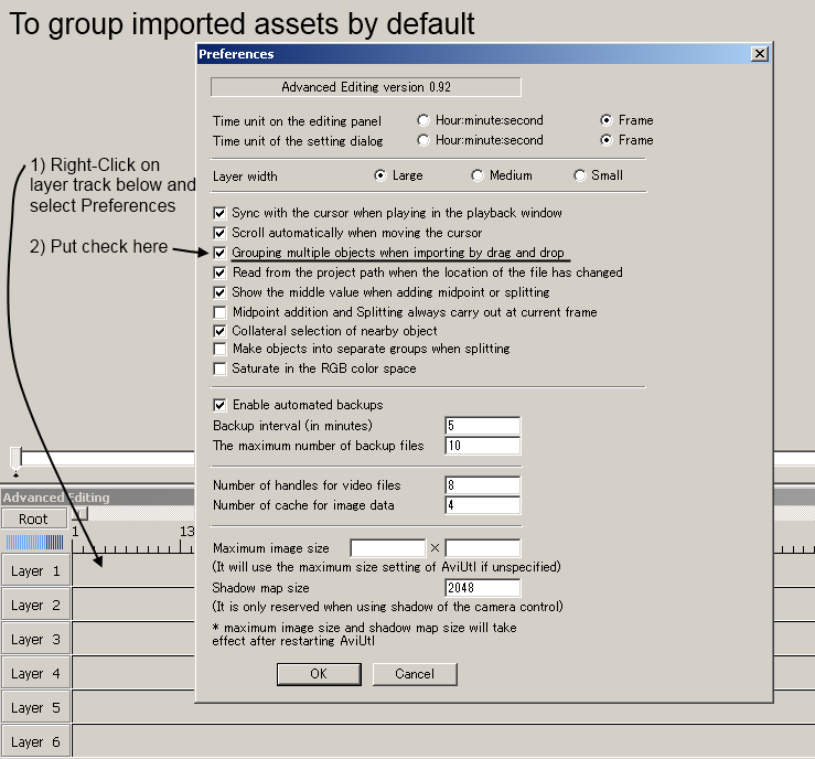

    Played around a little today and managed to create some Blu-Ray compliant streams, as reported by DVDA 5.2 anyway. You need to set the correct frame rate however.
    Example: 24000/1001 (not 23.976) 30000/1001 (not 29.97) 60000/1001 (not 59.94).
    I also figured out how to group imported assets by default, see figure below:

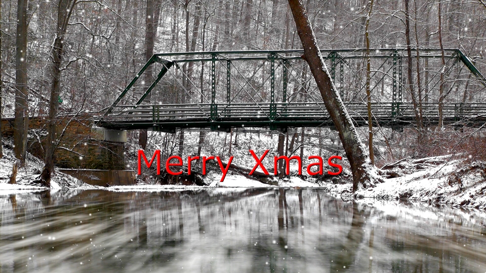

    Just discovered this program has very convincing rain and snow generators. It will come in handy when I edit my next Xmas video............
    Here's a quick example of the snow generator:

    Yeah I used the "Cloud" generator filter, flipped 180 and reversed it to make the effect of melted snow drifting downstream. Very nice effect. I won't post the video, but here is a downsized frame grab:

    All I can say is anyone that thinks you can't create high quality special effects with free s/w, has never tried AviUtl............
    The first attached clip shows before/after my snow effect. The 2nd clips shows AviUtl has no trouble working in 3D space. I like that I can replace images and video references while it saves all coordinate settings.
