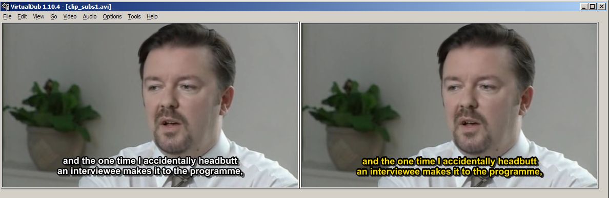

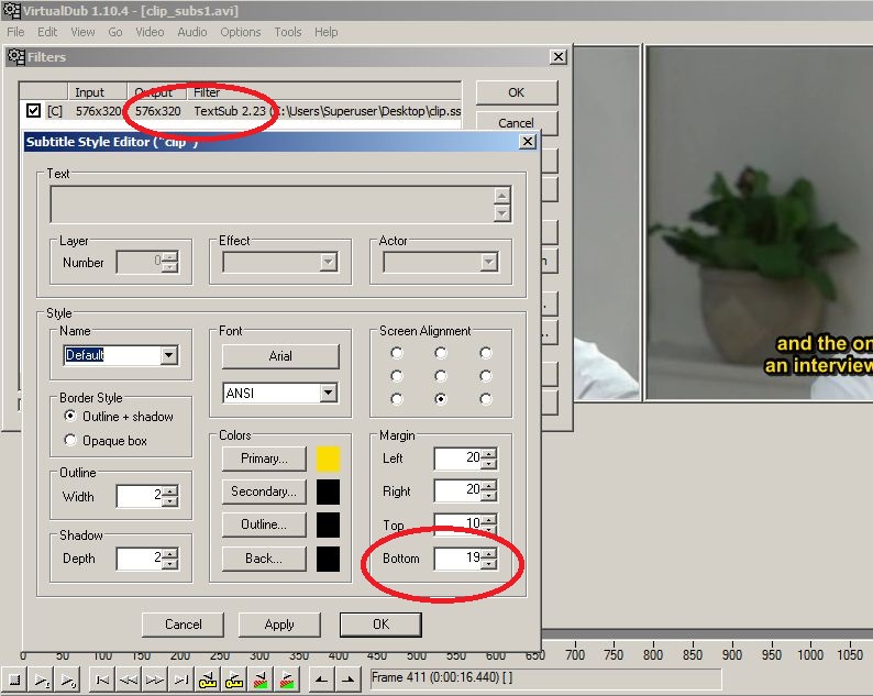

    I have a video with permanent subs (image 1).
    Found a .srt file on-line and, using the default font and size, used SRT to SSA Converter to get an ssa version of the subs.
    Opened the video in VirtualDub and used TextSub 2.23 filter to add the new .ssa file (image 2).
    Note that it took me three tries to get the correct size for the subs to match the original.
    Refined the the output from the converter to get the correct distance from the bottom border (images 3 and 4).

    Strictly speaking, the ssa file is not required.
    The TextSub 2.23 filter can select the font, size, position and colour via thr 'Styles' button.
