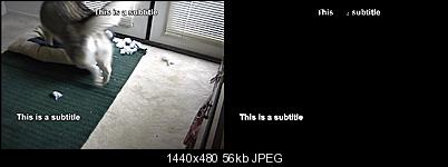

  7. Oops, PDR beat me to it. Here is an concrete example:

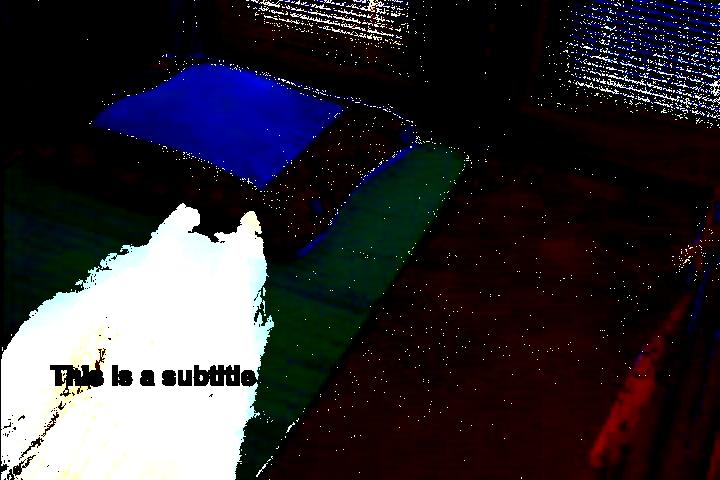

    You can try summing motion masks over several frames. In this video for example the camera and background are still, the dog is moving up in the frame. A static subtitle was overlaid onto the original video:

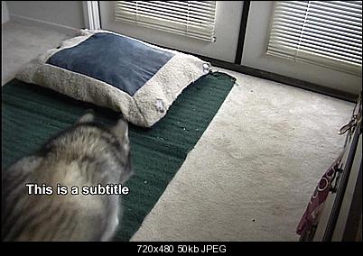

    Original frame:

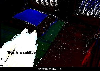

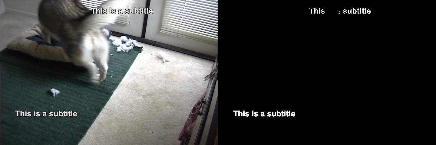

    Single mt_motion():

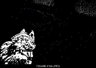

    Eight frames of mt_motion added together:
    To add 8 motion masks together I used:
    Overlay(SelectEven(), SelectOdd(), mode="add")
    Alternatively you could also use:
    mt_logic(mode="or", SelectEven(), SelectOdd())

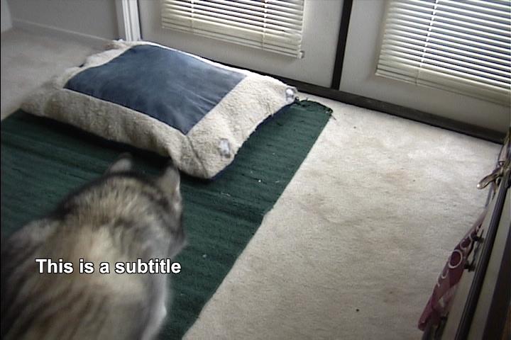

  12. It's very difficult to get the brightness, contrast, and colors of two videos to match well. Getting the two frames to align can be difficult (and often there are non linear distortions so you can't just adjust the frame size, rotate, crop, and add borders -- like time base errors, film bounce, jello-effect, different sharpness, different noise). Even if you manage all of the above there are cases where the subtitles are the same brightness/color as the underlying image.
    So yes, in theory you can simply subtract one image from another and there are your subtitles. In practice you get a multitude of problems.

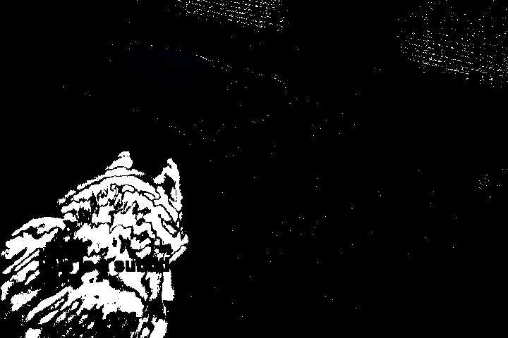

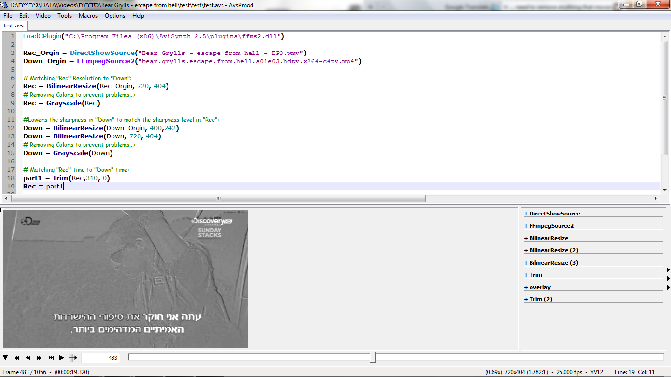

  18. this is what i managed up to now:
    and this is the script:
    LoadCPlugin("C:\Program Files (x86)\AviSynth 2.5\plugins\ffms2.dll")
    Rec_Orgin = DirectShowSource("Bear Grylls - escape from hell - EP3.wmv")
    Down_Orgin = FFmpegSource2("bear.grylls.escape.from.hell.s01e03 .hdtv.x264-c4tv.mp4")
    # Matching "Rec" Resolution to "Down":
    Rec = BilinearResize(Rec_Orgin, 720, 404)
    # Removing Colors to prevent problems...:
    Rec = Grayscale(Rec)
    #Lowers the sharpness in "Down" to match the sharpness level in "Rec":
    Down = BilinearResize(Down_Orgin, 400,242)
    Down = BilinearResize(Down, 720, 404)
    Down = Grayscale(Down)
    # Matching "Rec" time to "Down" time:
    part1 = Trim(Rec,310, 0)
    Rec = part1
    Test1_RecDown = overlay(Rec,Down,opacity=0.5)
    Subtract_RecDown = Subtract(Rec,Down).Trim(0, 1055)
    return Subtract_RecDown
    I tried to make this technique ..
    It does not work so well ..
    I attached rar file containing the attempt + videos:
    https://www.dropbox.com/s/vqhvhtpn8jrr0bg/attempt1.7z
    What could improve the result?
