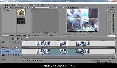

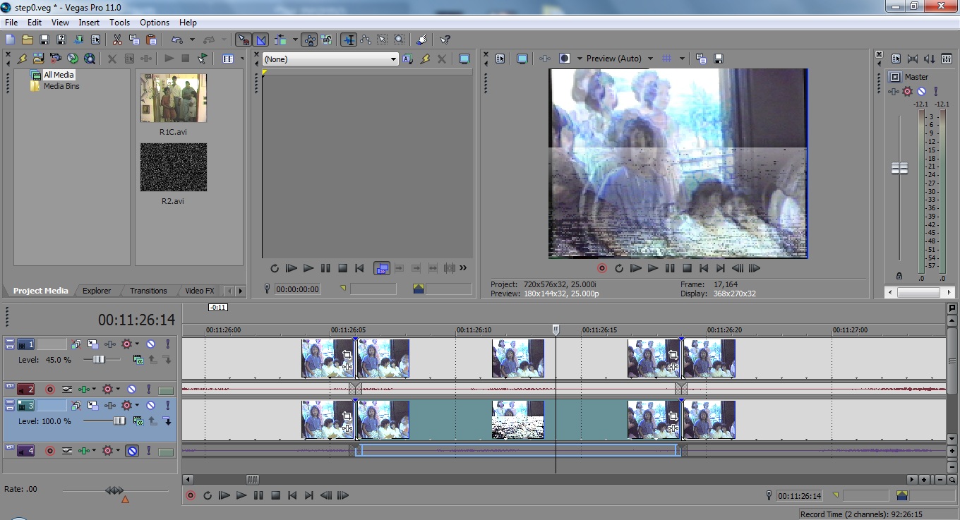

    the trim part is the most hard part to do... in sony vegas it is very easy.
    how can know fast what number i need to write in the trim(X,0) ?
  14. Originally Posted by gil900 View Post
    Open the two video and find some obviously identifiable frame. Subtract the frame number of one from the other. For example if frame 55 in video1 corresponds to frame 37 in video2, then trim 18 (55-37) frames off the start of video1.
  15. Originally Posted by jagabo View Post
    I know this technique ..
    I will try to develop a technique that uses sony vegas
    EDIT:
    I succeeded invent a technique that uses sony vegas!
    Now it 's so easy to not have
    even to calculate anything!

    this is what i do with My Script log file:
    i am using the times in my log file that the script create from the DupMC() log for vegas to know where to easily replace frames
