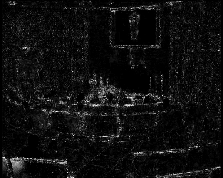

    Using photoshop I created a mask which targets the dot crawl infested areas, while leaving most of the rest of the image intact (at least, that is the general idea).
    The script which I am using now (shamelessly ripped from yours, sanlyn):

    I have attached the sourcefile for the mask.

Name:	Dot crawl mask.bmp
  12. It looks over filtered to me. Personally, I would lower the sharpening and some denoising
    The mask usually doesn't need to be that fine or particulate. You might miss areas on the mask because the nature of dotcrawl - it tends to move about a few pixels from one field to the next. With a stationary mask, you need to cover all those areas . Even with mt_expand, there are "grey areas" that the mask misses . If you want to see the effect of mt_expand on the mask you can set u=128, v=128 . mt_expand(u=128, v=128). I would have just drawn a few boxes, and left larger areas unaffected . For example, the curtains are largely unaffected, but have quite a bit of involvement in the mask. Same with the brick wall. Assuming the curtains don't move later, you can completely mask that section off and replace it with a still frame.
