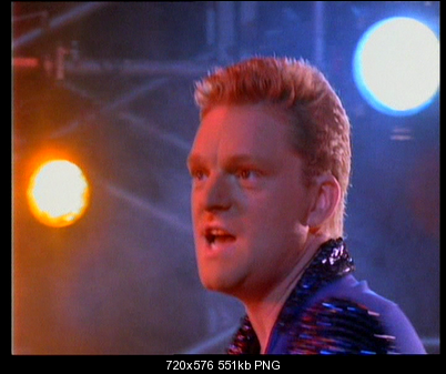

    Here is a screenshot of what I am trying to fix.
    I attached a 20 second sample of that VOB.
  2. You can use the usual dotcrawl filters (checkmate, tcomb, etc...), but they can be quite damaging at the strengths required to eliminate the dot crawl in this sample
    One approach is to use a heavily filtered version and apply through an edgemask, so only the regions around edges are filtered preferentially , less damage to the other areas
    I didn't address any of the other issues ; just suggesting one way you might approach the dotcrawl . As usual adjust to your tastes
Name:	88 filtered.png
    main=MPEG2Source("VoulezVous[PAL][Sample].d2v")
    main
    checkmate
    bicubicresize(480,360)
    spline36resize(720,576)
    lsfmod
    filtered=last
    main
    mt_edge().mt_expand
    mymask=last
    mt_merge(main, filtered, mymask)

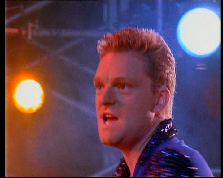

  5. Using the above script along with NeatVideo.
    Before:
    After:
    I have also attached a 23 second AVI video sample. It is in CineForm Codec.

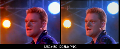

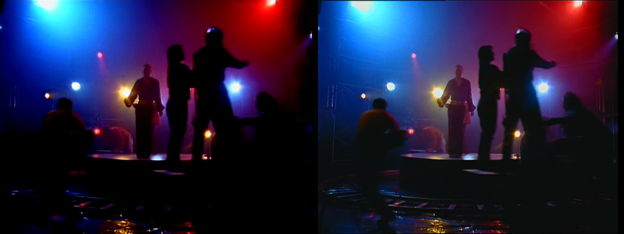

    I worked up a quick mkv from your original post <gasp> Seems every time I see an interesting thread, interruptions pop up. So I didn't have time to clean the mkv's borders as I would want. I learned much from poisondeathray's script (been trying to get a handle on masktools for months!). Your sample2.mpg was of interest because it illustrates why many people dislike NeatVideo. Complaints about fine detail destruction and plastic effects are common. I use it, too, but not the way it was used in sample2.mpg. And even NeatVideo needs a little prep beforehand.
    The images are 1280x480. Click on 'em to display full-size.
    sample2.mpg on the left, the mkv attached below on the right: the mpg wasn't prepped for some annoying artifacts/problems before hitting it with NeatVideo, so the effects are crushed and mottled darks, loss of fine skin contours and detail, rough edges, mosquito noise, chroma bleed, oversharpened edges that look blurred, oversaturation (blooming) and posterization effects.

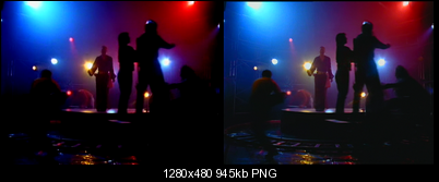

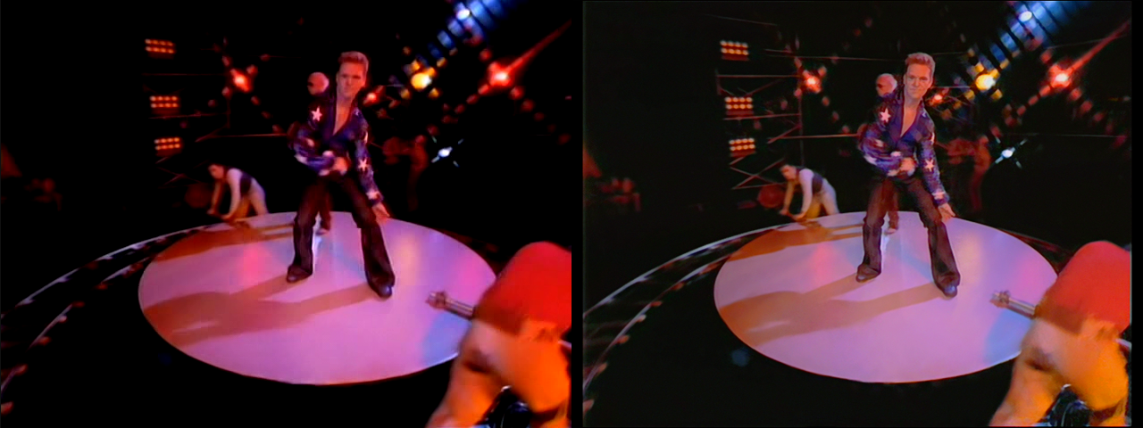

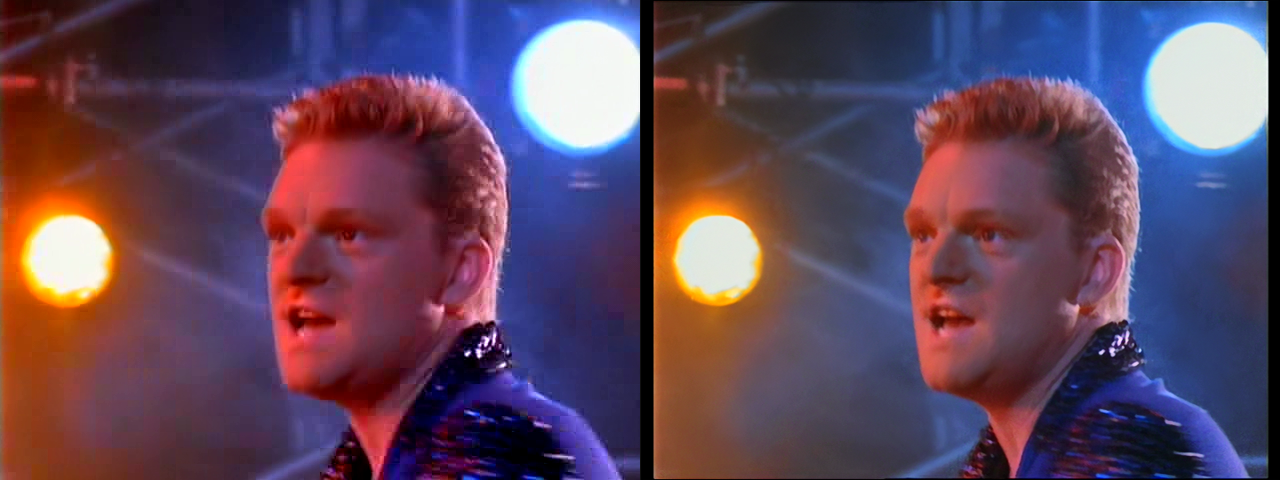

    Many darks are crushed beyond repair, but fixing levels helped rescue some of the dark stuff. Trying to remove 100% grain is not a good idea all video, as it destroys fine detail and contours, and looks rather unnatural or animated. The mkv frame on the right shows how much dark and inner detail is missing from sample2.mpg, which is starting to look like anime. This image and the one below it also show some serious halo and ringing effects from oversharpening, much of which are subdued in the mkv. Color blooming (oversaturation) is another problem, and looks worse on TV than on computer.

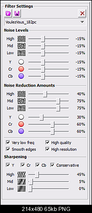

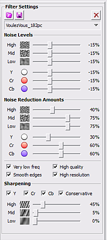

    I took my NeatVideo noise sample from the blue right-hand side of frame 182. Here are the NV noise reduction settings I used, which are fairly typical in my projects. Some low-power cleanup was all that was needed after running the script:
