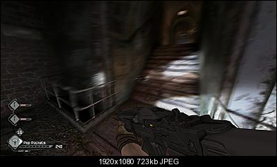

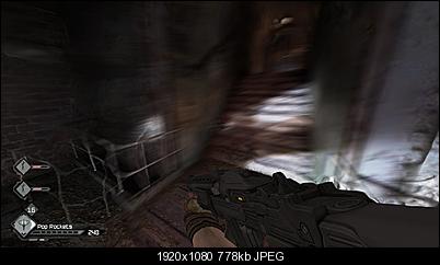

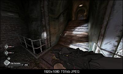

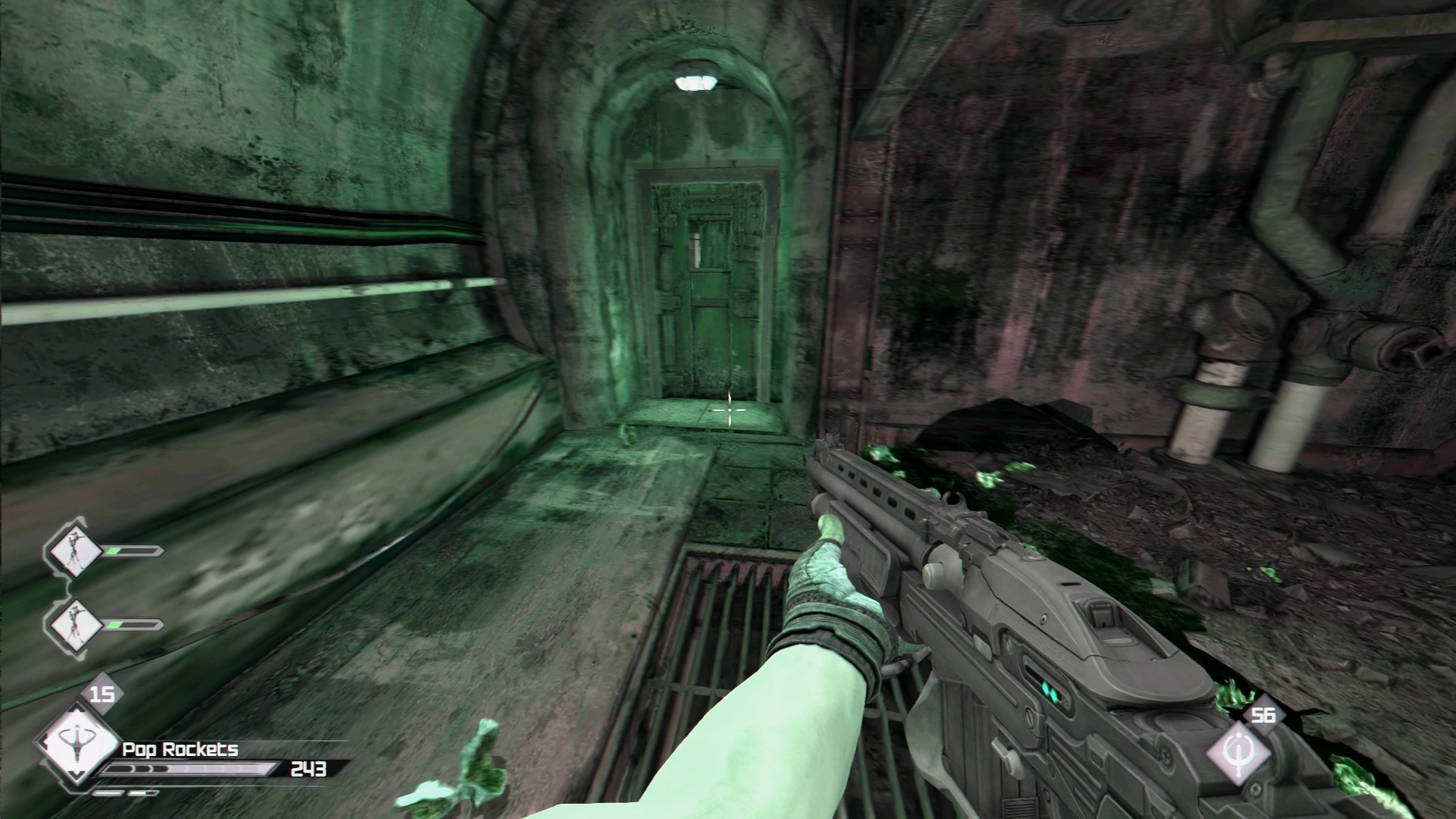

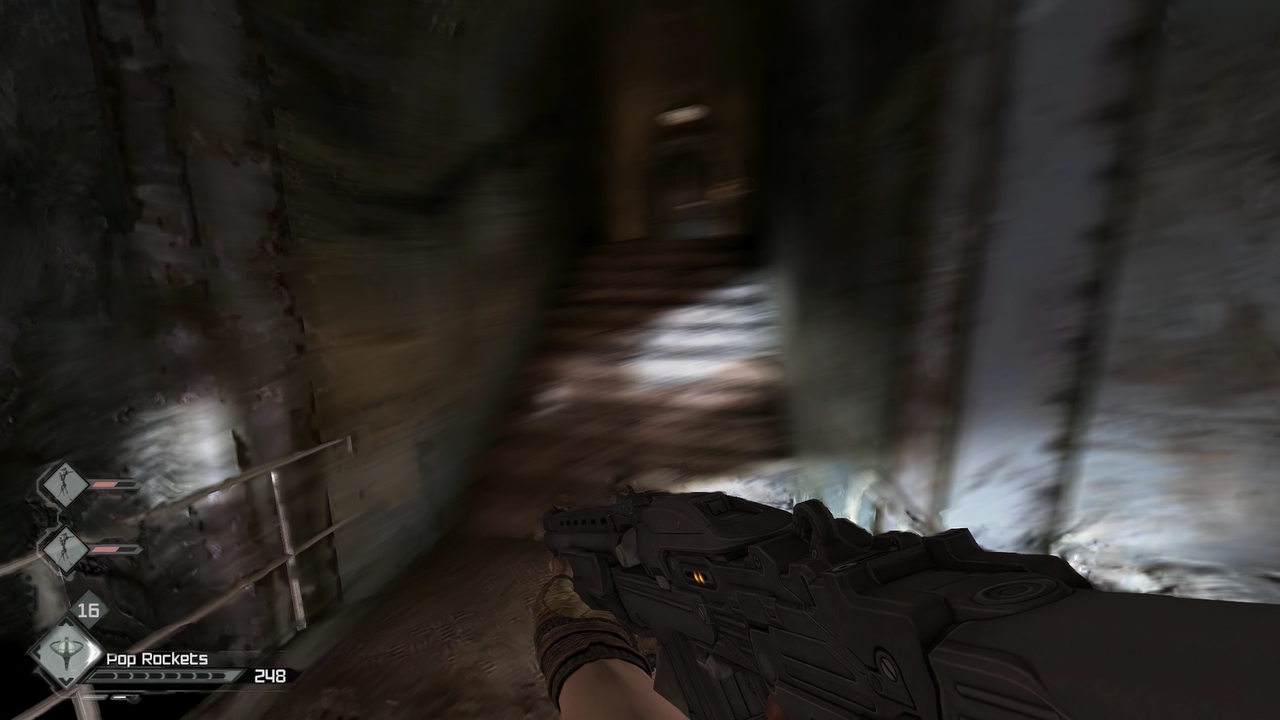

    Here's two screenshots when both are turned up pretty high to show what I mean:
    Merged from 1920 to 120fps:
    Script in topic with blur=60

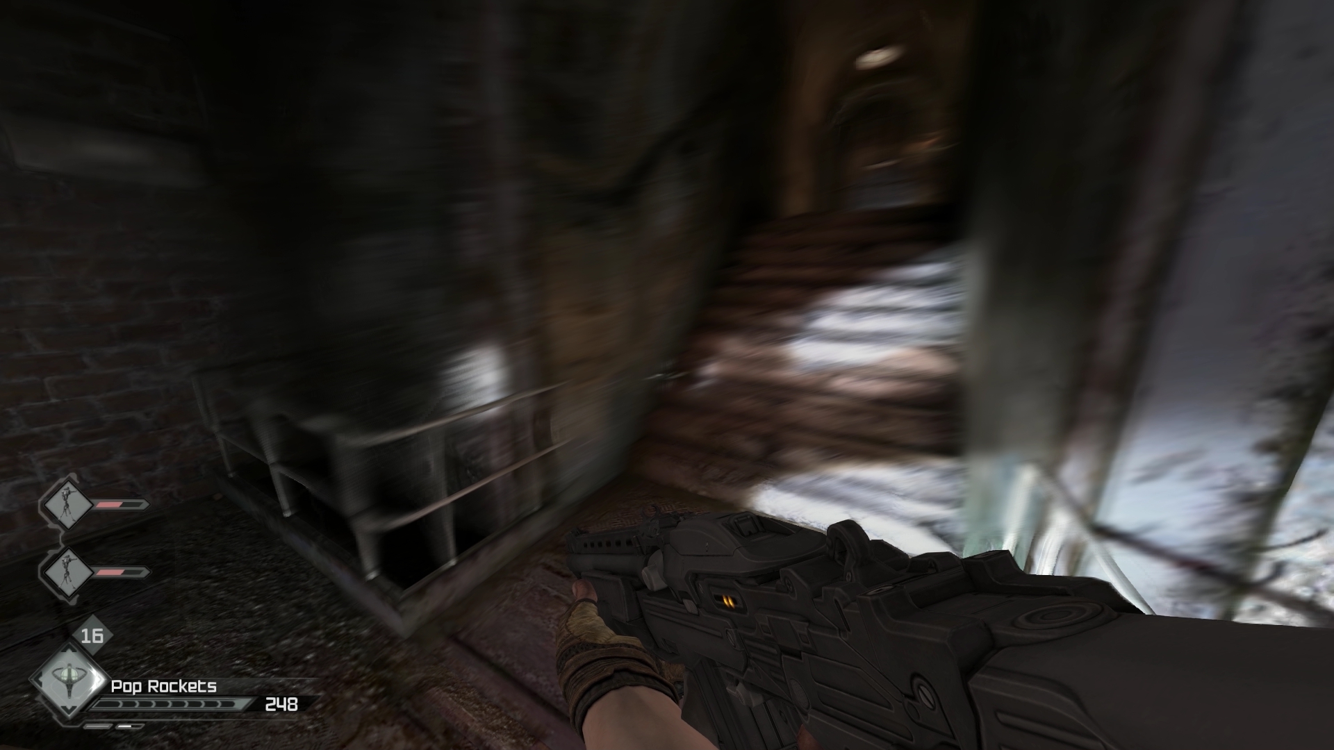

    Here's one with SmoothFPS2() (without the MBlockFps() part) and MFlowBlur(super, backward_3, forward_3, blur=60, prec=1), more stretched out than with my settings but the warps is smoother and will probably stand out less when the video runs at full speed.

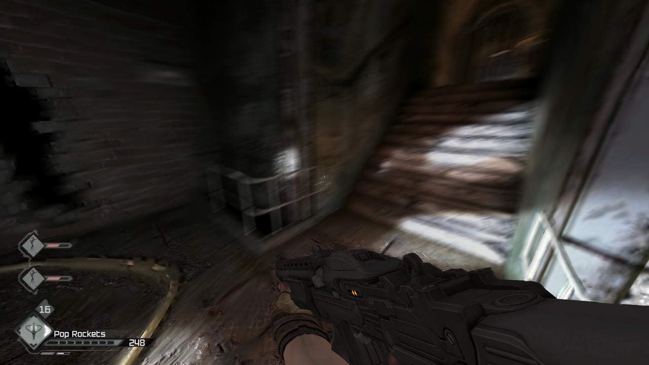

    TemporalSoften seems to work way better than merge:
    Like this:
    SmoothFPS2(3840,1).TemporalSoften(5,255,255,0,2)
    SelectEven().TemporalSoften(5,255,255,0,2) # 1920
    Selectevery(64,0)
    Might look better with just stronger TemporalSoften when it's at 3840fps but I can't find any good documentation on the parameters. Where can I find that? Like the limitations for radius, because when i crank that up to like 30 nothing seems to happen.

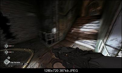

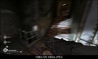

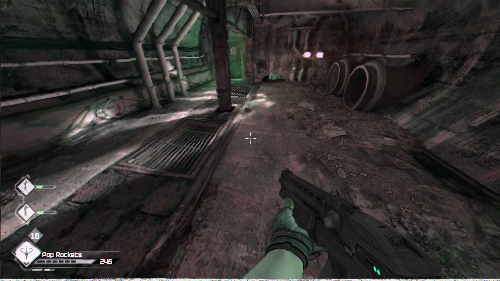

    I've tried it before and it creates weird blocks that's completely clean when the motion is high.
ID:	20703Click image for larger version
ID:	20702Click image for larger version
    This is with the best settings i've come up with.

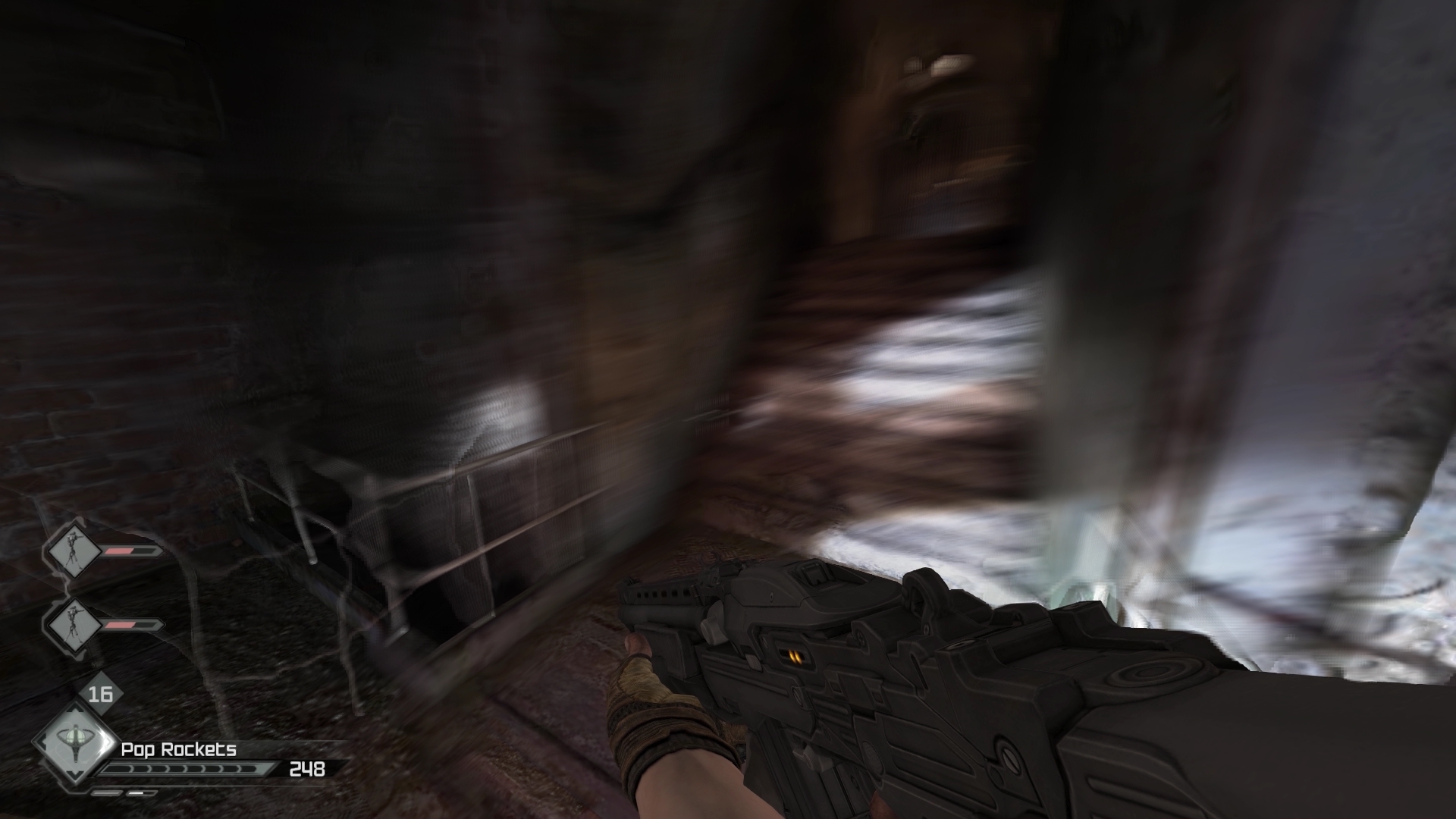

    There's some weird stuff going on:
    setmemorymax(1024)
    setmtmode(5,4)
    AVISource("Footage.avi", audio=true).AssumeFPS(60.000).converttoYV12
    setmtmode(2)
    super = MSuper(pel=4, sharp=2, rfilter=4)
    backward_vectors = MAnalyse(super, overlap=4, isb = true, search=3)
    forward_vectors = MAnalyse(super, overlap=4, isb = false, search=3)
    MFlowBlur(super, backward_vectors, forward_vectors, blur=50, prec=1)
    SelectEvery(2,1)
Name:	mpc-hc 2013-10-22 11-01-31-60.png
ID:	20724Click image for larger version
Name:	mpc-hc 2013-10-22 11-00-59-97.png
    These frames are not only weird looking, but they also appeared randomly in the video, completely out of the correct frame sequence order.
    SelectEvery(2,1)
