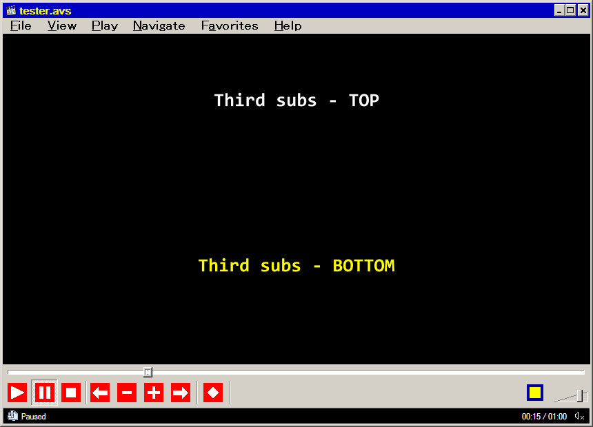

    Format: Name, Fontname, Fontsize, PrimaryColour, SecondaryColour, TertiaryColour, BackColour, Bold, Italic, BorderStyle, Outline, Shadow, Alignment, MarginL, MarginR, MarginV, AlphaLevel, Encoding
    Style: LowSubs,Consolas,32,65535,65535,255,0,-1,0,1,1,1,6,40,40,320,0,1
    Style: HighSubs,Consolas,32,16777215,16777215,255,0,-1,0,1,1,1,6,40,40,80,0,1
    [Events]
    Format: Marked, Start, End, Style, Name, MarginL, MarginR, MarginV, Effect, Text
    Dialogue: Marked=0,0:00:02.50,0:00:05.50,LowSubs,NTP,0000,00 00,0000,!Effect,First subs - BOTTOM
    Dialogue: Marked=0,0:00:08.04,0:00:11.51,HighSubs,NTP,0000,0 000,0000,!Effect,Second subs - TOP
    Dialogue: Marked=0,0:00:13.90,0:00:16.50,LowSubs,NTP,0000,0000,0000,!Effect,Third subs - BOTTOM
    Dialogue: Marked=0,0:00:13.90,0:00:16.50,HighSubs,NTP,0000,0000,0000,!Effect,Third subs - TOP
    Dialogue: Marked=0,0:00:18.42,0:00:21.27,HighSubs,NTP,0000,0 000,0000,!Effect,whatever.
    Dialogue: Marked=0,0:00:23.52,0:00:26.54,LowSubs,NTP,0000,00 00,0000,!Effect,whatever.
    Result:

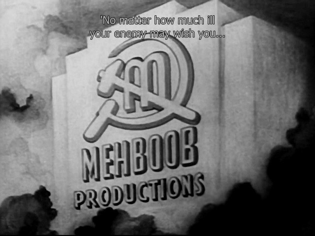

  7. Originally Posted by ssa_newbie View Post
    ...and if I can't get it to work then I'll just do the bottom subititles, create the file, and then do it all over with the file with subtitles for the top subtitles.
    Haven't you already been told that's not such a bright idea?
    Anyway, bottom subs is default. For any you want on top just add:
    {\a6}
    to the SSA file before that line of dialog, as in:
    Dialogue: Marked=0,0:00:00.23,0:00:03.27,*Default,,0000,0000 ,0000,,{\a6}This is how you do it.

    No, the sub I tested on had a style line. And if you were otherwise happy with the SSA file you had, you could have made top subs in Notepad.
    [V4 Styles]
    Style: Style1,Tahoma,60,12303291,8421504,0,0,0,0,1,2,0,2, 60,60,60,0,0
    [Events]
    Dialogue: Marked=0,0:00:05.72,0:00:10.69,Style1,Comment,0000 ,0000,0000,,{\a6}'No matter how much
    ill\Nyour enemy may wish you...
