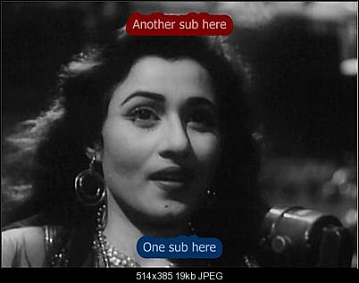

  6. Like I said, I don't use AviDemux, but it's easily done using VDub(Mod) (and also using AviDemux, I'm sure). Create the two sets of subs first with the styles you want, open 2 instances of the TextSub filter, and:

  8. The 'colored box' is just the outline. The ones I showed you have a 10 pixel outline, where they're usually black and 2 pixels thick.
    You can use AutoGK for this by using the CTRL-F8 trick to load the subs. I just tested it out and it works. However, because AutoGK allows the loading of only a single sub, you'll have to combine both languages in the same sub, one in the regular location, one up top. I don't use Subtitle Workshop, so I can't help with that. But only SSA and ASS formats allow for the styles, where you can choose the font, size, colors, positioning, etc. I always use SSA format because that's the one with which I'm most familiar. SRT and the others are useless for this kind of work (without a separate styles file, not honored by many programs).

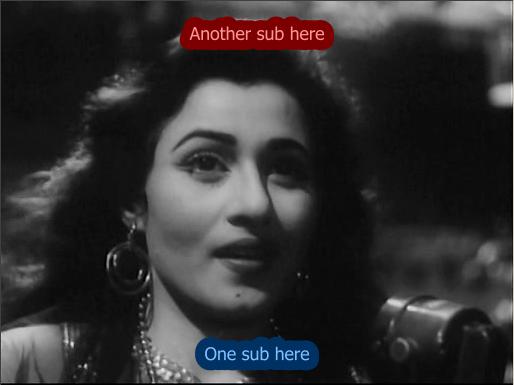

  11. Click image for larger version
    I prefered to work with Avidemux.. but if no one is familiar with it..it's ok.I try to learn vobdub ...I just need someone tell me from the first step ...what to do? how to begin.. to come to the result like this image..
