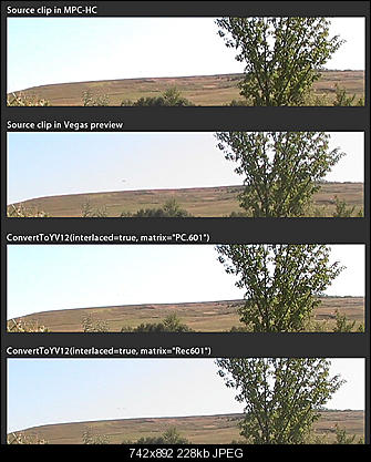

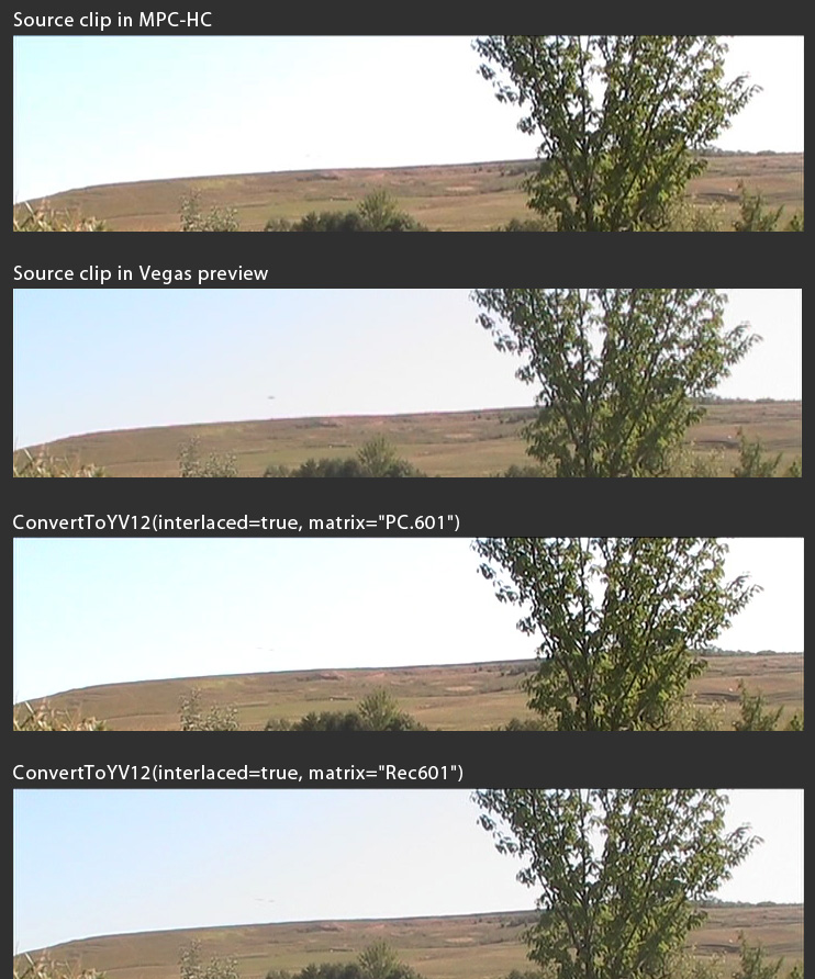

  4. Originally Posted by _Al_ View Post
    oh, it is DV video, which is standard definition, so there should be:
    ConvertToYV12(interlaced=true, matrix="PC.601")
    matrix="PC.601" turns light blue sky into white; the same happens if I open the source clip in mpc-hc
    after converting back to yv12 using matrix="Rec601", it looks like it looks in vegas preview (sky is light blue, not white)

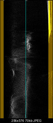

    Above is a source clip opened in avisynth. In the top right of the avisynth histogram, is the sky. It looks like it exceeds 235, which can be fixed with levels filter in vegas, but if I understood sanlyn correctly, it is better to fix it in yuv with avisynth, before it gets converted to rgb after it is imported in vegas or premiere
    DV camcorders very often record out of spec. Often exceeding Y=235 at the top end, and have black levels too high at the bottom end. So you have to be careful to adjust levels before converting to RGB. And be sure to use a DV decoder that can output YUV so the decoder itself messes up the video (Panasonic DV Codec only outputs RGB and crushes brights like in your sample). I recommend Cedocida.
    I think sanlyn said something similar. He recommended to first fix the levels, so that they don't exceed 16-235, compress to lossless yv12, and then import into NLE, so that the conversion to RGB will not clip levels when it maps 16-235 to 0-255. Or convert to rgb with avisynth, and then import into NLE, perhaps because the yv12->rgb colorspace conversion is of better quality in avisynth than in NLEs.
