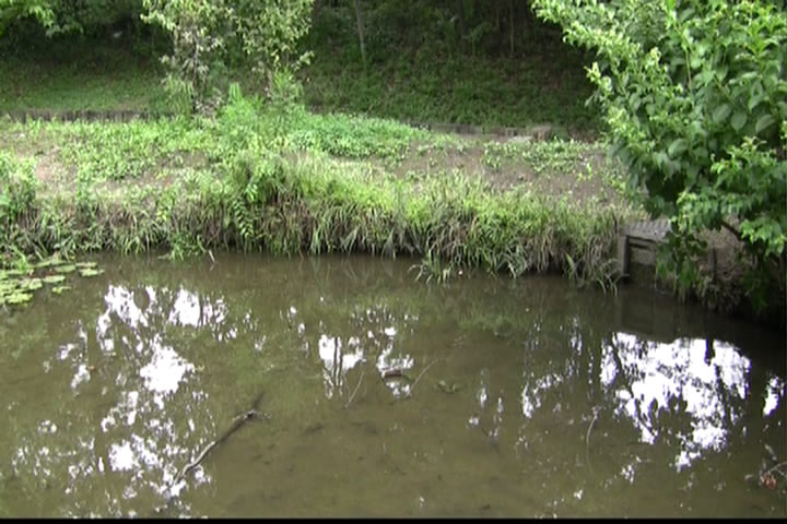

This is a short AVCHD 1080i30 camcorder clip, yadif, lanczosresized 720x400, encoded at 1000kbps. You can find the original here for your own testing and learning: http://www.megaupload.com/?d=9B84U1II
It's a good clip to illustrate what x264's AQ does. Now there is no model here to distract you
. Pay attention to the shadow detail, and details in the water (and under the water). After examining this clip, go back to the FFV1 clip and re-examine that one. If you still can't see the differences clearly, I'll post cropped image to highlight some of the bigger differences.
Not to sound like a broken record, but again this is a single frame just to illlustrate a point, and you should be looking temporally at the whole clip, different frames, different quality measures, etc. etc....blah blah blah....you get the point. Note I only posted AME , but every encoder that doesn't have AQ like functions has similar results (I tested about 20 different ones)

Play with different AQ settings when you do your x264 encodes, and you will learn how it affects different types of content. The general principle is illustrated in both the camcorder pond/tree example, and this FFV1 example. -
In my comparison, DivX preserves more of the original detail over most of the frame. x264 seems slightly blurrier, where it isn't microshifted/distorted. But it's a very small effect. I'm just assuming this is the price to pay for small bitrate savings which can be better used elsewhere.Originally Posted by poisondeathray
The microshifting of fine detail was completely absent in DivX's frame. Is it a result of x264's psy-RDO, or something else? Do you need me to clarify what shifting I'm talking about? (It resembles the shifting you get when you use HQDn3D...)
If I recall what I read about AQ correctly, it helped improve static image quality/detail (presumably at the expense of motion). Sound right to you? -
Yes i agree with what you call "microshifting." I think this is largely from psy-rd. I think --psy-rd 0.5:0 was used. It works to highlight edges and detail, almost like a sharpener. If you disable psy on content with grain for example, you can see much less grain and detail preserved, but if you go overboard, you get ringing and rough artifacts especially at edges. (for example, on the lagarith jagabo sample, I used --psy-rd 1:0, because the encode at --psy-rd 0.5:0 dropped too much of the detail and grain for my tastes). I tend to go with lower values in general, but it varies on situation. I wouldn't be surprised if this specific sequence has a lower psnr value, as psy settings do lower ssim/psnrOriginally Posted by creamyhorror
The new AQ in the recent builds have 3 different modes (as opposed to strength), 1,2,3. They all can redistribute between frames (interframe). Defintely work temporally, not just intraframe. Have a look at the park/pond video below, I included the AQ1.5 and the AME encode to compare. Compare the motion and smoothness temporally.
http://www.megaupload.com/?d=7FKI4R8A
The trade off or "side effects" of using AQ with (normal strengths) is quite minimal on most types of content . It can hurt smooth content like anime, and things like graphic titles, where edges get more ratty, and the "side effects" are more pronounced at low bitrate levels, much like psy side effects. But since it redistributes bits, you have to look at the whole frame , and other frames temporally as well (because the reallocated bits have come from somewhere) - ie. is the AQ strength so high that it degrades other frames or parts of the same frame? As usual , there is no 1 setting for every scenario and YMMV. -
