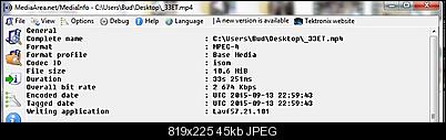

    I'm a total video noob as I work in SEO but I need to change the meta data in a video file so that Google will read a recent date.
    If I inspect the mp4 files with an application I found (MediaInfo) it shows this
    Encoded date : UTC 2011-08-10 22:09:14
    Tagged date : UTC 2011-08-10 22:09:14
    unfortunately the application only reads the data and won't let me change it
    does anyone know of a very simple (and free, if possible) app that can let me update this info without having to re-encode the video files ?
    thanks for any help you can give

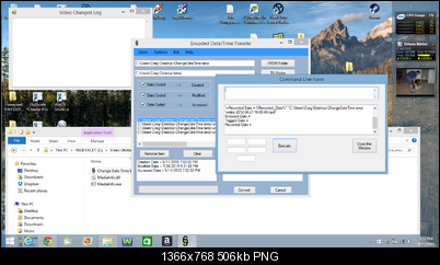

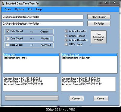

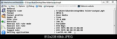

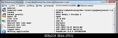

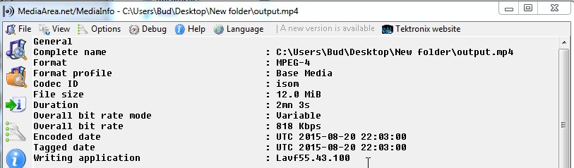

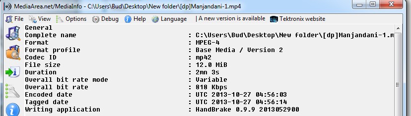

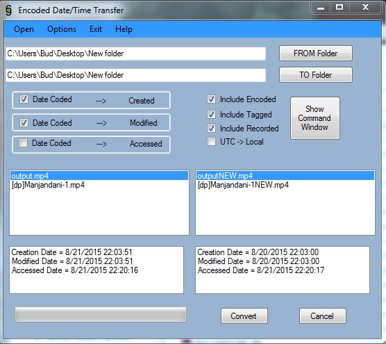

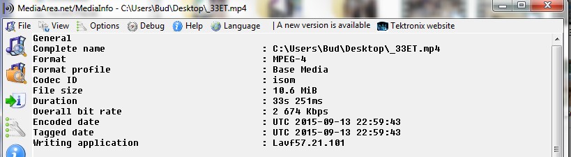

    Just tried it and it copied an mp4 (Manjandani) in seconds to (Output.mp4) with the Encoded and Tagged Date set to yesterdays date as explained in the example above.
Name:	ScreenHunter_160 Aug. 21 22.14.jpg
ID:	33265Click image for larger version
Name:	ScreenHunter_160 Aug. 21 22.13.jpg
    Looks like I'll have to add that to my program that does the reciprocal of changing encoded dates to the created dates.
Name:	ScreenHunter_160 Aug. 21 22.24.jpg

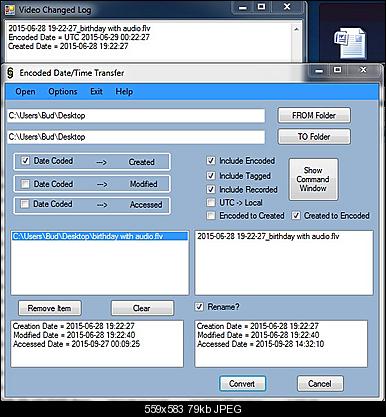

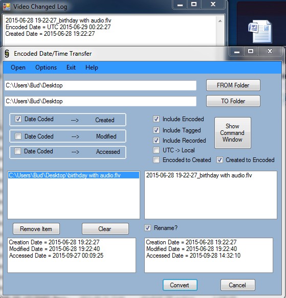

    OOOPS... Please disregard... Wrong thread. This renames files to Encoded/tagged dates and changes rtheir Created/modified dates . It does not change encoded /tagged metadata...will add that function...
    Pumbaa, Okay if you'd like to try the latest...
    Should drag and drop for source folder, and input files as well. Fixed so UTC works especially in my tiome zone that uses Daylight Savings Time.. It adds this name to a duplicate file I create so I don't take chances with originals but use copies anyway, which is always a good practice. I could add a checkmark that renames or doesn't but haven't yet.
    Only known bug now is that if you choose to copy the last accessed time, Microsoft Visual Studios likes to keep the time you changed the others anyway. I don't think anyone needs anyway and if you do there is always 'SetFileDate' and 'SKTimeStamp'.
    The example below shows a sample of running and the results:
Name:	ScreenHunter_164 Sep. 10 21.48.jpg

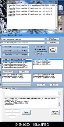

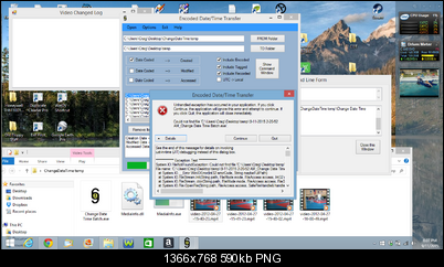

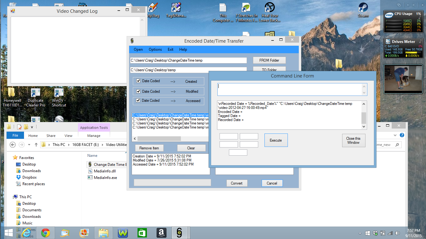

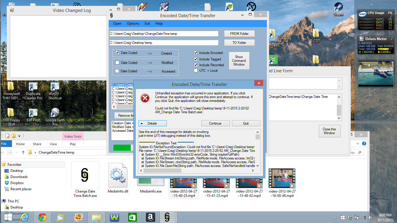

  14. Didn't seem to work, note the video changed log box is empty, and nothing exported to my temp file...
Name:	Screenshot 2015-09-11 19.57.59.png
  15. Okay I put the three files from your zip into my temp folder (where the pictures are) now I get this... it is trying to convert the batch file itself...Click image for larger version
Name:	Screenshot 2015-09-11 20.07.35.png

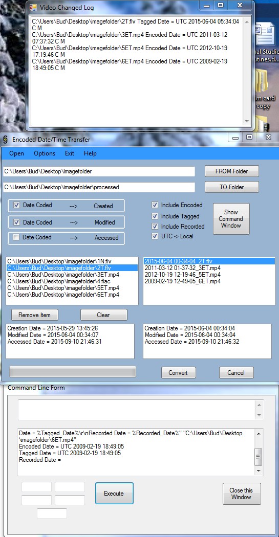

    UPDATE: Link to create encoded from created and created from encoded is:
Name:	ScreenHunter_166 Sep. 28 14.33.jpg

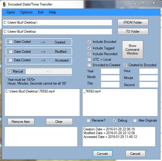

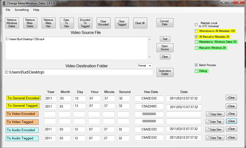

    Update 01-29-2016 Link to new version with manual set and remove function
    If you choose Manual check box and do not enter in any date it will remove the original Encoded/Tagged dates.
    Rough final test so if you find any errors let me know and USE COPIES OF YOU FAVORITE VIDEOS NOT ORIGINAL to test
Name:	ScreenHunter_189 Jan. 29 11.49.jpg
    Last edited by Budman1; 5th Jan 2017 at 23:57. Reason: deleted link. in other thread

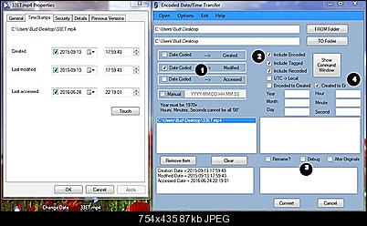

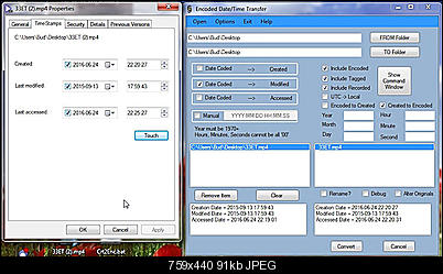

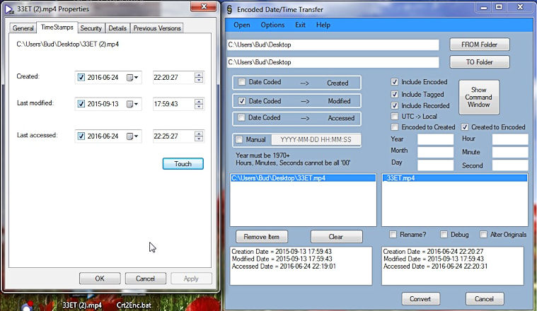

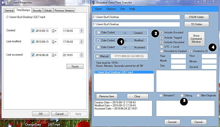

    After downloading the link above to be sure it was correct, I set it up like this and show the encoded before:
ID:	37498Click image for larger version

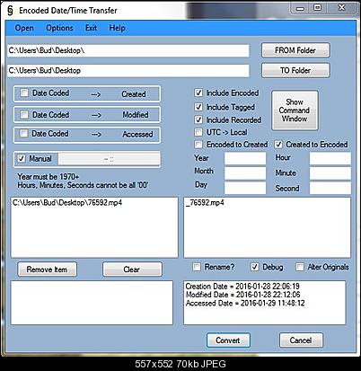

    1. -> means only file modified will be used to set encoded and tagged
    2. -> doesn't really matter except to have them checked since the setting mechanism will change both encoded and tagged
    3. -> debug will not end any CMD screen so don't use unless you want to see what it did DOS wise
    -> Alter original checked will keep same name and alter your Original. DO NOT USE WITHOUT BACKING UP ORIGINALS
    4. -> Created to Encoded checked means thats the way you want to move the dates/ times.

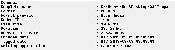

    This was the end result for me:
Name:	MI after.jpg
ID:	37500Click image for larger version
Name:	MI after 2.jpg
    Bear in mind, working with slower storage such as USB drives etc. may cause failures since DOS (since about Windows 7) no longer waits for Windows and will go right thru a routine to set 1,2,3 even if 1 isn't complete. That's about the only bug I know of and it is fixable but not easy because it depends on your PC speed, type of drive, etc. Slowing it down program is is the only choice to make it truly universal and hasn't been incorporated into this utility yet.
    Also realize the time of 17:59:43 on the file is the SAME as the UTC time on and encoded date of 22:59:43 where I live. This is why I added the manual setting for those who wish to 'DINK' with the time to make it the same, which is not accurate because Media Info posts in UTC time.

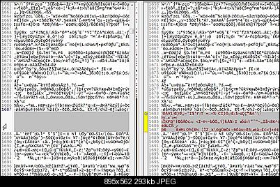

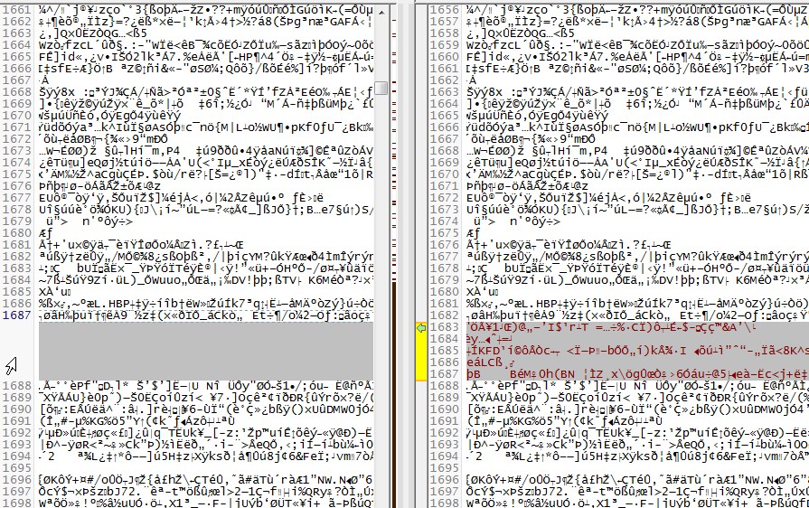

    2. MP4 files can be encoded in a couple ways whether they are copied or not. Most of the time it is just the header information being encoded and/or corrected. Also as I have noted in the posting listed above, if the MP4 has Menus, descriptions, subtitles, etc. They do not copy to the new file. Below is a sample of the same file before and after changing that had descriptions embedded in it

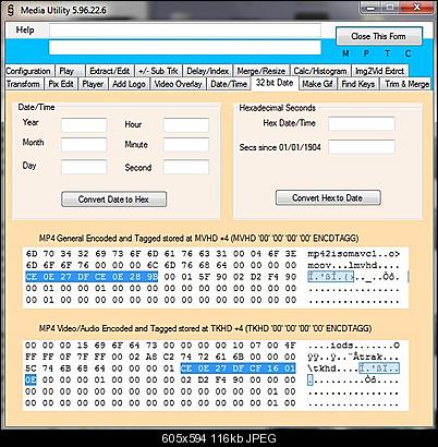

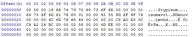

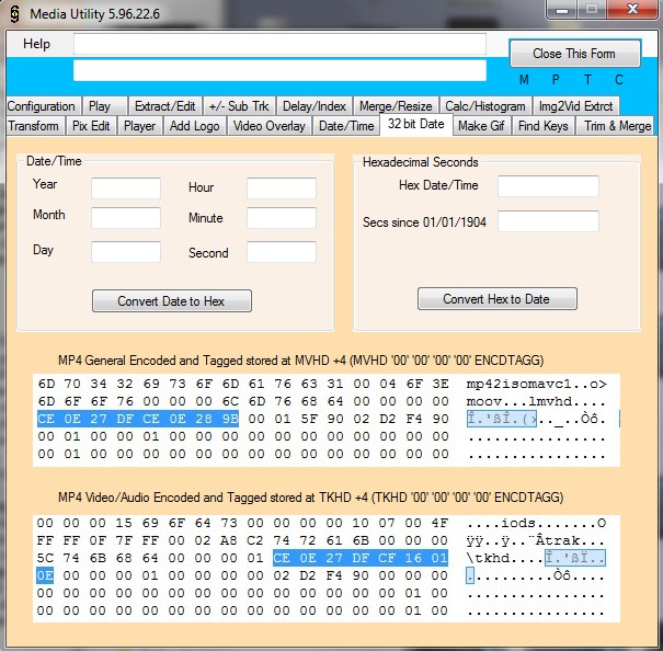

    3. This data is encoded in the MVHD, TKHD and MDHD 'Atoms' of MP4 (mov) type files. it is a 32 bit data repeated for encoded and tagged but can be changed manually for different parts of the video which is not really practical but can be done:

    So if you've detected the location of the (encoded bytes) dates per the spec of MP4, would it be not easier to hexed those by converting new dates to the needed format?
    I am referring to your find of "data is encoded in the MVHD, TKHD and MDHD 'Atoms' of MP4 (mov) type files" which could perhaps be replaced properly by a search-replace loop in compiled code?
    I am sure you've thought of the idea and there must be a reason you didn't follow that path, just my 5c
    But even with different ffmpeg binaries, repacking the MP4 file for just a date-change, shouldn't really result to such bigger difference as I have noticed, no? Just being curious.
    Finally, I checked "Alter originals" to see what happens, and the resulting file was like a portion (in size) not sure what ffmpeg did there. If I repeat it, I will post more info.
    Thanks again for your tool & work!!
    I actually do this of sorts by running MediaInfo and then searching the results for the Phrases 'Encoded Date' and 'Tagged Date'. MediaInfo output is small, But imagine the people (I'm sure they exist) that have a folder full of MP4's that are Gigabytes long and they each have multiple MVHD, TKHD and MDHD fields (and they can). You would be sitting watching a screen while your regular speed computer searched for 4 bytes in a row, incrementing the GB file 1 byte at a time and then re-searching. It was much easier to have FFMPEG just add metadata in a canned method. Bamm! Done. I am rethinking this however since MP4's have so many types of data streams that cannot be copied, each with their own date fields, such as :
    Other #1
    Type : Object description
    Format : System Core
    Codec ID : 2
    Duration : 8 s 40 ms
    Title :
    Language : English
    Encoded date : UTC 2009-02-19 18:49:05
    Tagged date : UTC 2009-02-19 18:49:05
    mdhd_Duration : 1000
    Other #2
    Type : Scene description
    Codec ID : 2
    Language : English
    It depends on how the MP4 is structured because the original may have the extra fields or missing timings or 'null' '00' strings from pauses in capture. There are any number of reasons. The fields I have shown above will NOT be included after you do a metadata change because, as I have mentioned above, no stream copy for data type and a message that tells you.
    [mp4 @ 00f979a0] Codec for stream 0 does not use global headers but container fo
    rmat requires global headers
    [mp4 @ 00f979a0] Codec for stream 1 does not use global headers but container fo
    and
    Data stream encoding not supported yet (only streamcopy)
    Another reason I may rethink method for MP4's if there is enough people need or an ongoing reason for those who need.

  29. Member Budman1's Avatar
    Jul 2012
    NORTHWEST ILLINOIS, USA
    Jagabo's suggested is excellent , as always. Just my two cents of information:
    MediaInfo GENERAL encoded and tagged date are storeed in the MVHD atom of the MOOV atom
    [Attachment 59608 - Click to enlarge]
    'M V H D' 4 bytes long
    xxxxxxxx 4 bytes long (leave as is)
    C9A0D33C 4 bytes in hex of Encoded equal to number of seconds since 1904/01/01 00:00:00 (UTC 2011-03-12 07:37:32)
    C9A224BC 4 bytes in hex of Tagged equal to number of seconds since 1904/01/01 00:00:00 (UTC 2011-03-13 07:37:32)
    MediaInfo VIDEO encoded and tagged date are stored in the 1st TKHD atom of the TRAK atom
    MediaInfo AUDIOencoded and tagged date are stored in the 2nd TKHD atom of the TRAK atom
    [Attachment 59609 - Click to enlarge]
    'T K H D' 4 bytes long
    C9A0D33C 4 bytes in hex of Tagged equal to number of seconds since 1904/01/01 00:00:00 (UTC 2011-03-12 07:37:32)
    These can actually be reset using a hex editor. Currently I am rewriting my Date/Time utility to make the process faster, more user friendly and buttons for single operation or just check a box and convert automatically. It is currently in Beta testing ATM.
    [Attachment 59610 - Click to enlarge]
