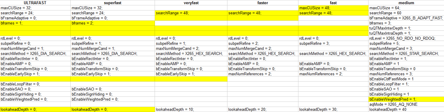

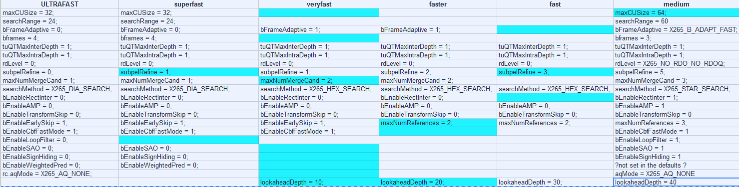

  2. wild guess: --aq-mode X + --rdo Y with X > 0 and Y <2
    btw. current presets are out of sync with the now changed defaults,.. (also attached a purposed fix)
