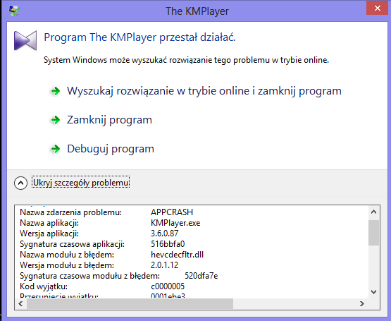

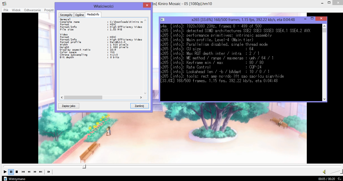

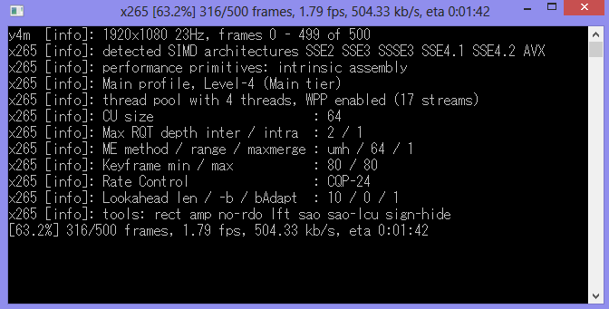

  4. ill just say that for me everything i encode without wpp in any resolution plays in mpc-hc or in kmplayer ( x265's 614 build ), whether i mux to mp4 with mp4box or mkv mux with my gui or raw streams play no problems [ btw suprisingly i had to use mpc muxer as intermediate, because avi wouldn't work with bframes encodes. ]
    i just hope my post won't get ignored, because i have pretty hard time thinking why -wpp crashes everything ( basically i tracked it down to hevcdecfltr.dll ) on my end, im starting to take vhelp's case of 'it just doesn't work for you, get over it' into account
    cmdline w wpp:
    C:...x265.exe --q 24 --keyint 80 --max-merge 1 --me 2 --rect --hash 0 --no-rdo --no-rdoq --tu-intra-depth 1 --tu-inter-depth 2 --no-tskip --no-tskip-fast  --amp  --input "...intermediate.y4m"  --output "... Kiniro Mosaic - 05 [1080p].hm10"
    cmdline w/ wpp is the same just --no-wpp added.
    first&last are the same encode:

    ^ @Jacobr: cf. post #396 from LigH.
    Since the Reference Decoder shows artifacts in the decompressed frames, the problem really must be in x265
    But while the Reference Decoder manages to "translate" the encoding errors as artifacts, the Lentoid Decoder simply crashes the host application.
