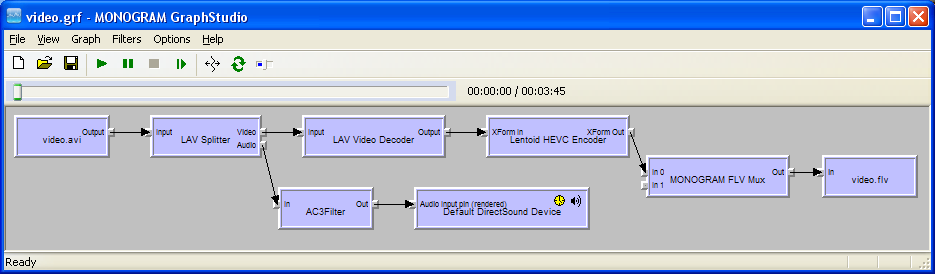

    ok,
    1. use winrar or 7zip to open the "Strongene_Lentoid_HEVC_Encoder_2.0.2.1_2013_07_08 .rar" file.
    2. then, copy the Encoder folder to your hdd. make it simple and put everything in here: c:\hevc
    3. create like this, c:\hevc\Encoder and copy files in step 5
    4. you should see these files in the Encoder folder:
    * HEVCencfilter.dll
    * mmflvmux.ax
    * mmflvmux_COPYING
    * readme.txt
    * reg.bat <-- run this by double-clicking it
    5. run the above reg.bat in a dos console box
    6. finished with installing encoder driver for graphstudio
    note, be sure you install the LAV drivers, post #1 step 2, or the graph (below) may not build.
    7. next, be sure you download graphstudio (gs) (see direct link in post # 1, step 3) because graphedit will close down when you try to open "directshow filters"
    8. run gs and add the following graph filters using the menu\Graph\Insert Filter...
    * file (assinc) navigate to the folder that has the video to encode. can be .avi or .avs script (rgb/yuy2/yv12)
    * LAV Splitter
    * LAV Video Decoder
    * Lentoid Hevc Encoder
    * file writer and give it a filename for the video to encode to, i.e., video.flv
    9. then, right-click on xform_out pin, it should auto-insert -> MONOGRAM FLV Mux -> video.flv completing the connections to all the filters.
    10. now, menu\file\save as graph and give it a name, make it simple, i.e., gs.video.encoder.grf
    11. finished with setting up graphstudio and encoding filters and saving the graph
    12. to begin encoding a video, click on the green triangle and wait.
    tip:
    open taskmgr, because there is no way to know when encoding completes. i open it and select graphstudio. once the encoding is complete, resource for that line will drop to zero.
    the graph should look like this:
    * note, if the audio connection appear in the graph, delete them, since they will slow down the encoding process, plus, the video encode w/out audio.
    now, anytime you want to encode a video, just load up the video.grf or gs.video.encoder.grf (whatever you named your graph) and it should begin encoding. this is for raw video files, i.e, huffy, lagarith, or UT codec avi's. if you want to encode from just one file, (but you can change the filenames of the original sources) then you need to create an avs script and include the filename there. then in the graph, you can replace the video.avi file with something like, video.avs file. then, you can just open the video.grf by double-clicking it and you can begin encoding as many videos as you want without ever rebuilding the graph.
    i hope this works for you.

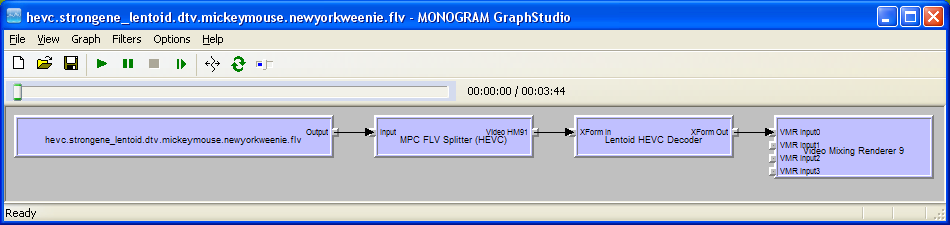

    ok, so once the encoding is complete, you want to play the video.flv file, just drag/drop it into a 2nd graphstudio,
    it will auto-build the filters to the graph.
    if it doesn't, then it is because you did not install the Decode files from post #1 step 1 and/or step 2 the LAV decoders.
    the graph player should look something like this:

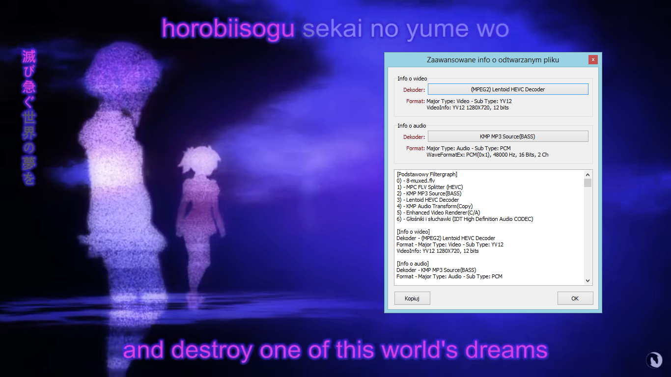

    I've been looking and lurking at threads here and at other similar forums and this would be my very first actual reply, so if i'm talking silly things, let me know!
    I just recently got to know about that lentoid dec/enc for hevc and i wanted to test this new h265 as there is some fuss about it and i got interested how it actually works out.
    So I've followed carefully the steps mentioned, which took me quite the while, also didn't have the codecs or graphstudio or basically anything.
    aaaand.. no it actually works, so no crying here, but I also couldnt really mux the audio in, any kind of.
    I tried and tried and finally gave up, but as I've read that some of you played it with kmp - yup, i turned on the audio thru the add external audio option and it reloaded the vid with matching sound. Nice i guess, but still not quite there, you could easily do that, but you have to every time, so it may get annoying.
    I used the mkv container as source as i couldnt really do anything with avs, if anyone can get me through how to set this up, itd be awesome.
    i just couldnt connect the pin from avs source and i would want to do it this way, maybe to set up some subs hardcoding right in avs.
    As for vid, i tested it with anime ending, i wanted to know how it will handle this kind of source, also with very dark and kinda unchanging image throughout the vid. original filesize (with audio ) was like 37.4 mb and flv with hevc is ~12mb.
    i think it lost some detail and colors but this is quite the size difference. i may up the original h264 & audio if any1 cares ( expecting - no one )
    woa, what a wall o text for first post
    http://speedy.sh/k9zk3/8-muxed.flv

    no, there is no avs scripting available in graphedit/graphstudio with the strongene lentoid hevc encoder, only raw video, such as YUV420P and certain uncompressed/lossless .avi's. so you can't use an avs script insteadl. i've tried to no avail to get it to work, but it just will not link up with LAV nor FFDShow video filters. i've also tried to figure out [AV_Splitter] filter in graphXYZ but the same results. either way, nothing will connect unless it was designed for it--the strongene lentoid--period. yeah, yeah, you can open an avs script inside any garphXYZ and it will play and other things, but not link up to the strongene lentoid hevc encoder. i've tried for more than two days straight, 14 hours ore more on it. this one's a dead hourse. and i'm all pooped out in beating on it if you know what i mean. lets wait until someone more savy in graph connection setups stumbles by these discusions and supply us with the solutions. so until then, i give up

    i agree, everyting is a pain. anyway. the connection you have posted above is one i was trying to do also, but [video.avs] -> [avi decompressor] would not connect, and still doesn't. maybe that is my problem...that some of these types of connections don't work on my machine, but do, on others!
