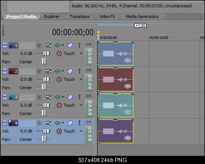

  26. aBigMeanie aedipuss's Avatar
    Oct 2005
    666th portal
    the smrpix is correct. you'd need vegas pro to import the 24bit wav. it uses the 24bit 96khtz samples fine.
  27. I can import them into Vegas Movie Studio as 24 bit individual wavs, which I have been doing. Just not import 24 bit multichannel wavs. It will render in 16 bit though.
    Is that what you meant, can't import 24 bit multichannel?
