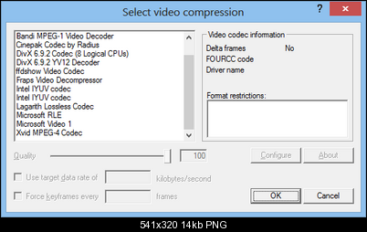

Results 1 to 26 of 26

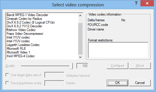

  1. I tried vdub 32bit and vfw 32bit and vdub 64bit and vfw 64bit, ffdshow even appears as compression option(for vdub x86), but no x264 whatsoever.
    I am using windows 8 professional.

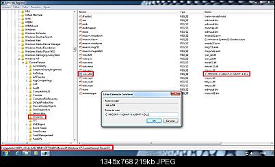

  11. Lone soldier Cauptain's Avatar
    Jan 2006
    Brazil
    Hi GradationAir,

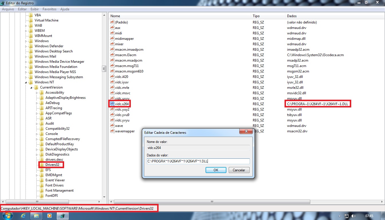

    Download this version: http://komisar.gin.by/old/2273/x264vfw.2273kMod.x86_64.exe
    Install in default directory: C:\Program Files\x264vfw64\
    Open RUN, type regedit and tap ENTER
    Find the local in photo and config like:
    If not exist key, make this, name it and load default path (C:\PROGRA~1\X264VF~1\X264VF~1.DLL).
    Close Regedit, open Virtualdub and check.
    Claudio

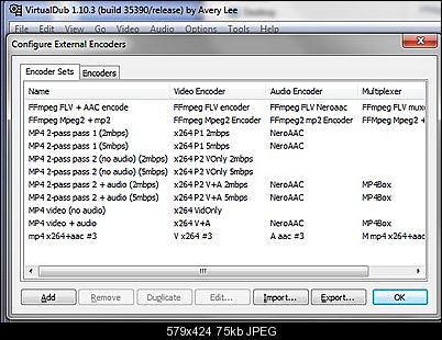

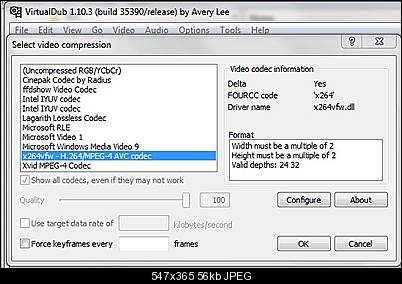

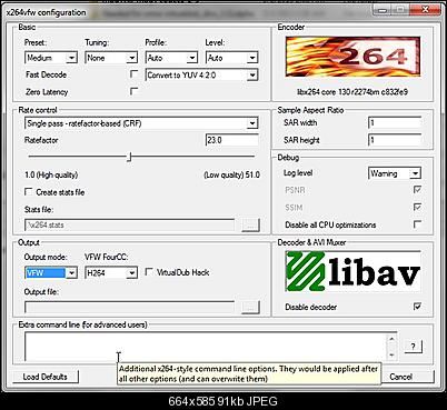

  12. Member Budman1's Avatar
    Jul 2012
    NORTHWEST ILLINOIS, USA

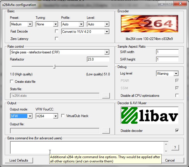

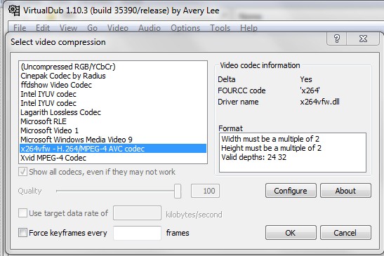

    I have x264 installed as part of K-lite but if any x264 VFW is installed you should have a start menu X264 configuration item:
    Name:  ScreenHunter_08 May. 30 11.12.jpg
    This will let you configure the codec. Mine looks likes this and works: check your settings.
Name:	ScreenHunter_08 May. 30 11.08.jpg
    My codecs were are not listed in the registry as above and still work. Careful with changing registry entries unless necessary.
    The actual codec is x264vfw.dll as noted below and shown in Virtualdub. Make sure it is installed and registered.
Name:	ScreenHunter_08 May. 30 10.46.jpg
    There are also several threads on the internet that mention uninstalling Virtualdub and codec packs and doing a fresh install. The latest x264VFW used in K-lite Mega pack is revision 2274. I am not advocating installing the mega pack but only as a reference to the latest commercially used version of x264VFW. This can be found at http://sourceforge.net/projects/x264vfw/. This file is an EXE file, I believe, and should be run as Administrator.
    You can also encode with VirtualDub Beta versions 1.10.3+ versions with external encoders. This is simple and I have a script to import that has MP4, FLV, and Mpeg2 already set up. If you need this please PM me and I can send instructions.
Name:	ScreenHunter_08 May. 30 11.40.jpg
    [Attachment 18100 - Click to enlarge]
    Note for anyone interested: If you ever find you cannot run installs such as right clicking an INF file as administrator, I find it easier to just log out and back in as the actual user administrator and run it again. Yes, there are other tricks to install them but they do not always work in Windows 7.

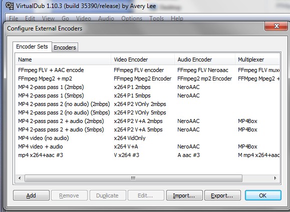

    I think what Budman was trying to say was with the newer versions of Virtualdub with the external encoder feature, there is no reason to even use x264vfw. Putting x264 in an avi container isn't the right way to go, especially if you can create an x264 mp4 or mkv with the same program using the x264 command line encoder.
    There are guides on the Virtualdub forum showing step by step instructions on how to use the feature and a few Virtualdub users here who are willing to help. I know people rag on XP users for refusing to use Windows 7 or 8 but those same people have been using Virtualdub for years and refuse to learn all the features that this program has to offer.

    Nobody is attacking you. Just pointing out (as Budman was) that there is another option to achieve x264 in Virtualdub and that Budman, myself and many others are willing to help if you want to learn how to use the external encoder feature. At one time, x264vfw was the only way to achieve this but now there is a better option.
    The external encoder feature has been out in a stable release (1.9.11) since December 2010. If you google, you can find a download with all the plugins already in the plugins folder. Budman's 1.10.3 with up to date plugins and his encoder sets already in a vdprof file might be better though.
