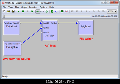

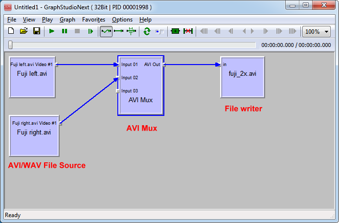

  6. I think this GraphStudio (or GraphEdit) graph will work:
    1) Start GraphStudio.
    2) Select Graph -> Insert Filter...
    3) Add two instances of AVI/WAV File Source (it will ask for the file names for each).
    4) Add Avi Mux.
    5) Add File Writer (it will ask for a file name, be sure to include the .AVI extension).
    6) Connect all the output/input pins as show by click-drag-drop from output to input pins.
    7) Press the Play button.
  7. Member Cornucopia's Avatar
    That OUGHT to work fine.
    However, I have seen on other sites where something similar to this did NOT get it working.
    If it doesn't work with this, I believe it might have to do with some Fuji-specific metadata that needs to be included at a certain point. I do know that the Stream Name/Title chunk of the video streams needs to say "FUJIFILM AVI STREAM 0200" (exactly as written, case-sensitive). That is for the W3. I don't have the W1, but am guessing their's might say "FUJIFILM AVI STREAM 0100"?
    Oh, and it always seems to be muxed so that (L) video stream is Stream ID#0, then audio is Stream ID#1, then (R) video stream is Stream ID#2. Plus the "AVIF_WAS_CAPTUREFILE" flag is used.
